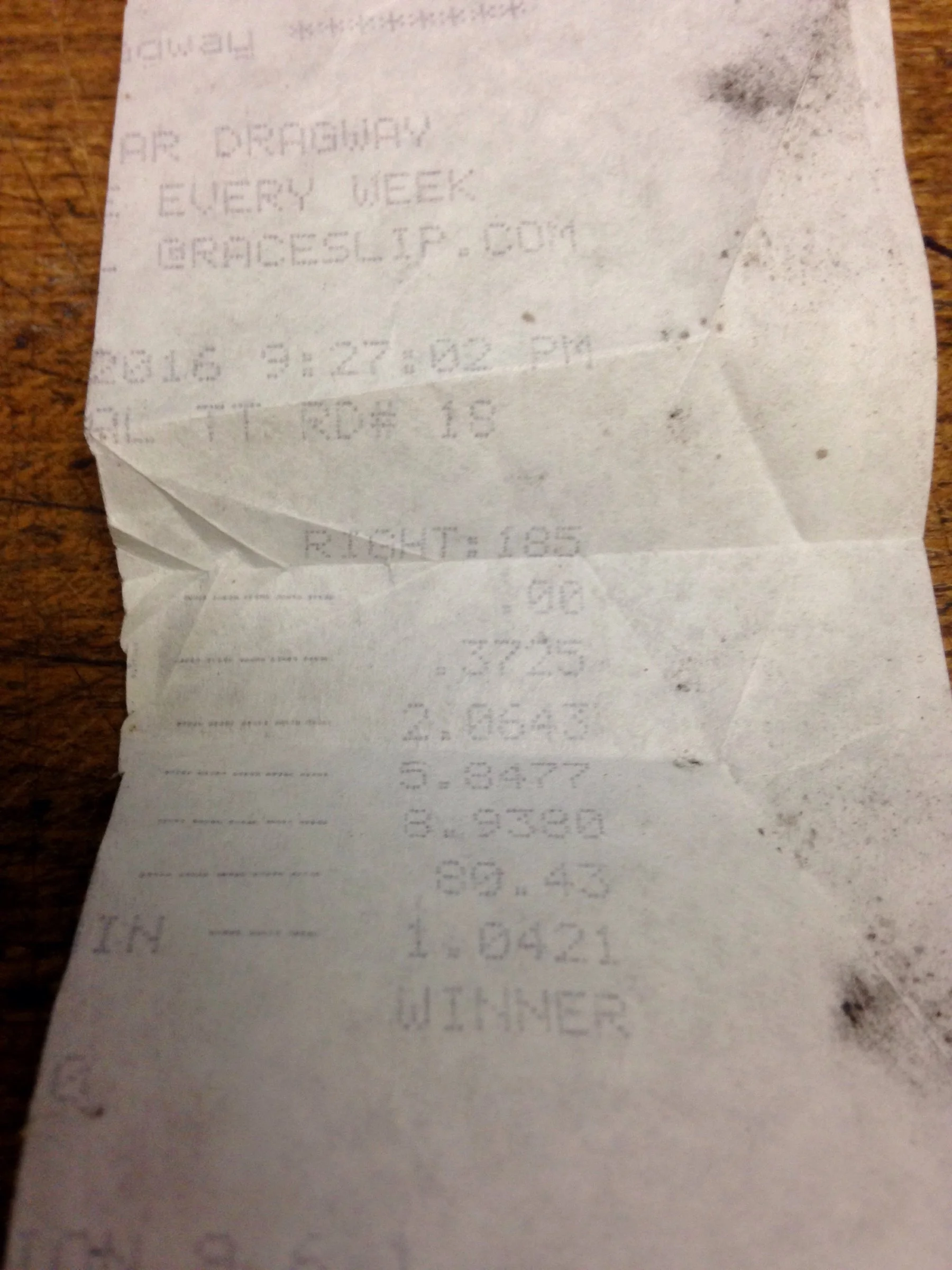

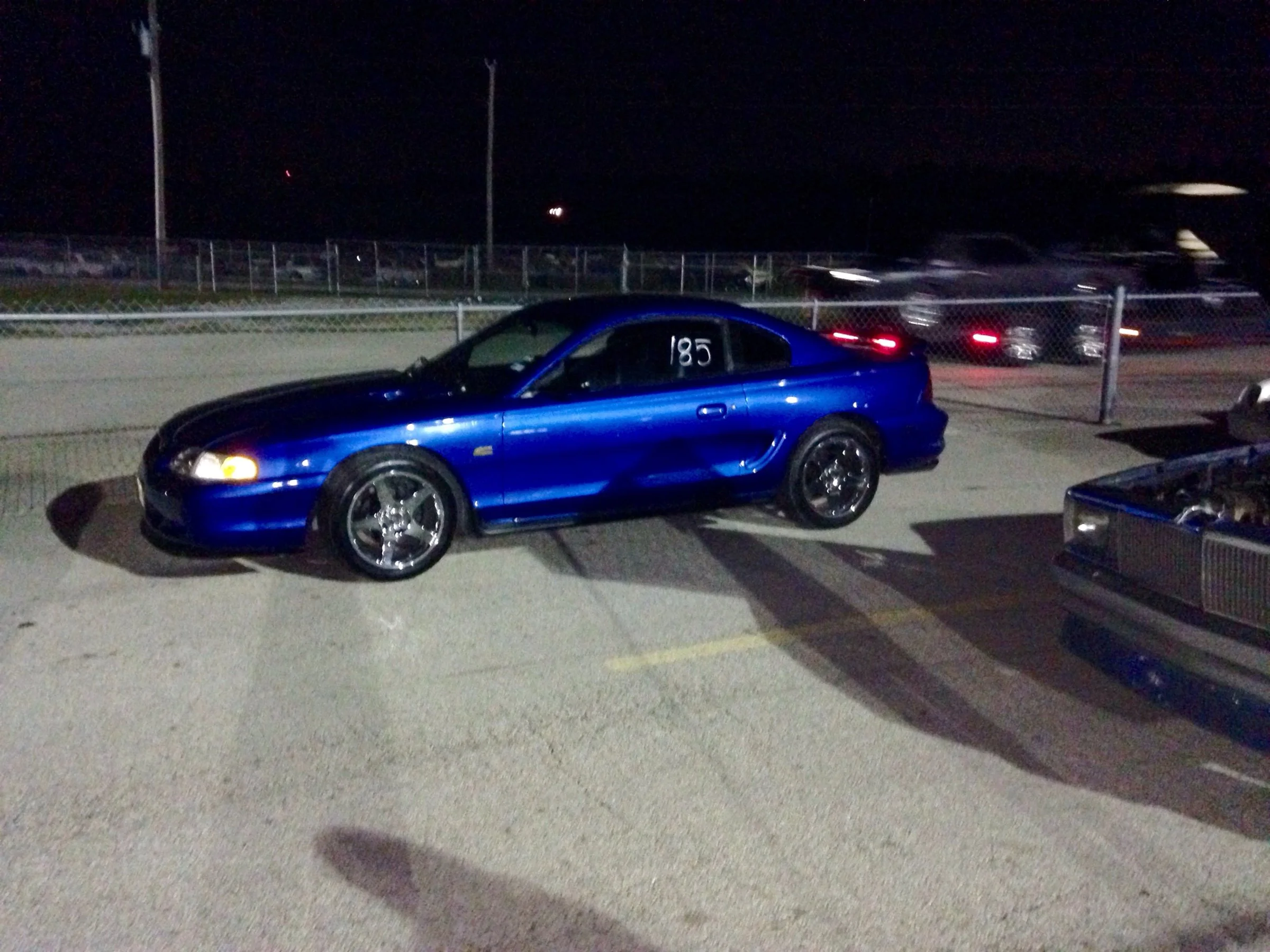

Hard to see but it's 2.064 60' and an 8.938 1/8 @ 80 mph. I need the "driver mod," but this is my best run thus far. The initial launch was fair, but I had to lift in second a little because it started getting squirly. But once I finally got tradition it took off. There was a newer v6 camaro in the other lane. He got ahead of me when I lifted but I was able to pass him again.
I have some control arms I'm gonna put on in a couple weeks, maybe they'll help some. On some of the passes my launch sucked so bad I just idled down and coasted through the beams.

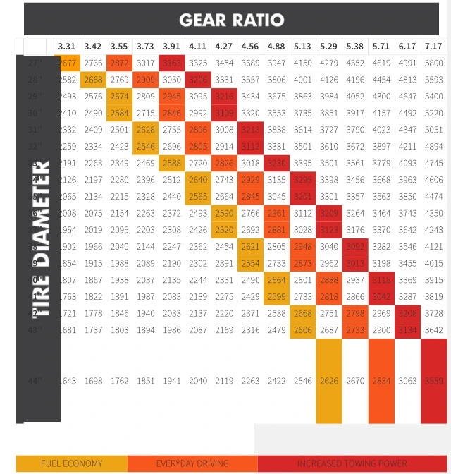

This graph might help ya when it comes to sizing some drag radials to mate up with your gear set
Kinda generic as far as graphs go,but still somewhat useful info lol

An 8.93 in the 1/8 translates into a 14 sec 1/4? I'd like to try the 1/4 but there isn't one close. I think I'd do a little better since it seems like pulls pretty hard in 4th.

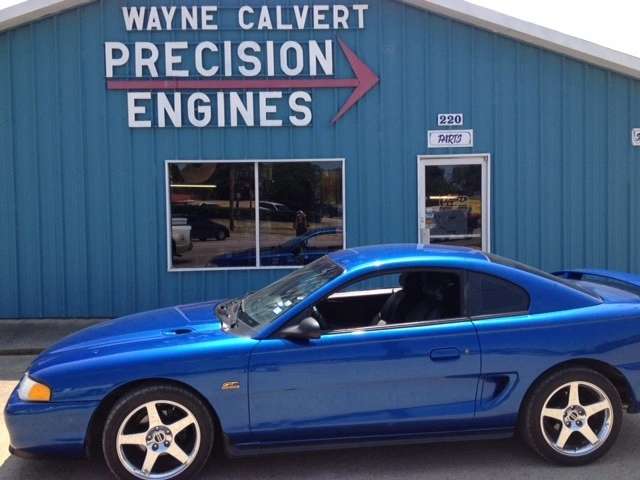

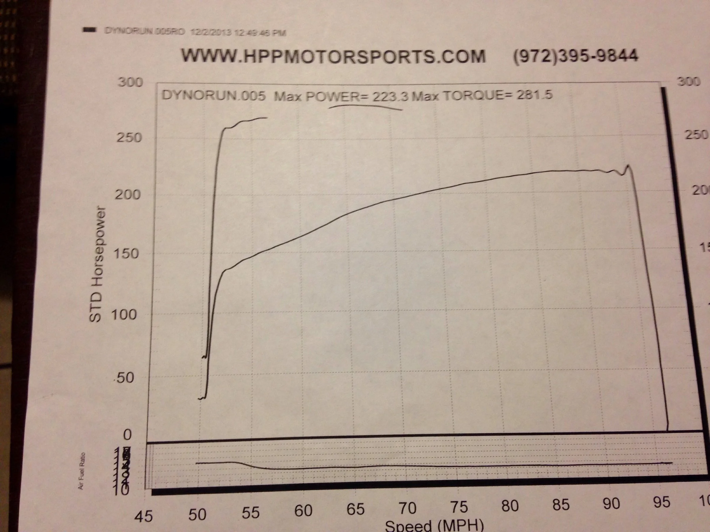

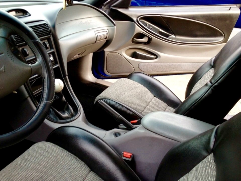

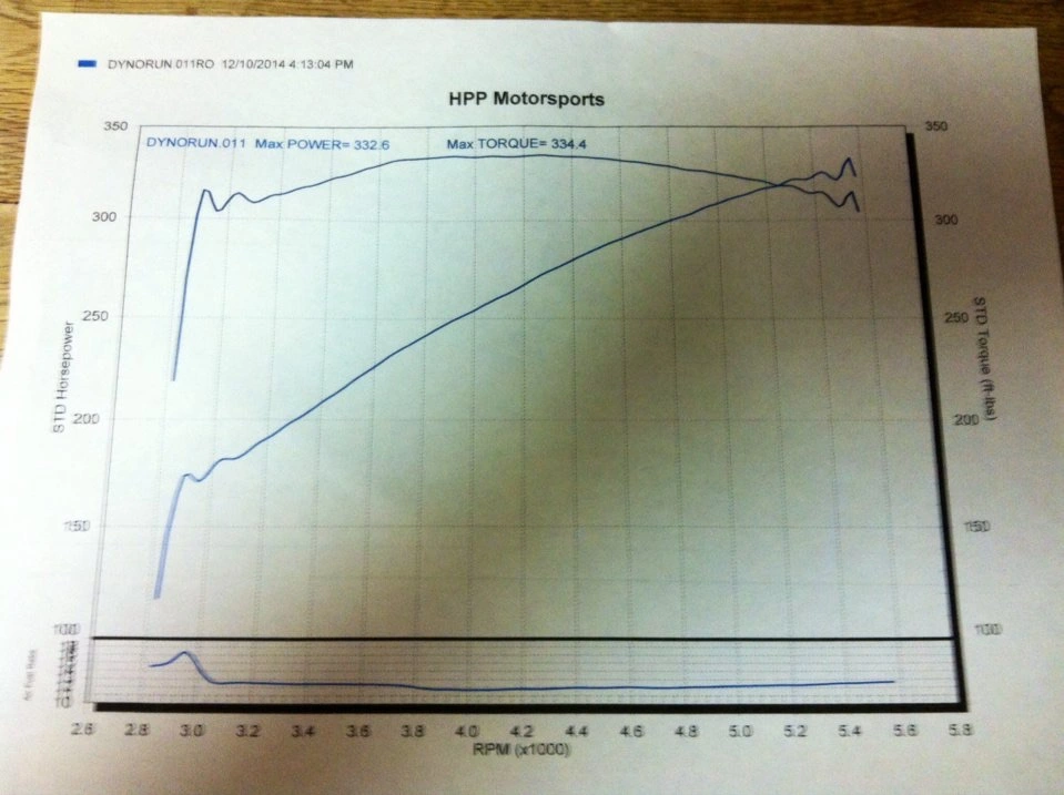

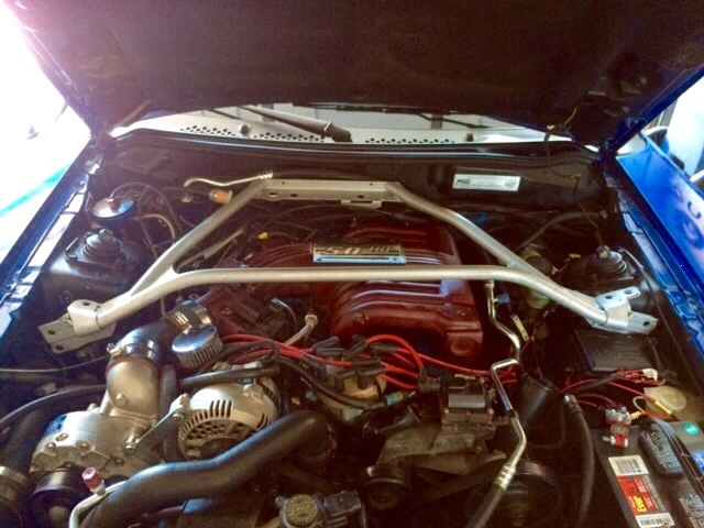

Here are my before and after blower dynos as well as some eye candy for y'all gents. I sold my fox and bough a vortech.

And before you say it, no the strut tower brace is not bolted down. I had it off to paint it and I just set it up there to take a pic. And yes, that is a Walmart battery.

Thanks man. It'll never be a hardcore track car. It's just a pretty day cruiser that might go to a test n tune once or twice a year. The a/c is ice cold and cruise control works. If one day I have some extra money I think I might go to a 3.27/3.31 rear end. The 3.73's get irritating on the highway after too long.
