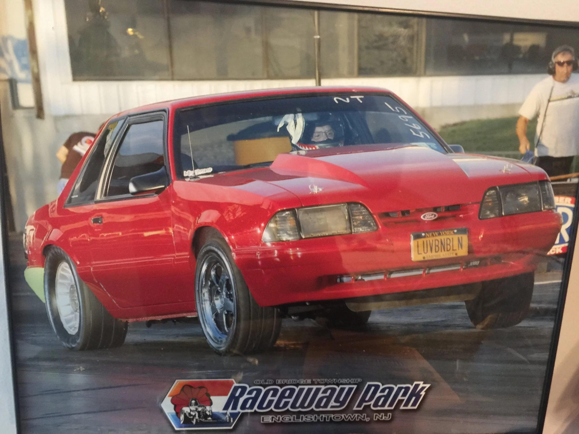

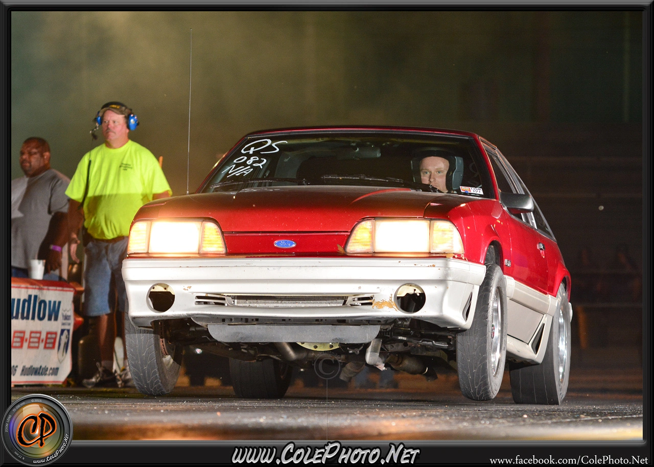

i had hoosier radials on it... then a hoosier bias ply... now mickey pro radials...
it will never have anything other than a radial on it
You can make radials work . And I recommend that for a primarily used street car . Skimming that 17inch rim....
34xx with me in it .
