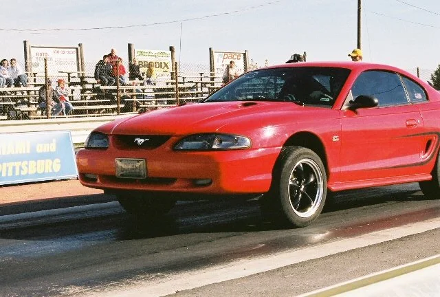

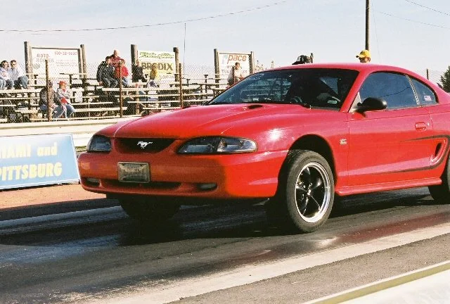

This pic was with the stock engine and the 125 shot once I got moving and on nitto DRs, but you can see they do pretty good from a dead stop. I pulled a 1.86 with my auto. The photo is most likely BEFORE the nitrous hit.

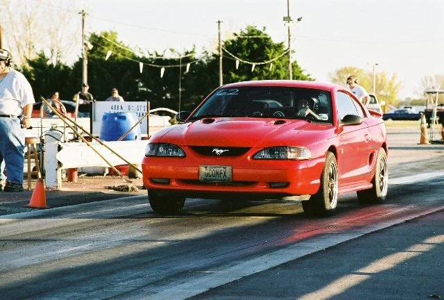

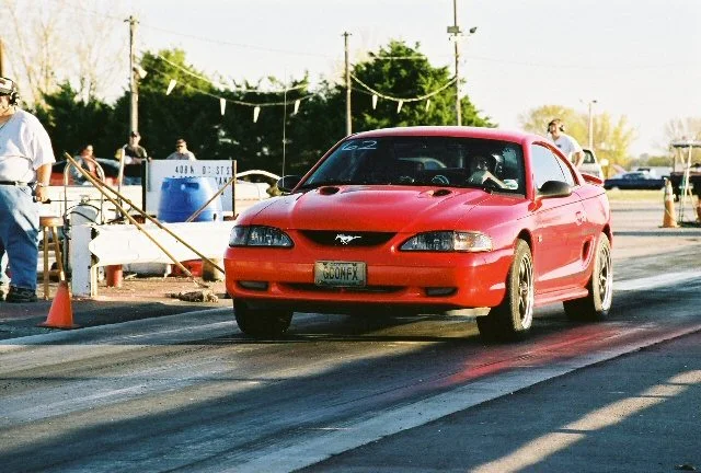

anybody have pics of there cars with the springs installed so i can see the ride height?
Here's me in my goofy helmet. Oh, and stock height is about right. The front will start a little higher. Like a 1/2", but mine has settled back down since the install. You MUST use a spring compressor to put them in. They are taller than the old stock "settled" springs when they are new.
