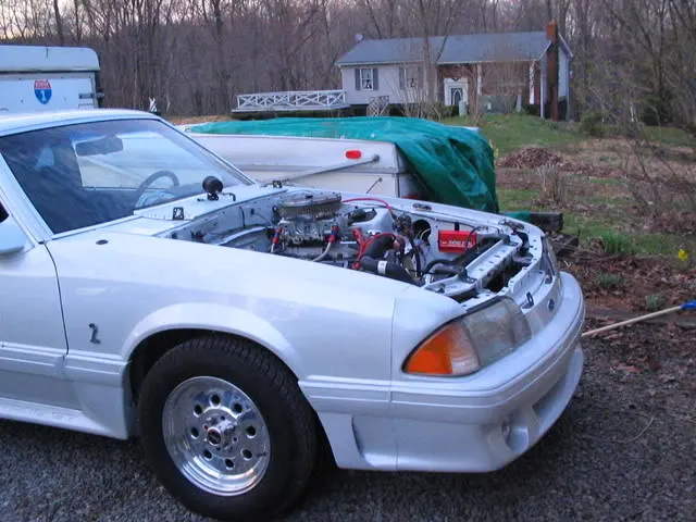

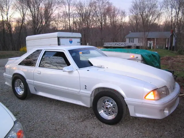

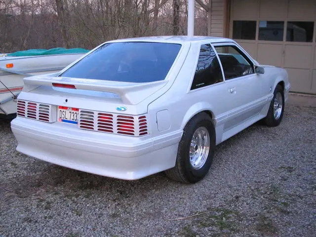

here is my old 92. 15x4 on the front and 15x8 with 5.5 back space on the back. 275/60 nittos.

Looks good Scameron! i like it, are you using a 1/4 inch spacer on the back?
