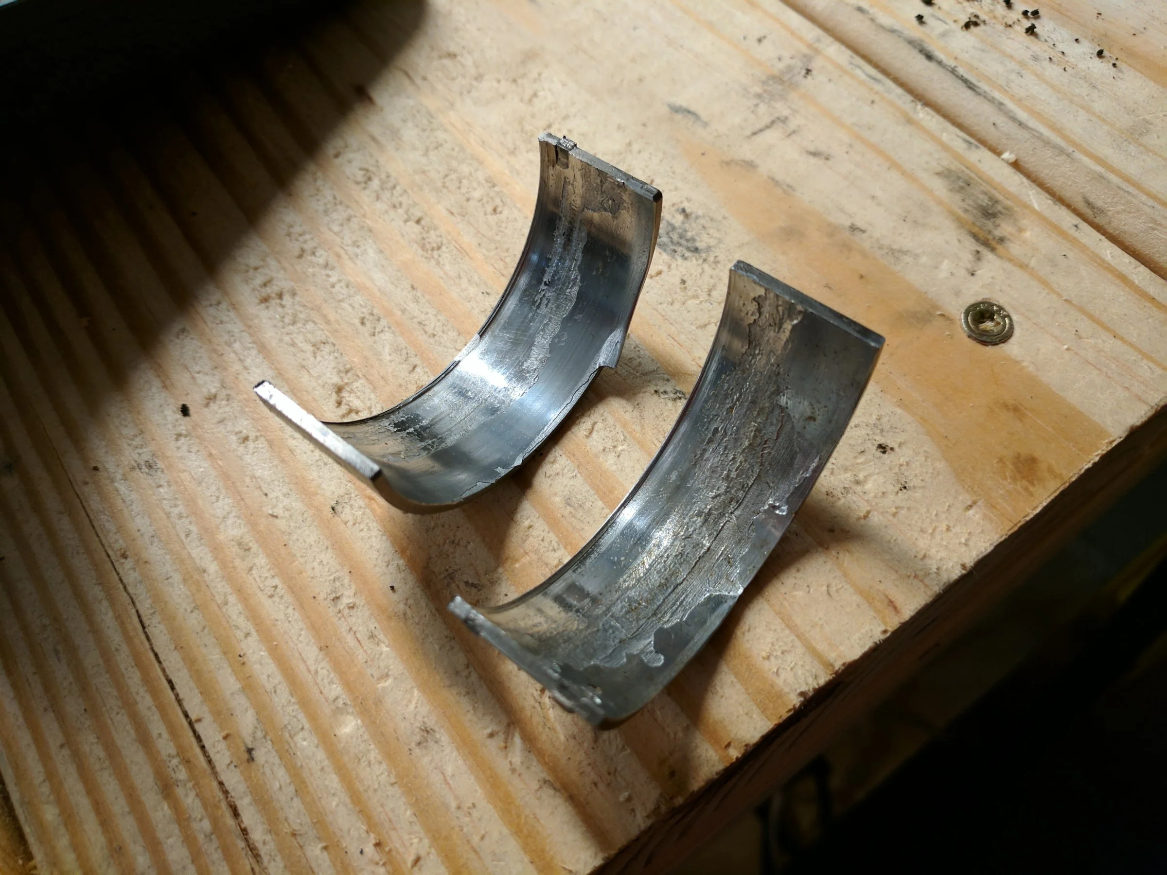

Picture of the blown bearing.

Wonder what caused just one bearing to self destruct and where did the metal go???
I'm sure it ended up in the oil pan but I changed the oil twice right after getting back from the trip it failed on.
This does make me wonder if the bearing just failed or if the cylinder did, at some point (or multiple points). It might be worth doing a cylinder balance test and compression check leak down check. If the injectors are original, they could probably use cleaning and flow testing.

Noobz347 said:
Welcome aboard and great write-up.
Thanks! I think the bearing just failed. I never lost any power or consumed large amounts of oil that would be indicitive of a bad cylinder. Only thing it ever did was tick LOUDLY until it began to knock. Now that it's running great again I don't want to touch it until I have to.
