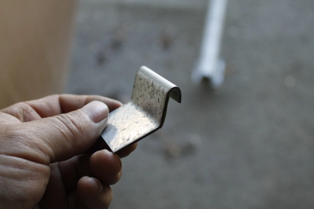

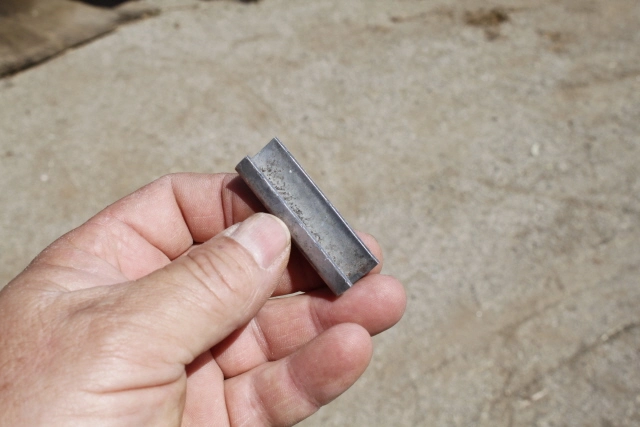

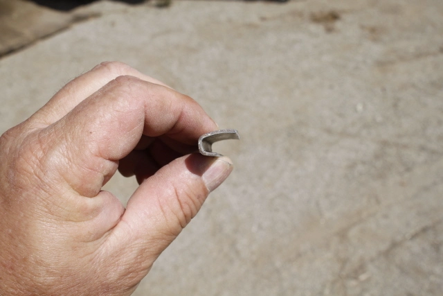

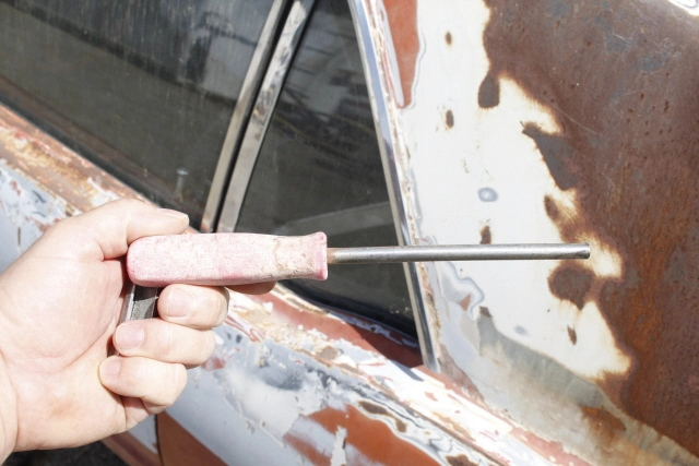

I had some 16 Gauge that was a 1 1/2 inches wide .i cut a piece and a few bends later i had the jaw to remove the molding .

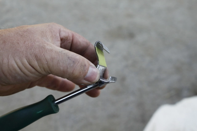

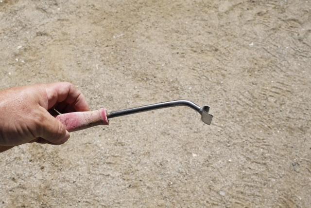

I had an old screw driver and cut the tip off and welded the jaw to the end . I had to put a 45 * bend in the screw driver to clear the door and the quarter .
Reactions: RaggedGT and 2Blue2

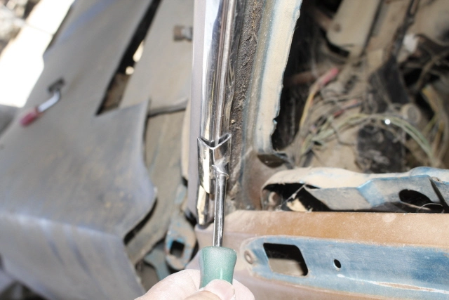

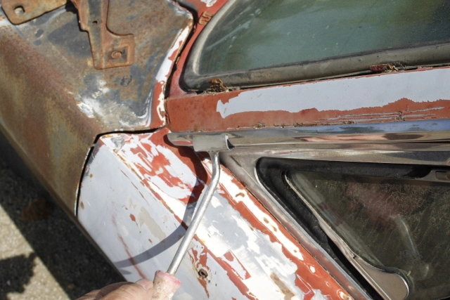

It worked perfect ,although my molding was all bent up my tool didn't ad any dents or scratches and the molding came off very easily .I tried a 67 fast back and it came off with out a mark on it .I also tried a 78 ford pick up ,it has the same type molding but it is made of aluminum ,it came off with out a mark . I think i will glue some vinyl on the inside of the upper jaw just to make sure it will not scratch the moldings . Total Cost ...25 minutes .

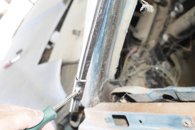

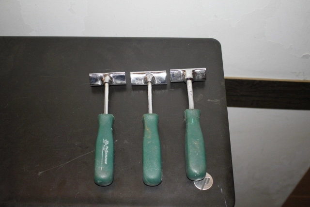

HAHA , I already have a tool maker looking at them .I sold one already and maybe two more for $20.each I deleted my pics of the 69-70 tool ,it is a bit different than the 65 -68 .I will have to see if i can get more pics . I tested both tools on my cars and i probably had the molding on and off my 69 fast back 30 times with out a mark on it .

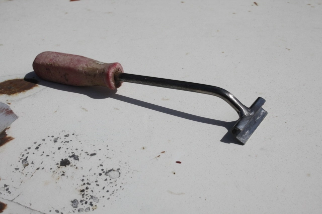

The tool for the 69-70
I just hooks under the lip of the molding and flips it loose .

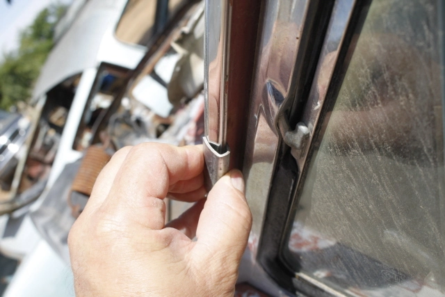

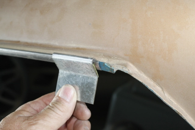

I even made something to install the molding .It is just a tab that hooks onto the back of the rain gutter and when you press down it locks on the molding .I am planning on making this into the removal tool so it will be a two in one tool ,a remover and install tool .
