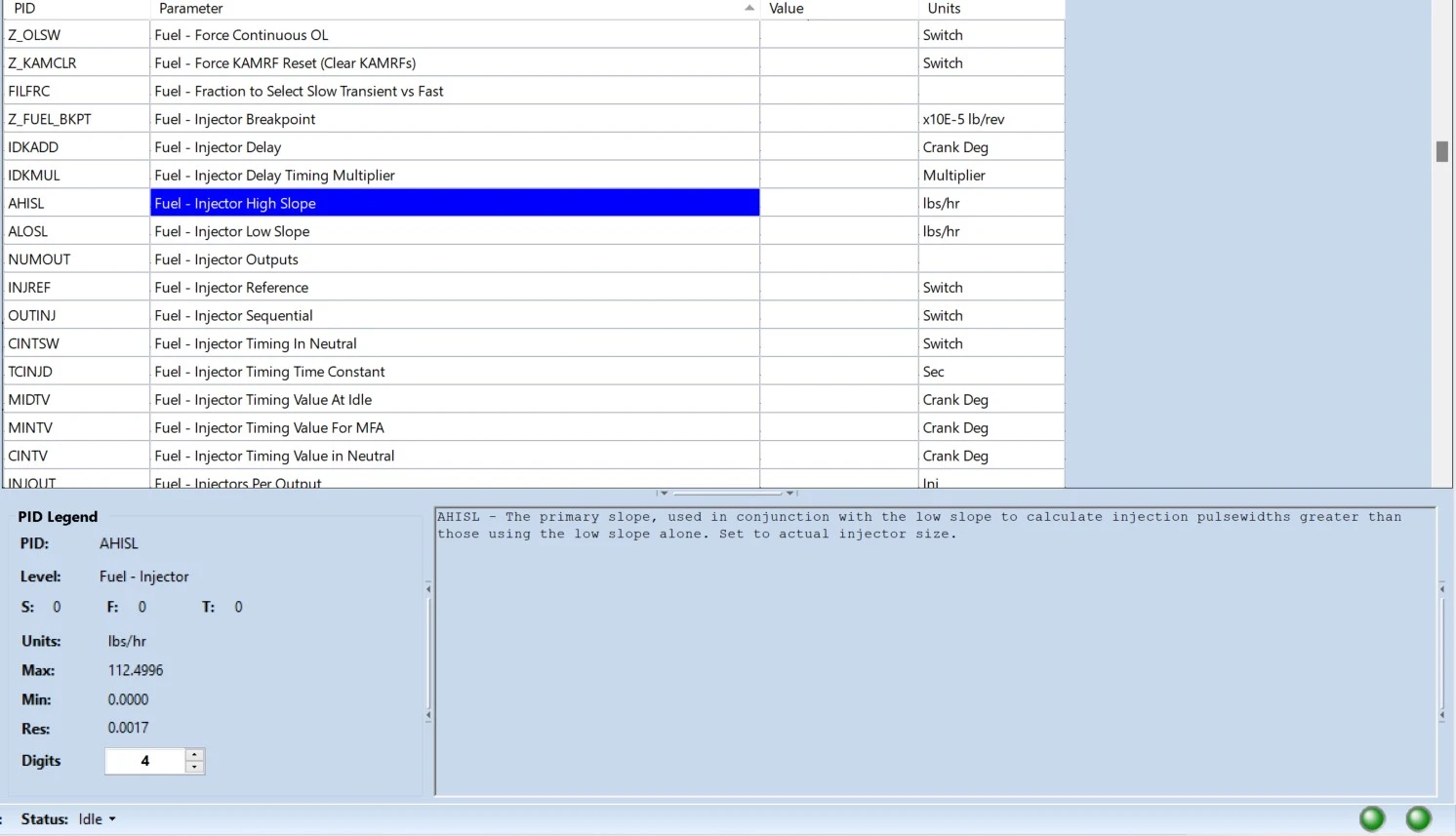

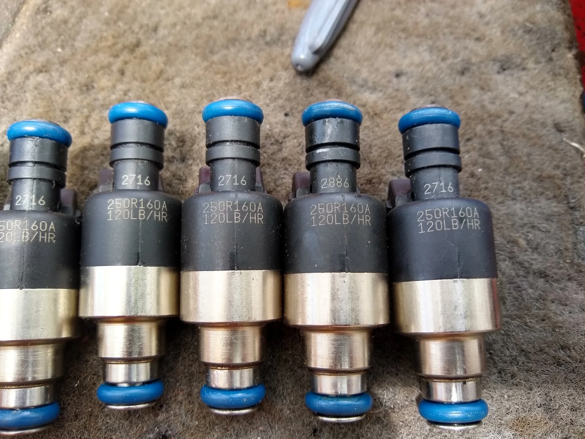

Where did you get this info? This is a very mildly modded setup, 19#s will run that all day long.As I read the rundown of the engine build I see some inconsistencies....First are the injectors Second is the fuel pressure.
A B303 camshaft if Im not mistaken takes a 24 lb injector minimal and even if you boosted the fuel pressure to say 47lbs to increase duty cycle it still wont run right ..

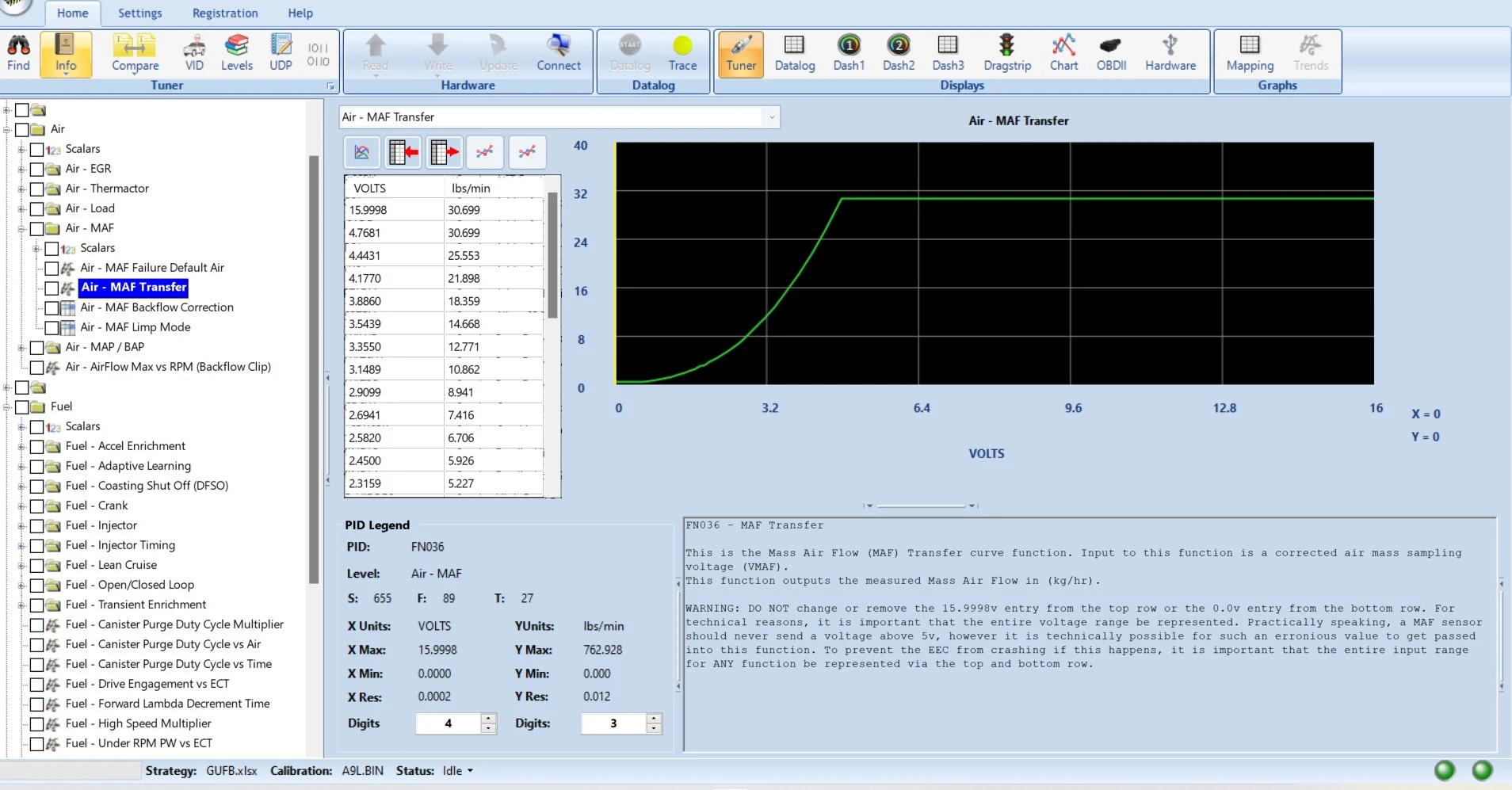

You'll also need like a 76mm MAF and then have that MAF profile transferred in......
For your setup Id have no smaller than 30lb injectors w/340lph pump and have a Kirkey Adjusable Fuel Pressure regulator along with 76mm MAF.
After matching it all up youre gonna need someone to change the parameters in the ECU to match...especially the TPS, spark and fuel parameters.........
Good Luck
Its KNOWN FORD INFO....Look up B303 Camshaft recommendations and it says 24lb injectors....19's wont flow enough and besides if the flow exceeds the MAFs transfer settings it will go into limp mode everytime it does.....,Where did you get this info? This is a very mildly modded setup, 19#s will run that all day long.

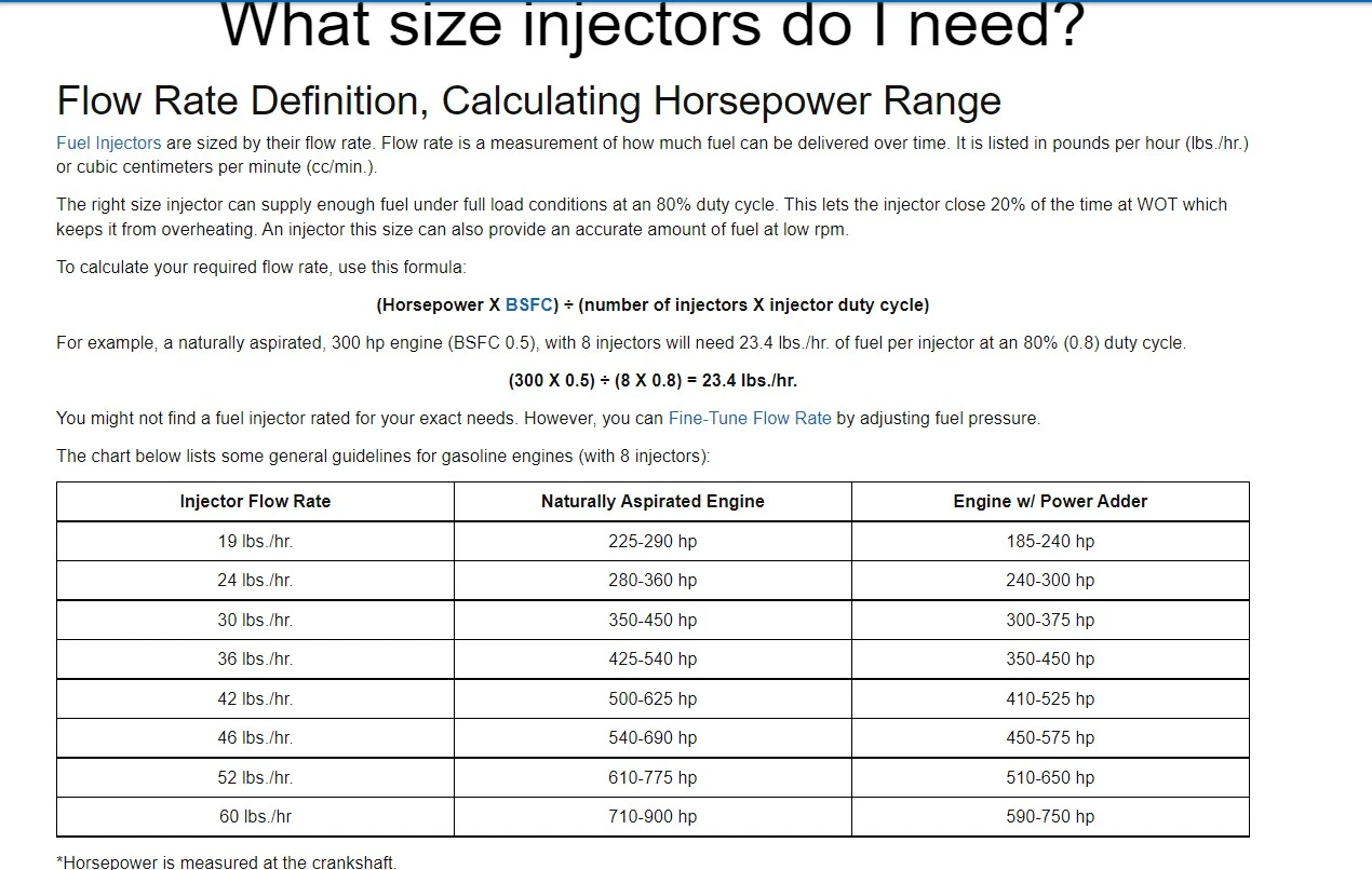

Theres also info all over the info regarding crank hp to injector size like this chart they have at Summit.Its KNOWN FORD INFO....Look up B303 Camshaft recommendations and it says 24lb injectors....19's wont flow enough and besides if the flow exceeds the MAFs transfer settings it will go into limp mode everytime it does.....,

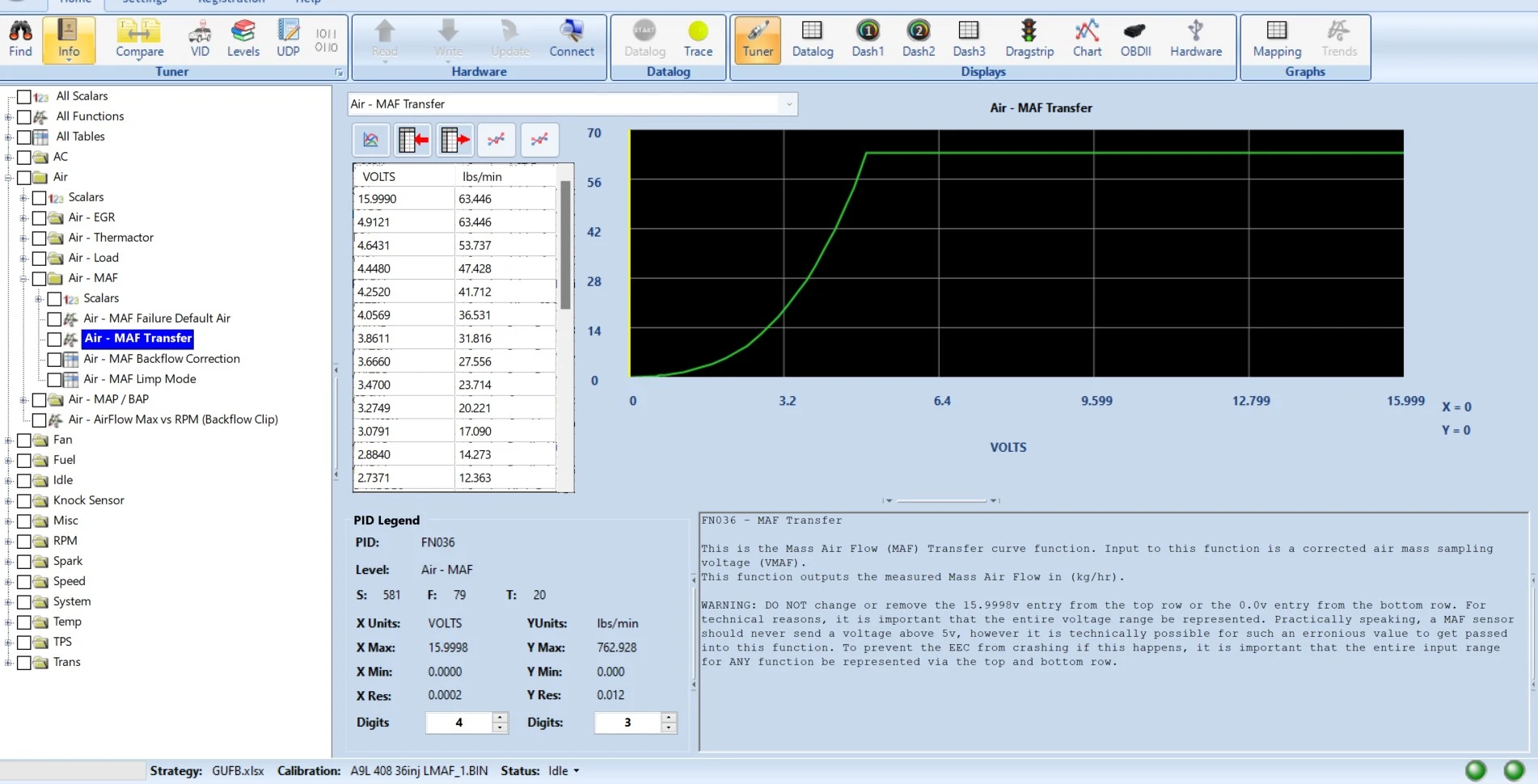

Im running a .477/.493 camshaft specs and I have to run 36lb injectors minimal in my 408 and it doesnt spin higher than 5500rpm's and is built for brutal torque....a b303 cam is bigger....LOL
Im not green to tuning..........
Agreed. At 5500 rpm your 408 is moving 649 cfm of air and needs an appropriate amount of fuel. The OPs 306 at the same 5500 rpm is only moving 487 cfm, much less fuel required. Your 408 pulls 33% more air and thus will need 33% more fuel.It’s a 306. It’s not moving anywhere near the amount of air your 408 is moving so the fuel requirements are going to be much less.
