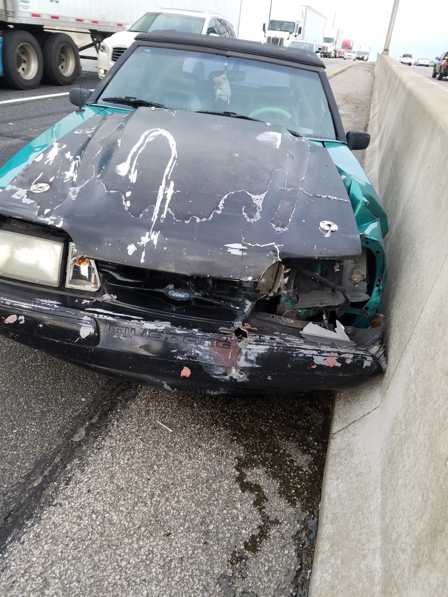

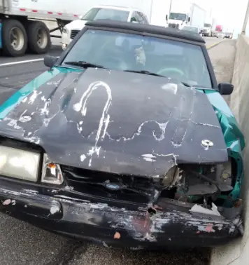

Everybody's ok. Other 2 cars were completely fine. Just scratched bumpers.
Got onto the interstate. Left 2 lanes were moving just fine.
I merged into the far left lane, was about 6 car lengths behind the car in front of me. He put on his brakes, then laid into them. I got on my brakes hard and started to dive left onto the shoulder, but he was doing the exact same thing.
I knew I was gonna hit, so I tried to cut to the right and avoid him. Couldn't be done. Probably hit him around 30/40 mph.
It's completely hosed. Basically, everything forward of the firewall, frame and all, would need to be replaced to get it fixed.
It really sucks. I love this car so much. Thankfully, it's nothing that can't be replaced and I'll eventually find a hardtop that I love next spring.
Trying to get my truck put back together in the next couple days so that I have something to drive.
