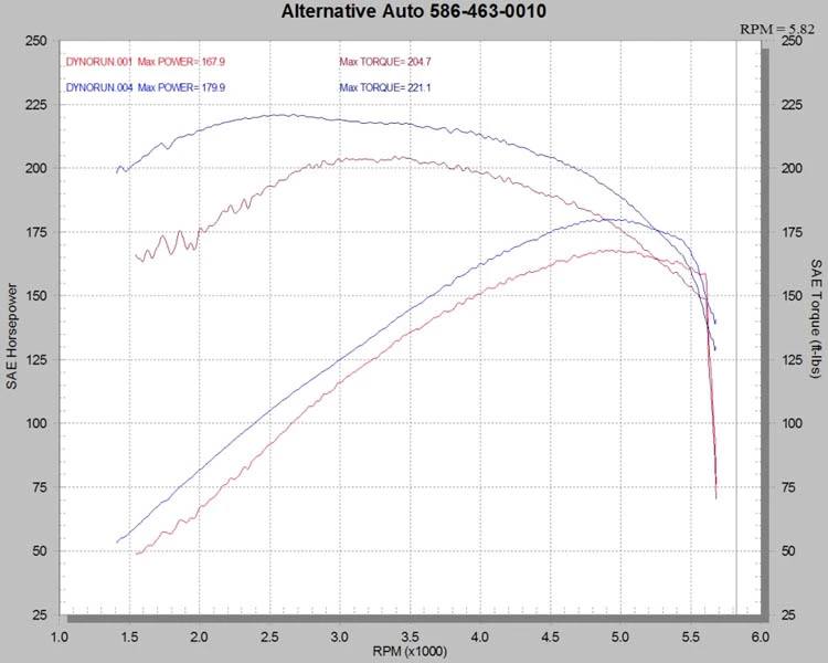

We got a 06 Mustang V6 yesterday and I noticed the bad lag in power on take off too. After it gets going the power is pretty darn good though. If I buy the Predator or SCT tuner does the custom tune it needs to get rid of this lag come with it already? I have never used one of those tuners before and I was wondering how easy it is to use. If it's easy I will pick one up.
If I can just get rid of that lag then it will be almost perfect :)
X-Cal2 will cure your lag problem... It's incredibly easy to use... Plug it into your ODB -II port underneath the steering wheel and following the instructions on the little LCD screen... it will also improve your shifting...
Alternative Auto (www.alternativeauto.com) has a before and after dyno graph of a V6 automatic... you can see the dramatic increase in Torque! (The lag is caused by the computer controlled torque limiters... )
Here's the graph:
