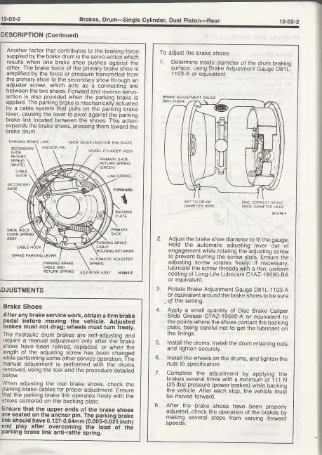

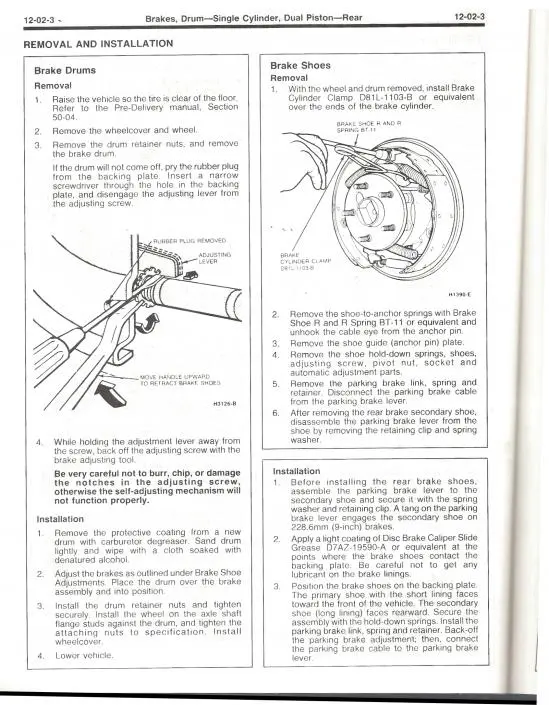

Simple answer - either the self-adjuster wasn't correctly installed or you have something else broken.
Drum brake assembly
I recommend that you print this post and tape the first drawing up in front of you when you reassemble the brakes. It is very easy to do it wrong and without the drawing in front of you.
The springs and shoes are position dependent, so look closely at the drawing when you put it back together. Make careful note of the FORWARD ARROW that points you towards the front of the car. When you install the brake shoes, remember: short shoe goes towards the front of the car.
Here's two pages out of the factory shop manual...

Thank you, I'll print this out after I get back from napa with the new kit. And I was wrong with the part that falls off, it's the metal plate the self adjusting screw ratchets on as well as the steel braided line that hooks into it. Almost like it has no pressure on that part of the assembly

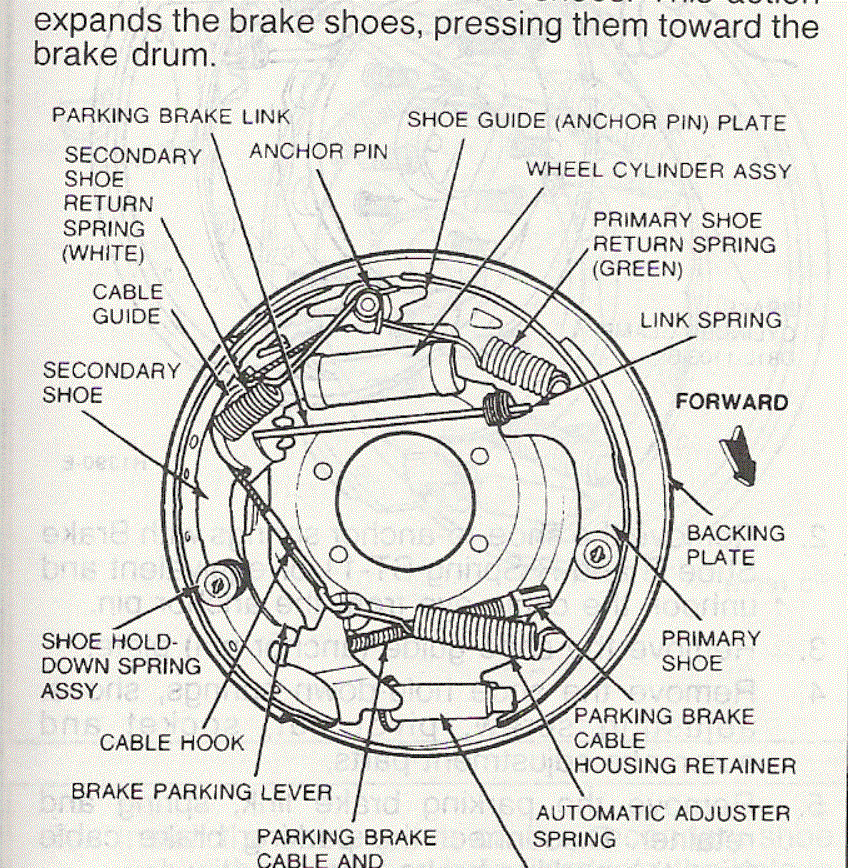

Hey quick question, the automatic adjuster spring (red) does that "push" into the shoe with that other end of the spring? It's hard to tell from pics

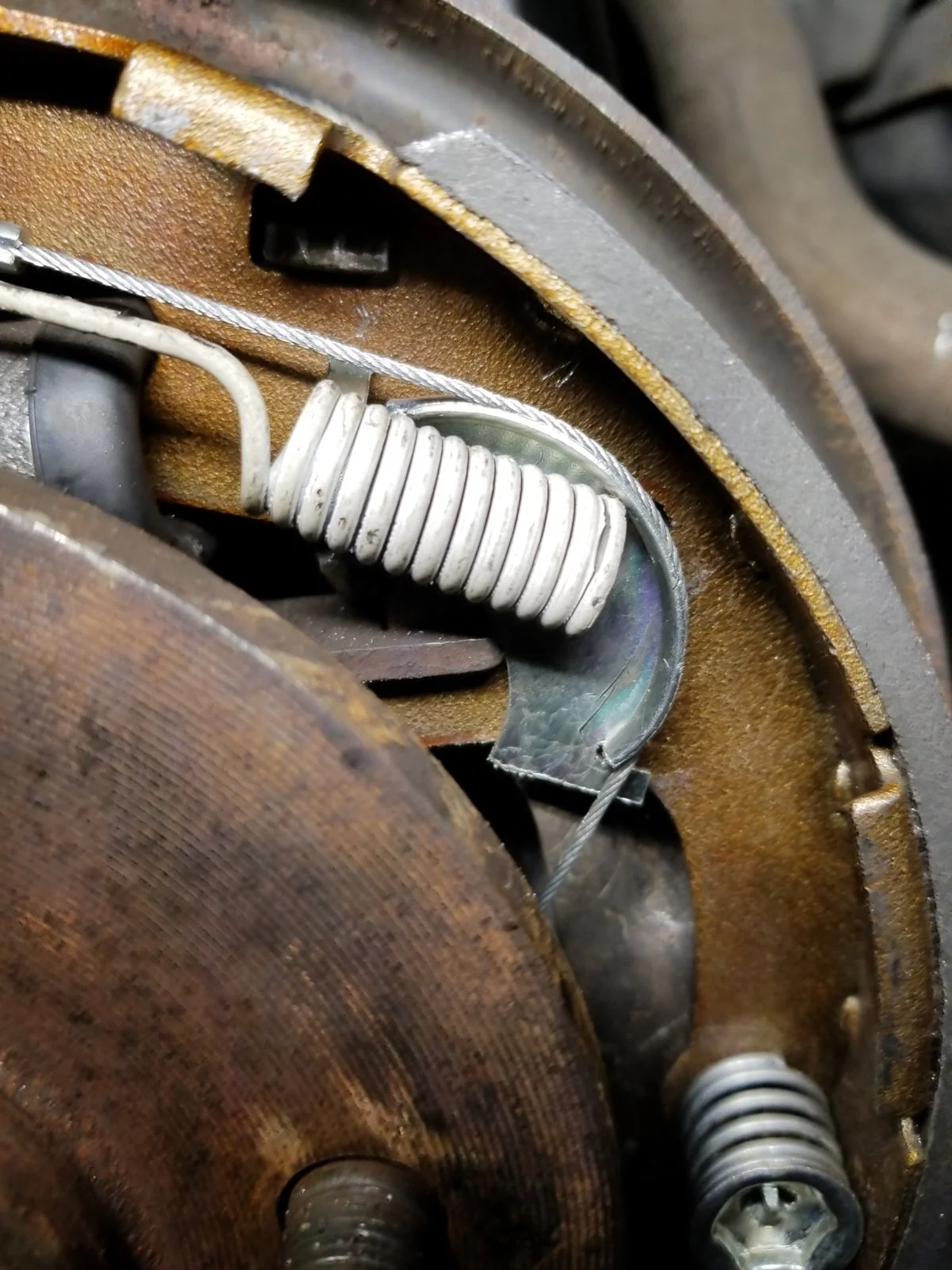

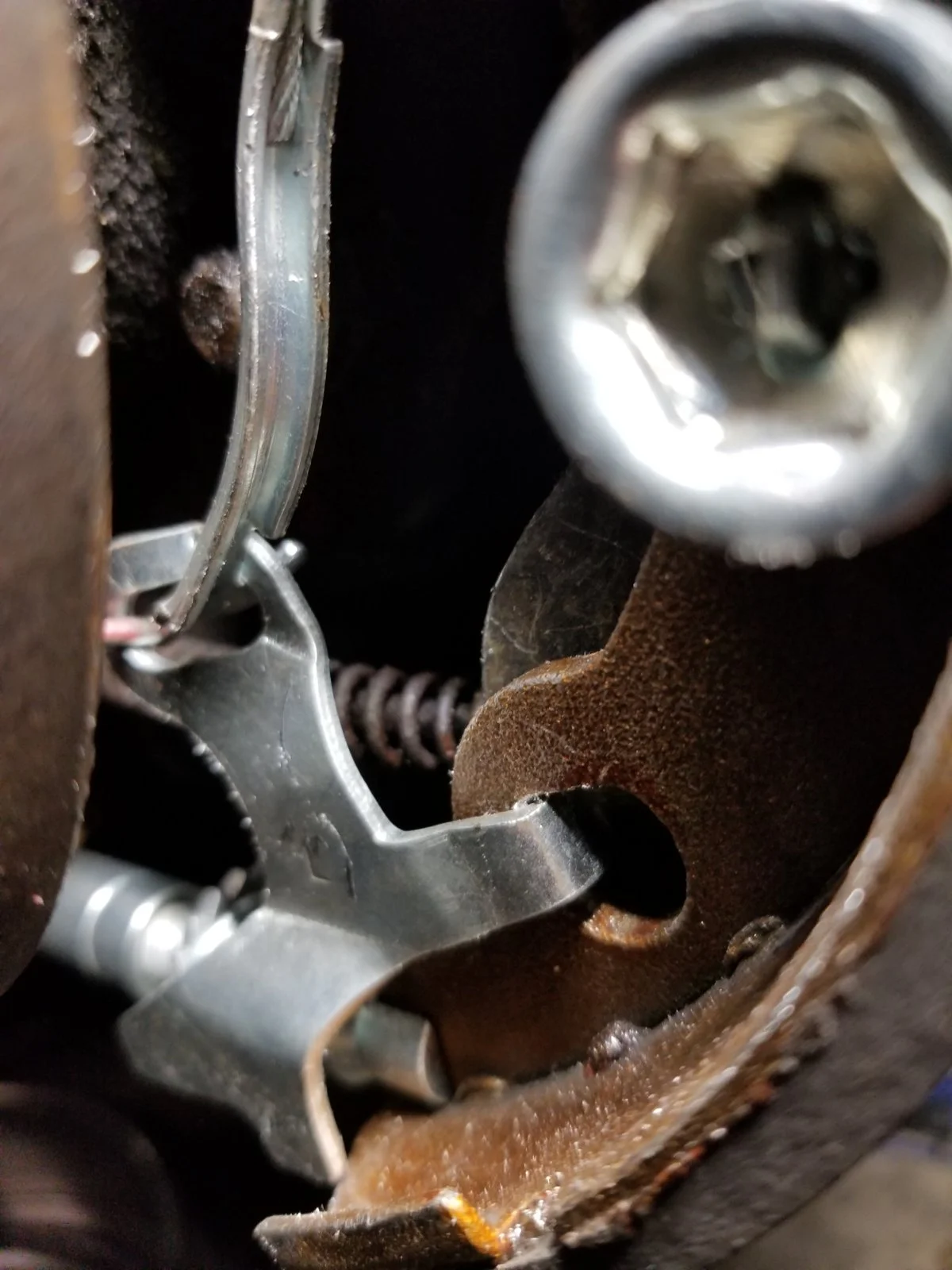

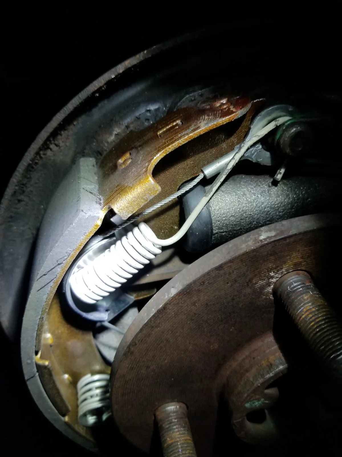

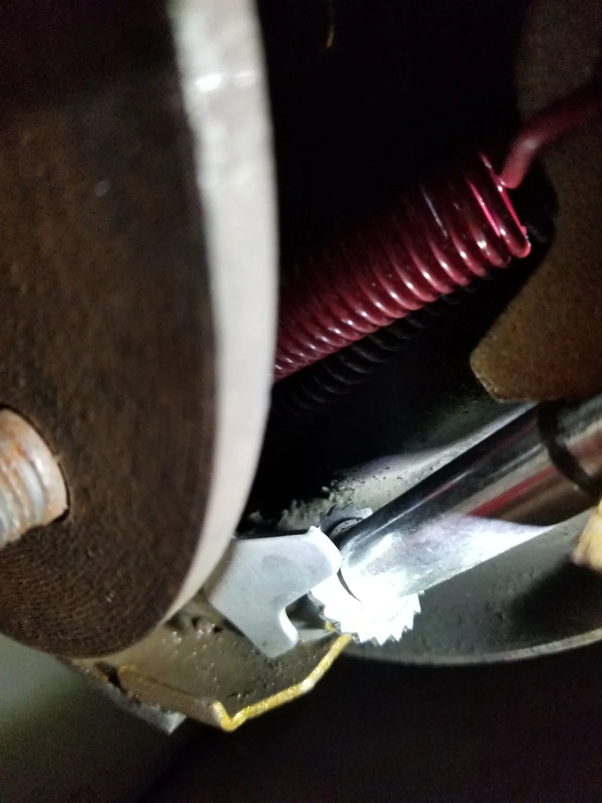

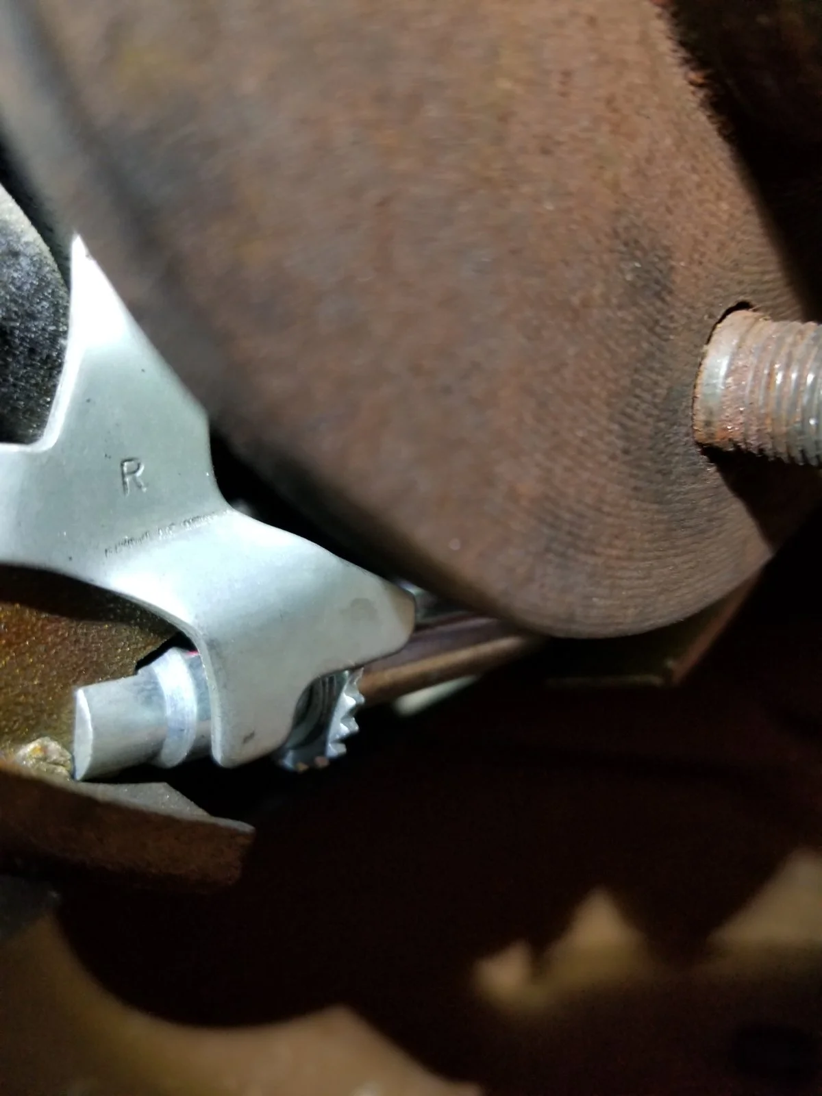

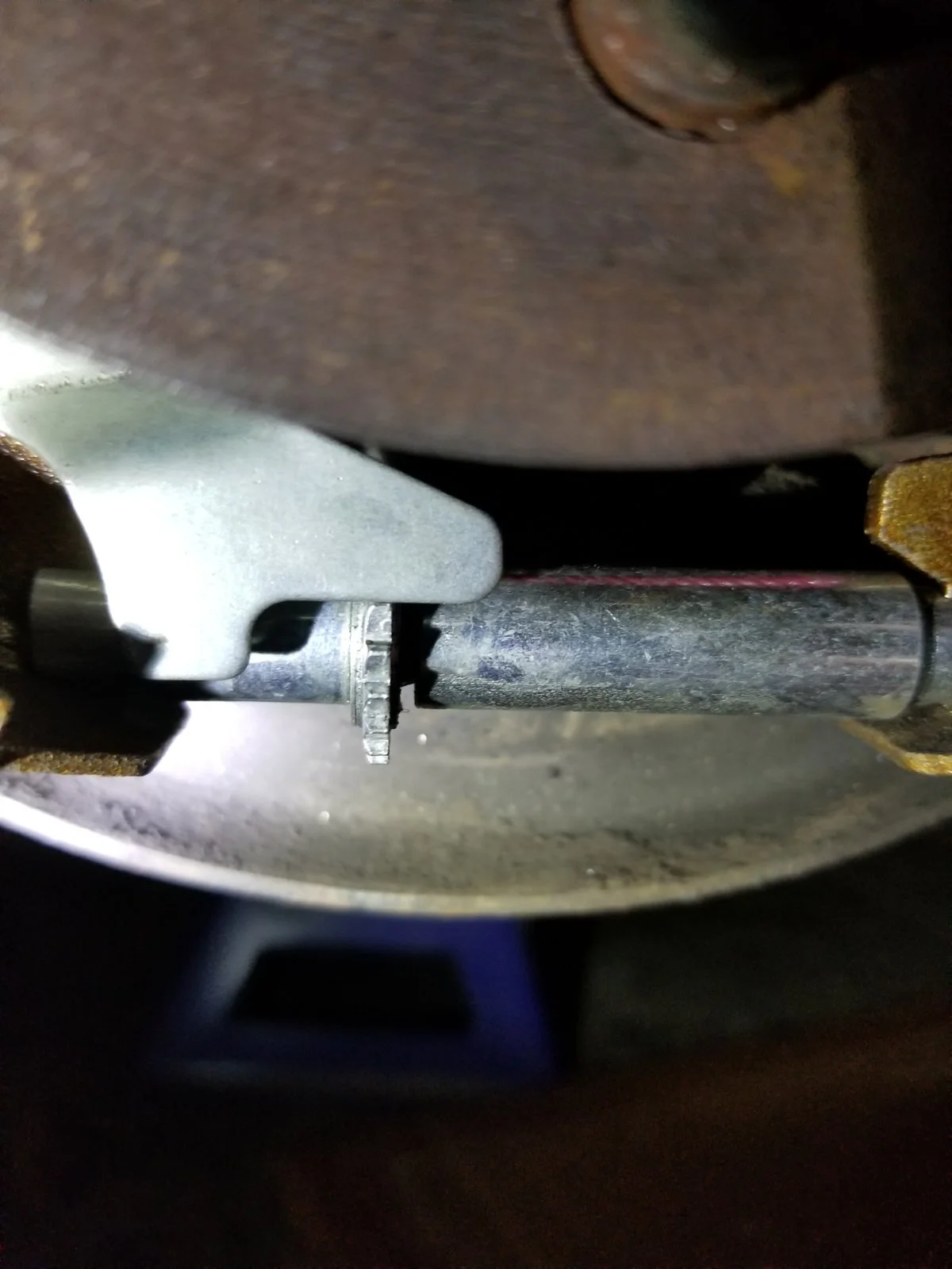

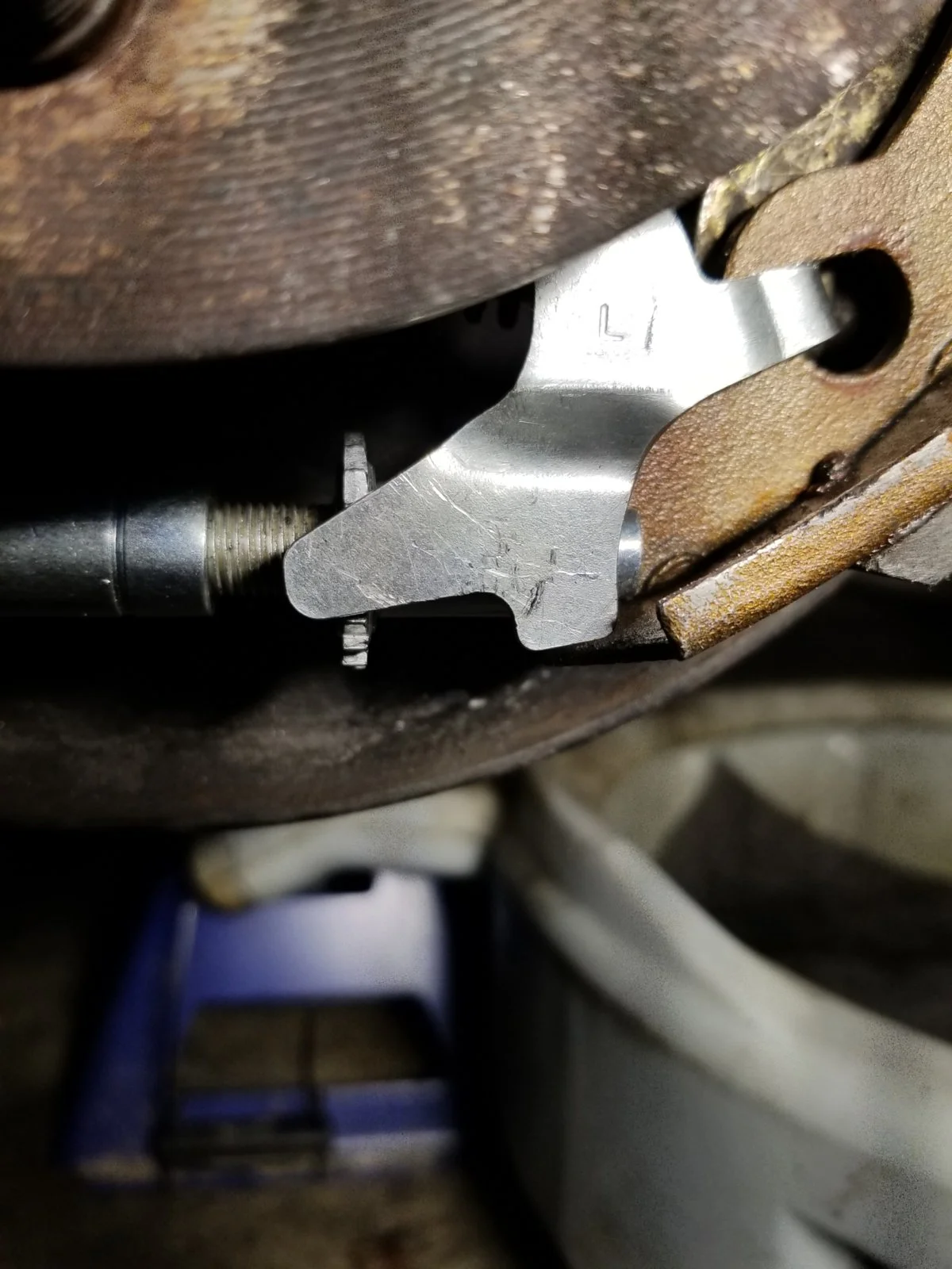

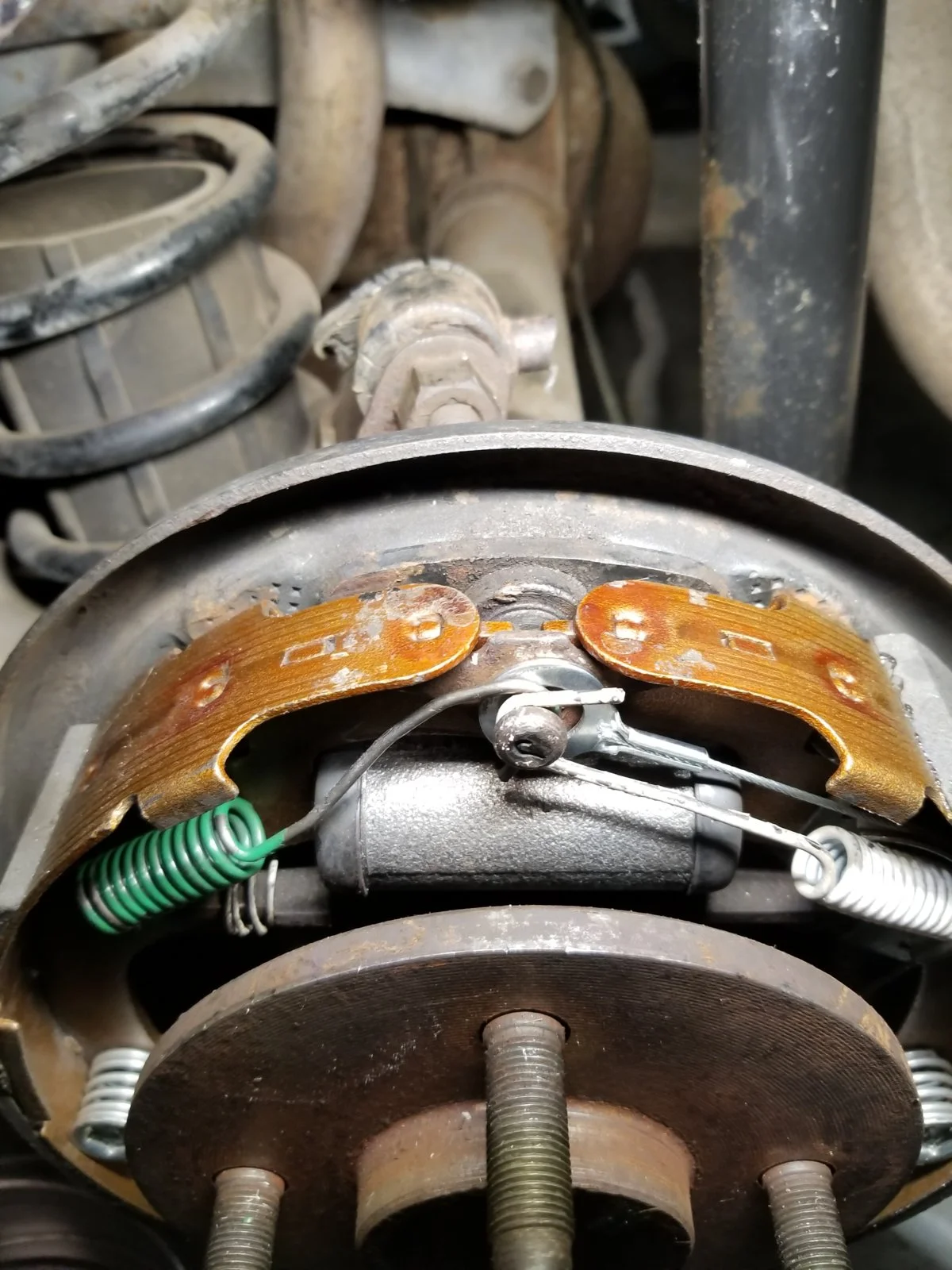

I had another post about the self adjuster falling out, now I have everything put together "the right way" I hope, and the bracket that sits on top of the self adjusted star screw thing at the bottom of the shoes is just sitting in front of it and not on top of it where it's supposed to lock the star screw in place, I've tried taking it apart, changing the pattern of the springs and nothing is working and I'm sinking over here , I'll post pics of what it looks like right now someone please help me. I'm so tired of doing these brakes!!!

to see if your adjuster is working take your finger and pull out on the adjuster cable and you should see the adjuster lift and engage the star wheel, let go of the cable and it should engage a tooth and spin the wheel.
i will take a pic in the morning, when i pull up on the bracket braided line it engages but when i release pressure it pops back off its almost as if the red spring is pulling it off the star

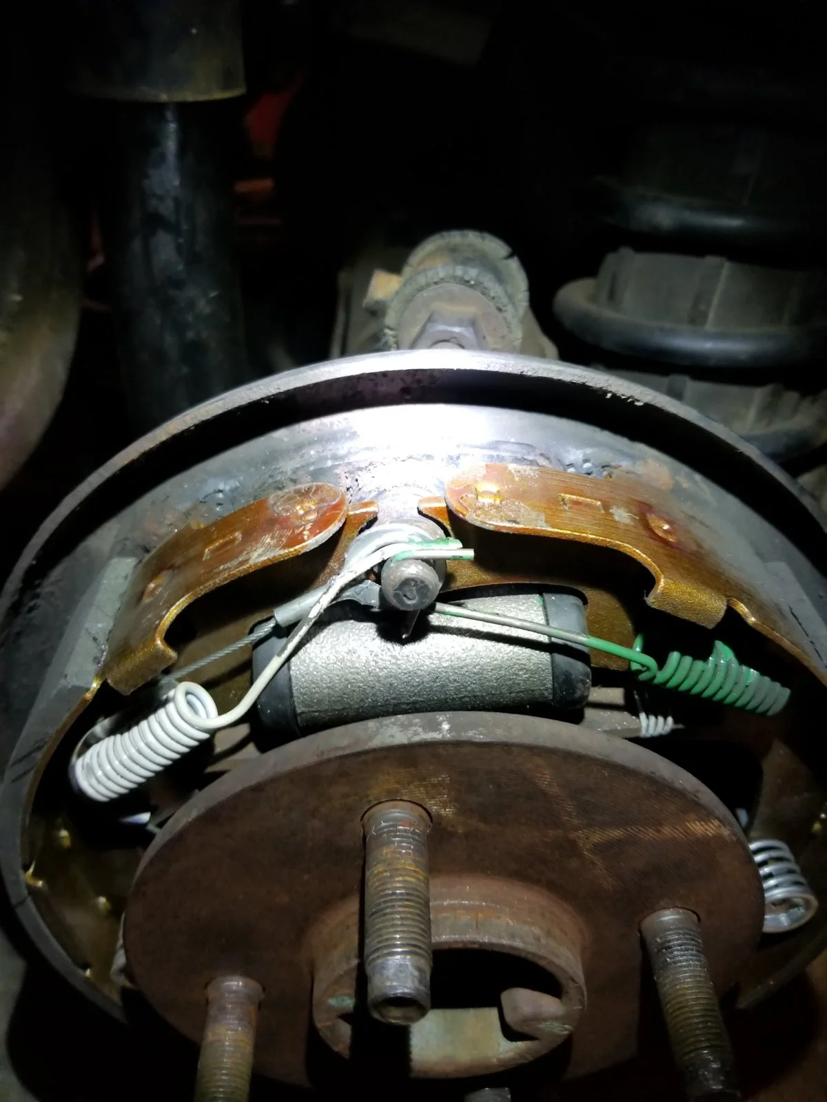

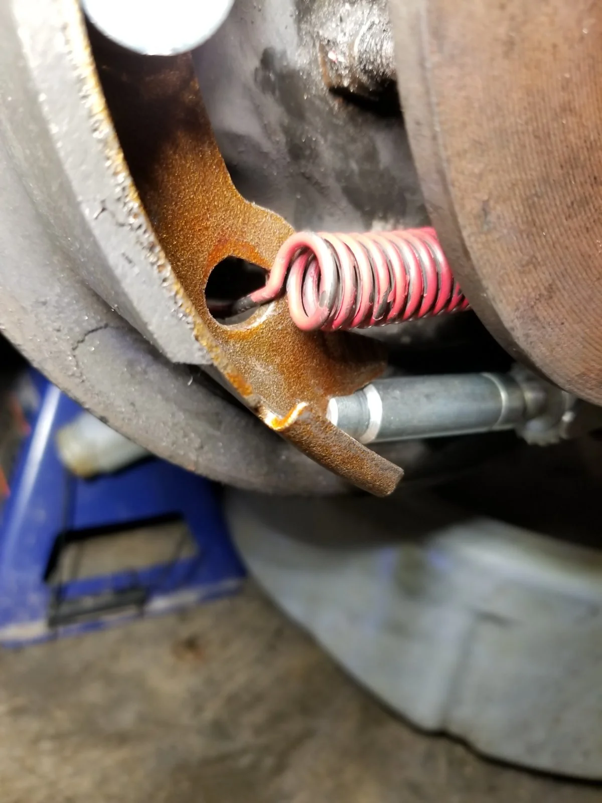

Pass side, I'm drinking playing on my pc lol

they both do have tension on them, i just dont know whats goin on with this drivers side. im about ready to wire tie this :poo: together and be done with it until i can afford a disc brake conversion, also, thank you guys for the help i really appreciate it. i am a car guy but i dont have many friends near by that can come by and give me a second set of eyes
you can kind of see how the drivers side is pointed downward instead of being flush, IS IT because the white spring is pointed down on the pivot point on the pass side and not on the drivers?
OMG did i switch the springs? am i supposed to have the green where the white is on the drivers side? would that make up for the 1/8 to 1/4" of slack that makes the tip point down?
