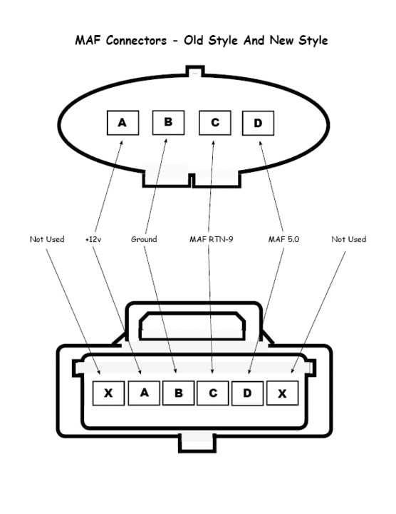

I have an SCT ba2800 90mm mass air that I'm putting in a 94 cobra 302. I coming up with multiple issues. 1.) connections in the wiring have a different amount of pins. And 2.) Its a ton bigger than my cold air kit.
I know people have been doing this, just not sure how.
changing the pins/plugs is the easy part... See pic below...
