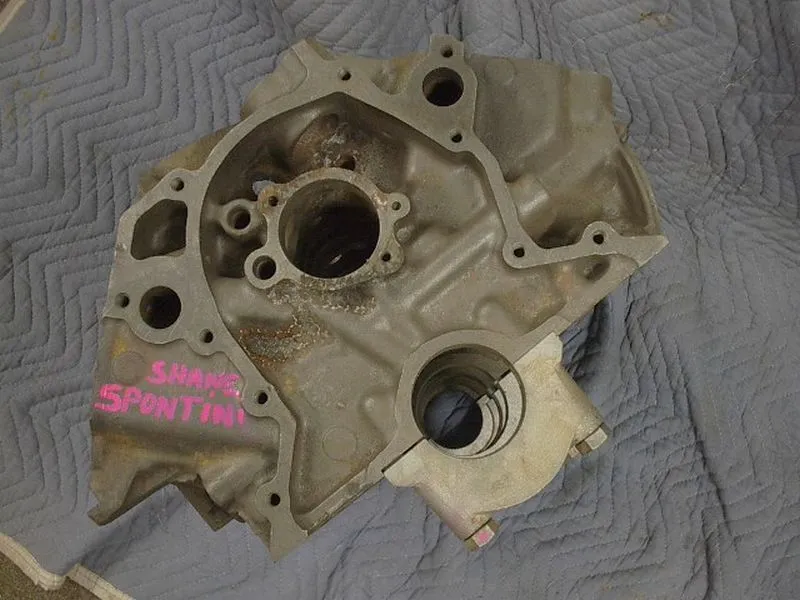

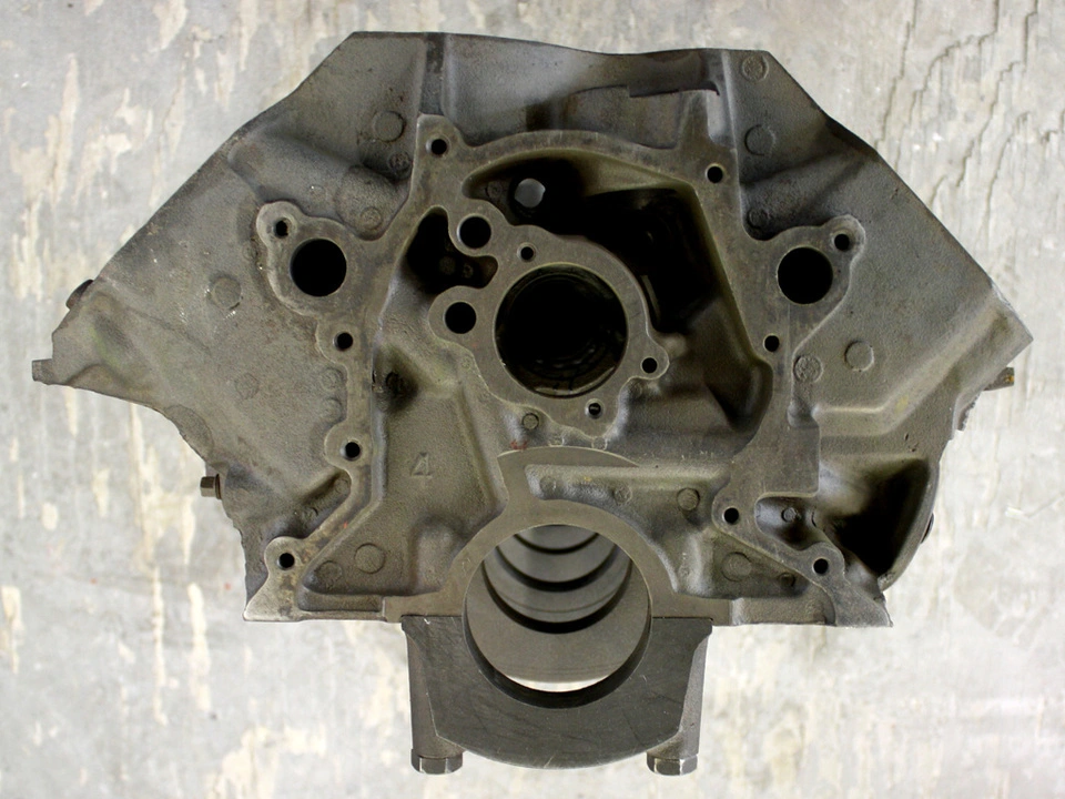

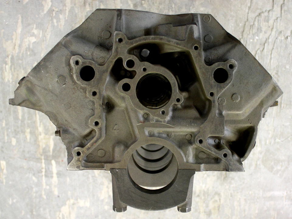

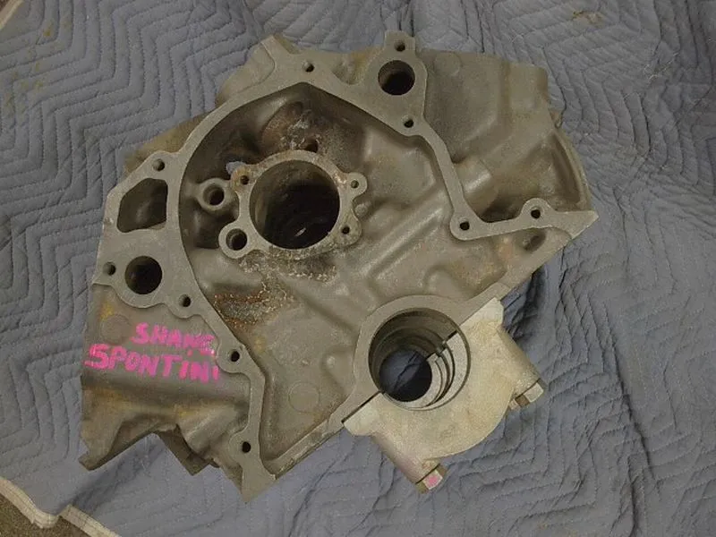

Forget the numbers for a moment, and look at the front of the block. The deck on a 289/302 is even with the timing cover, while the 351 rises 1" above the timing cover, as shown here:

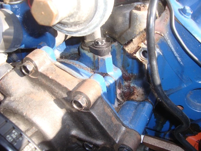

Hmmmm, odd. Here is a photo of the distributor mount area, looks the same as the photos above, rising about an inch above the timing cover. When I measure across the intake manifold, from front inner corner of the left valve cover to the front inner corner of the right valve cover, it looks to be about 9.5". The lower thermostat housing bolt, however, is definitely behind the timing cover...no way to get at it with a socket.
Sure seems to me that I have a 302 (judging by intake width), but the numbers and other hints seem like a 351. Please let me know if there are other clues I can look for.
