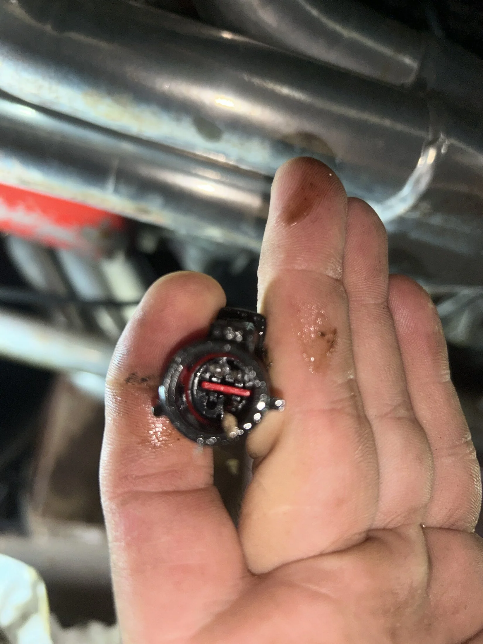

Anyway I can test the plugs when I first got it it had rear lower intake leak and rear main the o2 plugs from the o2 sensors were filled with oil. Anyway to test plugs themselves o2 side and engine harness side

Is their any way to check the plug that the relay for the MAF. I meters the relay and it’s good but I was wondering if I could meter the plug on the harness to see if that’s good while I’m at it. Since both banks being rich could be a MAF issue… appreciate it. I was just giving a update been kinda burnt out on the car for the last week

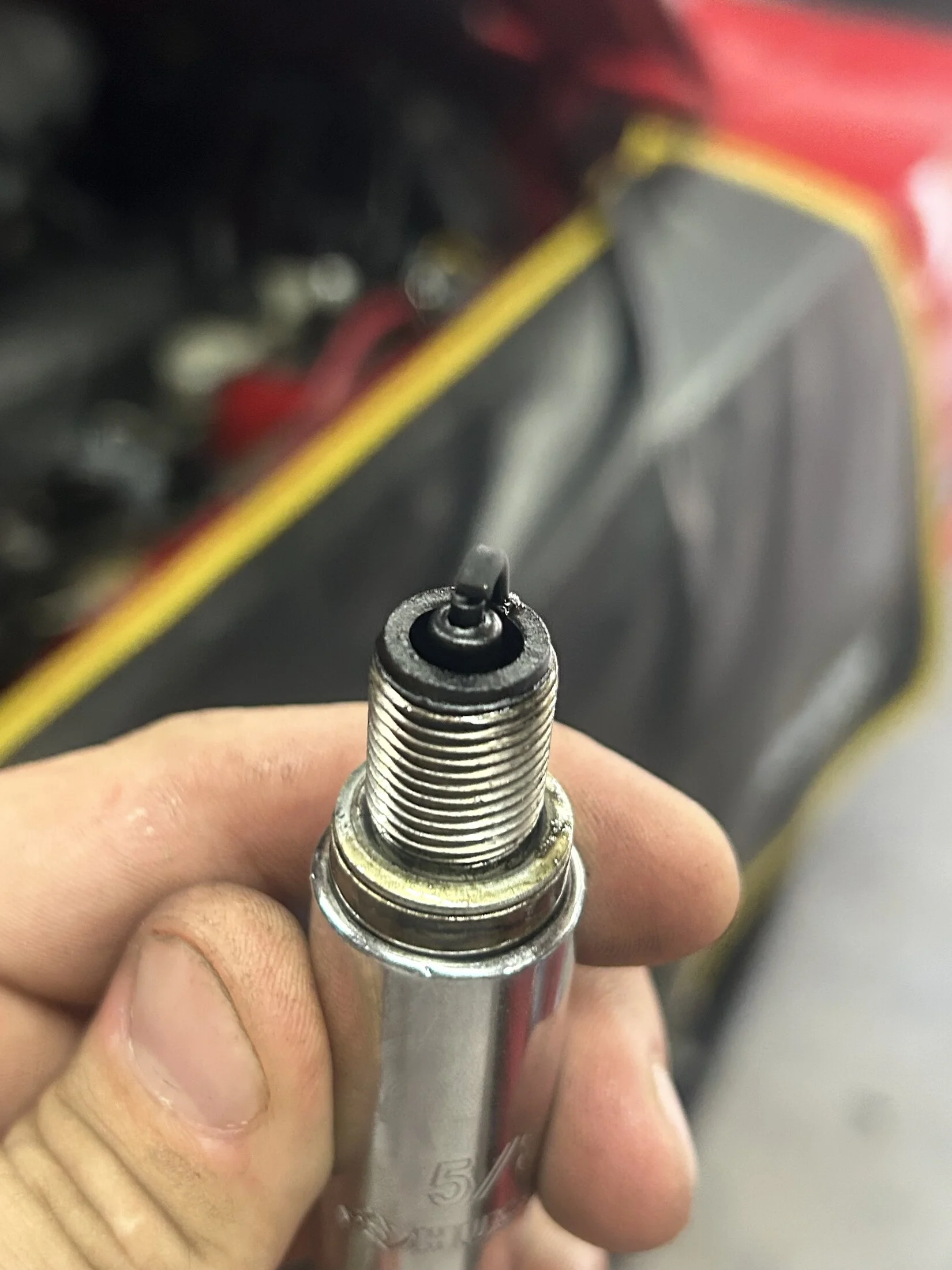

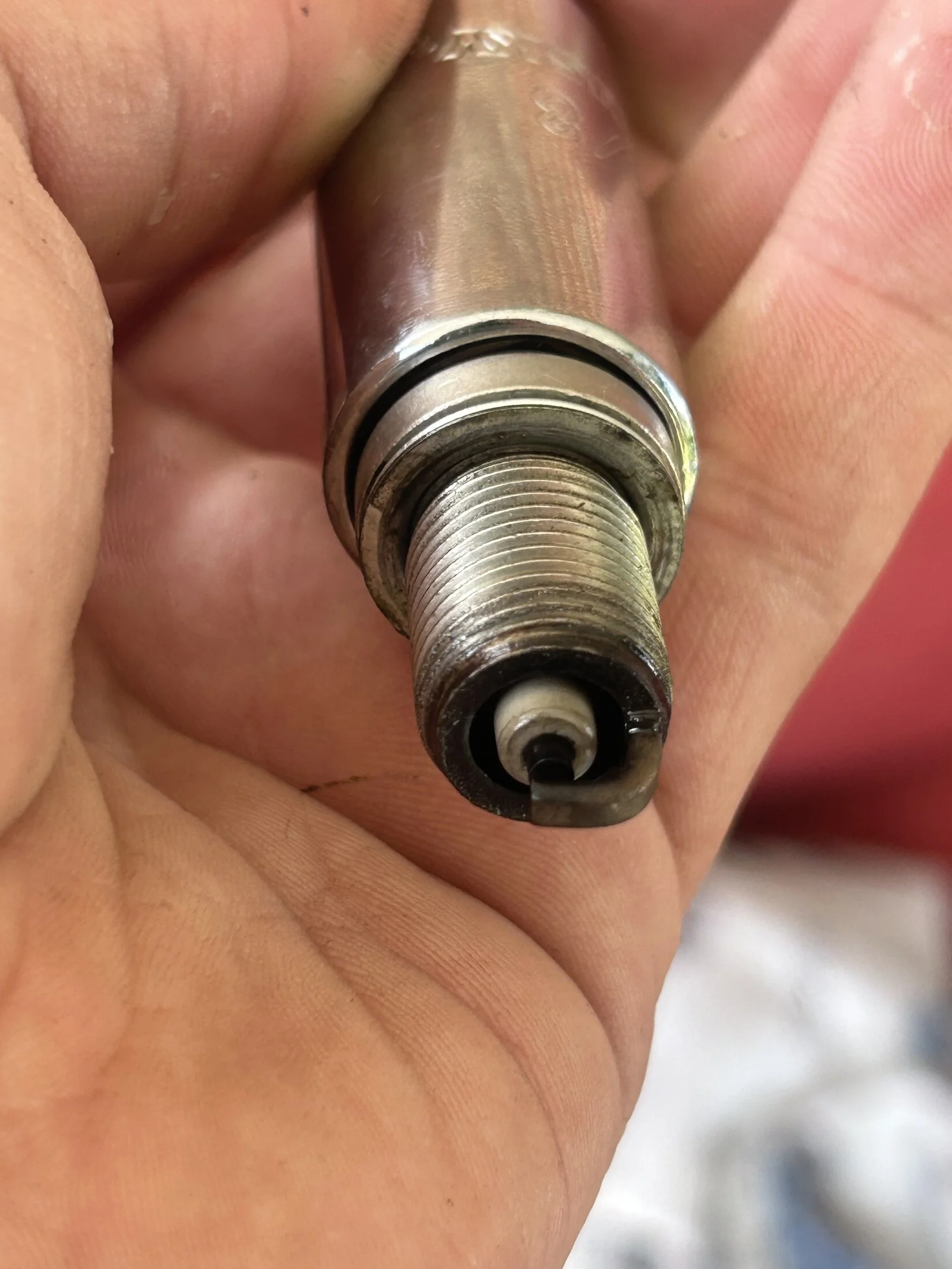

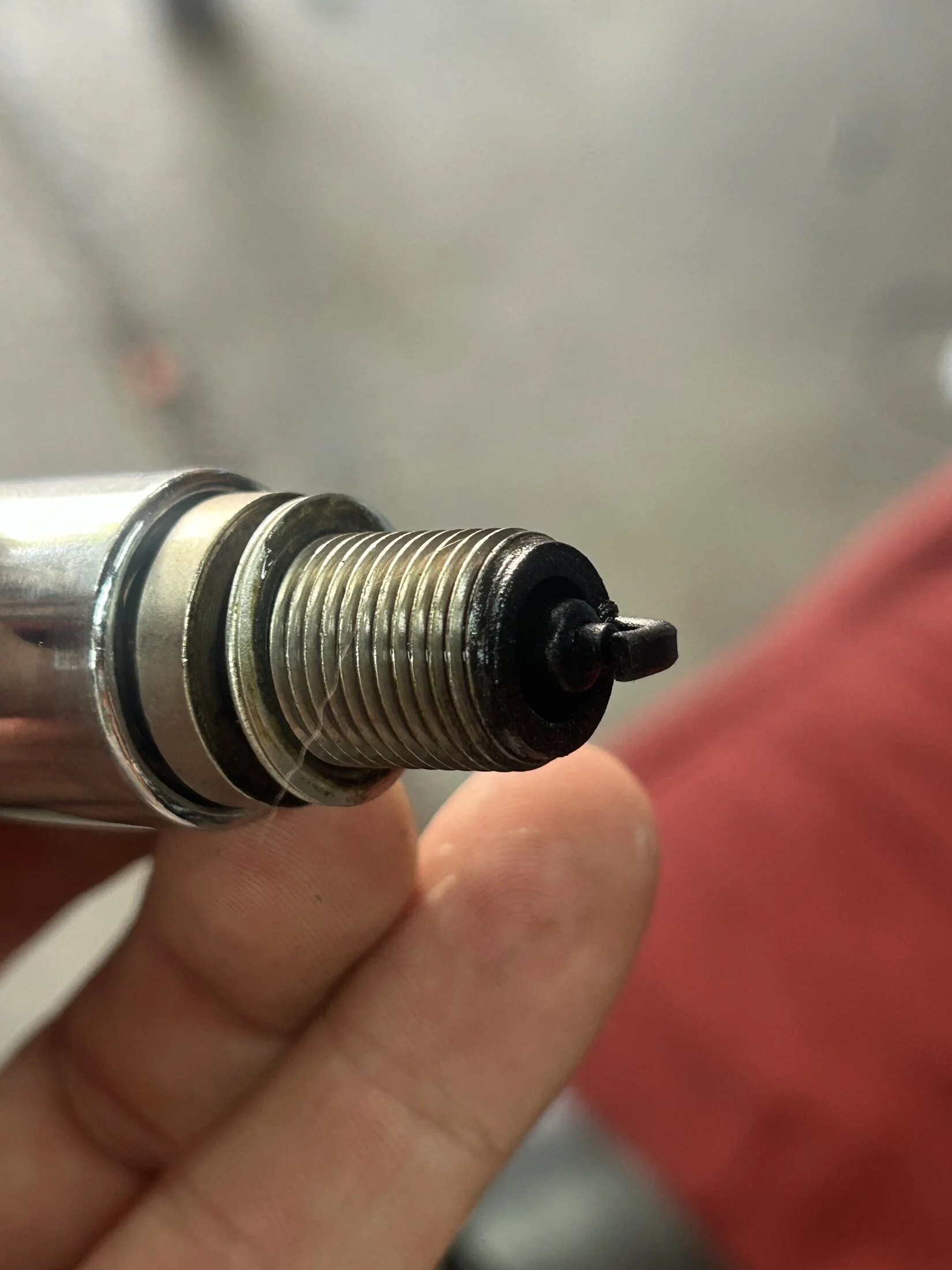

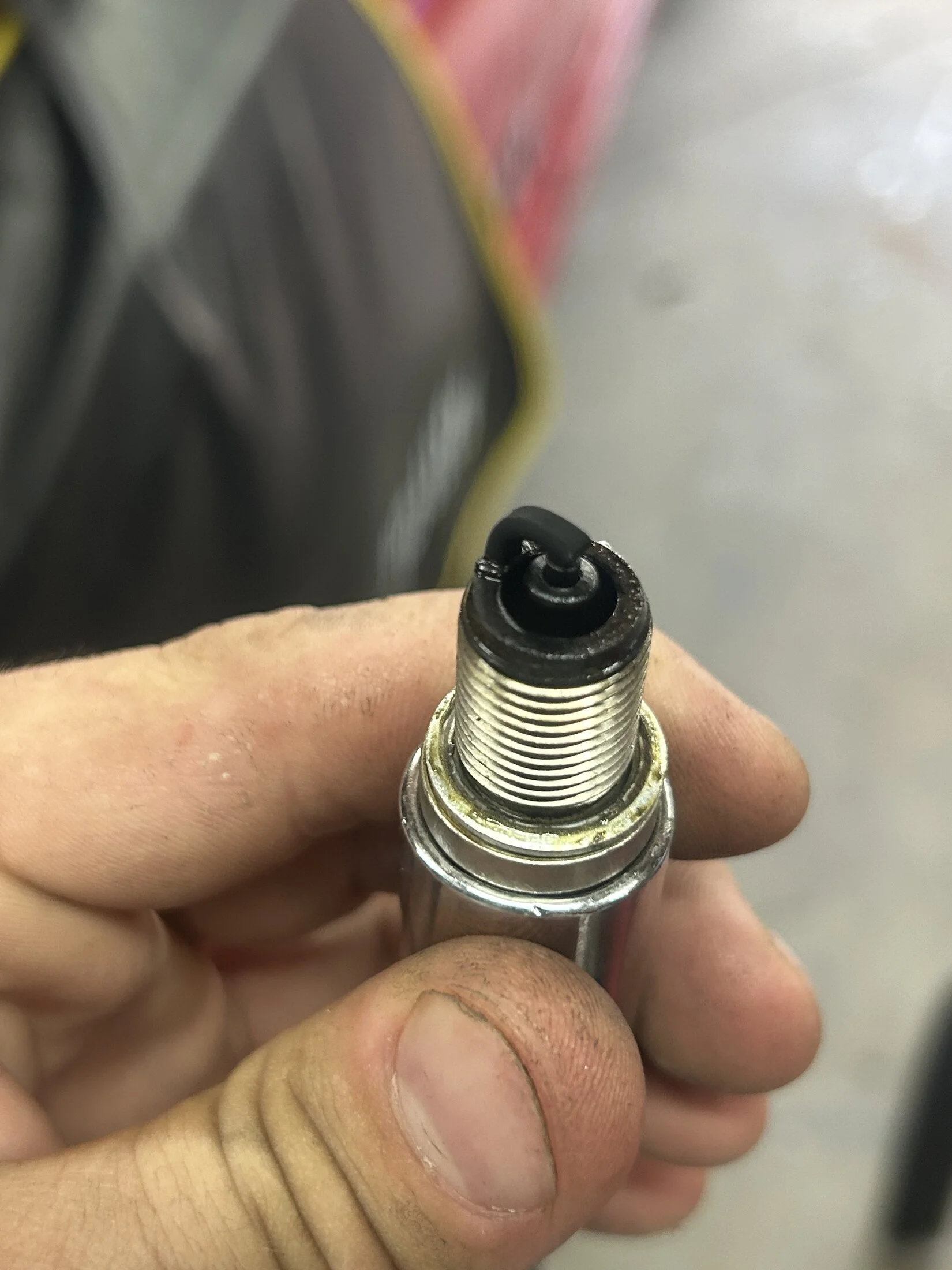

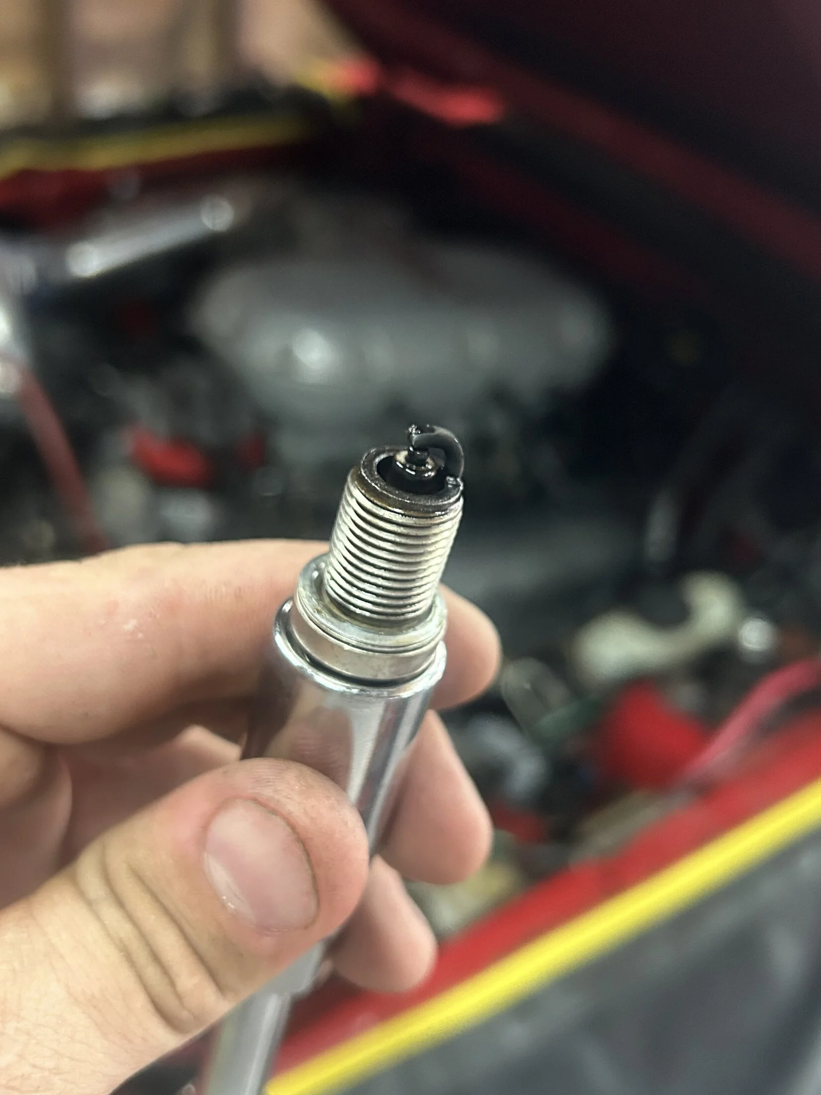

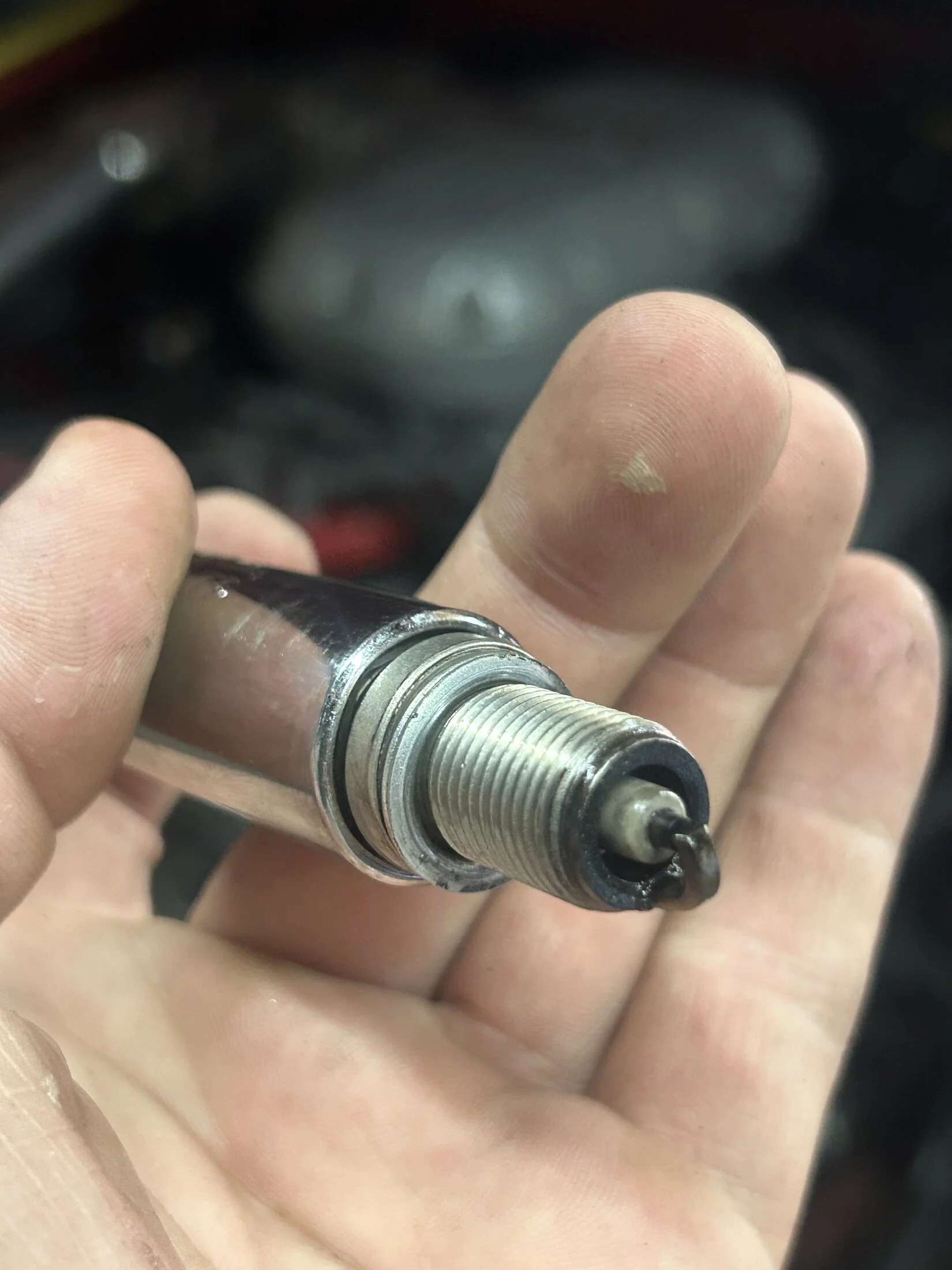

I’m 100% sure they are ford Motorsport I was figuring they are running over duty cycle. It has a pro-m MAF that is calibrated to the injectors. I contacted pro-m racing to see if they can test and if needed recalibrate the MAF. I’m putting new plug wires on for :poo:s and giggles. But if injectors are running over max it would explain if they are acting up. After handful of starts and idles I pulled plugs. These are brand new plugs through them in when it started idling rich. The 2 plugs that are clean are cylinder 1 and 5 the rest were black fouled. Appreciate the repeat reply’s

The injectors cannot be driven past 100% duty. The issue is at 100% duty the ability to control the fuel flow is pretty miserable. IMO tou really should move up in injector size (like 60’s) and go to a Lightning 90mm MAF and get it retuned. Tuner should have a mass transfer function for the Lightning 90mm MAF. Only thing after this would be the fuel pump being too small but an inline booster pump will help that if needed.
