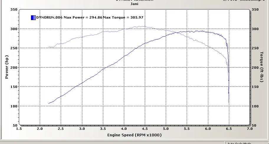

Pics.. Also, I adjusted for the hot air temp buy using the dynojet adjustment factor..

Are those old style edelbrocks or the new ones? Im guessing the old school ones. What kinda port work and did you give Ed a flow sheet to work with? I think your torque is soft down low. I also think leaning it out is worth soem power. Got a full graph with a/f included?? The new edelbrock heads area force to be reckoned with. My friend has them on a 10.5:1 306 and is making 323hp/348tq. He makes 300 ft/lbs from 3200 to 5600rpm for comparisons sake. He still has shorty headers too which will help too if he swaps. His heads are milled, convterted to stud mount and have some slight bowl work fwiw.
the EBII is not a "big" runner. I think your torque curve is good with 250ft-lbs @ 2,200 rpm. Doesn't mean it can't get better though. What timing did you wind up with as intitial? Are you running the EEC for timing or running without a SPOUT?
old style, and yes I gave Ed the flow sheet, avg flow on the heads is better than a Trickflow TW head.. My torque is a bit soft down low I blame the ED2 intake for that because I know if I had a cobra type intake my low-end torque would be killer.. but I have 3.73's for that.. :)
wow, that's a good motor your buddy has..

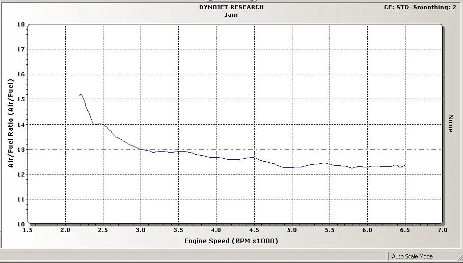

I have the A/F graph, here it is.. I've leaned it out more today since the runs last night (ran out of time, a "TEG" was after me !)..

thanks.. yeah the rpm2 is not for the low-end (though it does do a good job!)..
I think I can get more I need to get a timing gun on my car because in my tweecer spark tables I'm setting 36* total timing at 2500+.. (spout in, base 10*).. plus with the ACT > 80* it was pulling timing, only about 2-3 * but that's why I was a bit mad I couldn't hit 300 cause of the damn heat (ECT was around 184 instead of what I thought would be better @ 170).. oh well, the track will tell, 108mph is my goal !!
Hey, thanks.. that's with cats, I know I lost torque when I put the cats on I could feel I feel more comfortable flying around now not worrying about the cops..

at peak hp or peak tq? I've heard 12.8 @ peak tq and 13.5 @ peak hp.. sound good?
Cats will make a sniffer wb show lean.
My wb is mounted in the collector of the lt's and it showed about a full point richer than the sniffer wb the dyno was using.

tmoss said:
Shoot for 13-13.5 A/F
Yep, I second that.
You are running too rich across the board. You want 13.0-13.5 for the entire RPM range. Why would the RPM's matter when it comes to a/f ratio? Each cylinder combustion is stand alone; Meaning that no matter if you are running 10000 rpm's, or 1000, 13-13.5 a/f ratio for each cylinder combustion creates the maximum explosion, which makes the most power.
But great numbers for the first time at the dyno. It definately takes a lot of work to understand how our EEC works and how to tune it properly.
