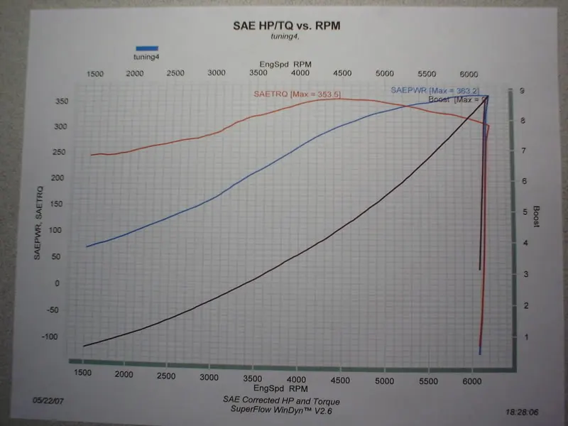

Dyno results 363/353
Well, just got her tuned today. I'm still very very hapy with my car, but I was hoping for 400 ish, came out with 363 rwhp and 353 rwtq. I'm not stopping until I get 400. I'm not getting a smaller pulley, I'm already running a 3.25", and when I move back to sea level, I'll be pushing 11 psi, so i'll need to find another 40 hp somewhere else. What do you think is the easiest way to get there? TB? underdrive pullies? Comments? Suggestions?
i like ur thread, instant info on #'s no anticipation. As for how to reach ur #'s, dont run under drive pullies, not smart on an FI car. LT's would help breathing a lot. Or you could always spend that money on a new intake from summit at like $800. Either way after u get those 3.73's in it'll feel like 400rwhp anyways
Nice numbers! Those sound about average for those Vortec kits. I have a few questions for you since you are the first one I know of that is running a V2-SQ in Colorado.

To get those few extra ponies you may want to add a 75mm TB and Plenum.
just to let you know, you cant run underdrives, it will kill your psi,.. exhaust would make a huge difference. Maybe a boost pipe and plenum.
one thing to remember though is that psi is only a measurement of restriction. so changing these things will free up airflow and boost pressure will drop, but you will be flowing more air than you were at 11psi... so going with a smaller pulley basically achieves the same thing, it flows more air, just not as efficient.
I'm, not saying your one of them, but to many people get caught up in "psi".. it is CFM that matters, you just cant measure it as easily.

Intercooler would be a good idea...but just don't bother with anything else till you're back at sea level, if that's going to be your final destination that is.
And 400rwhp was easy for me without intercooler...just full exhaust, boost pipe, and 3.33" pulley! Made 423rwhp like that...now with the FMIC probably pushing 10rwhp more with 3psi less, now with 3.1 pulley going on (in a while...lol) I'll be pushing the stock block as far as it's gonna go pretty much.
I'd start with the boost pipe, then maybe the tb and plenum. That should put you easily in the 380's. LT would probably put you over the 400 mark from there.
All that being said, intercooler is a good idea. Obviously it'll help cool the intake temps and give you power at the same time. I think think just that and powerpipe would get you very very close to 400.
