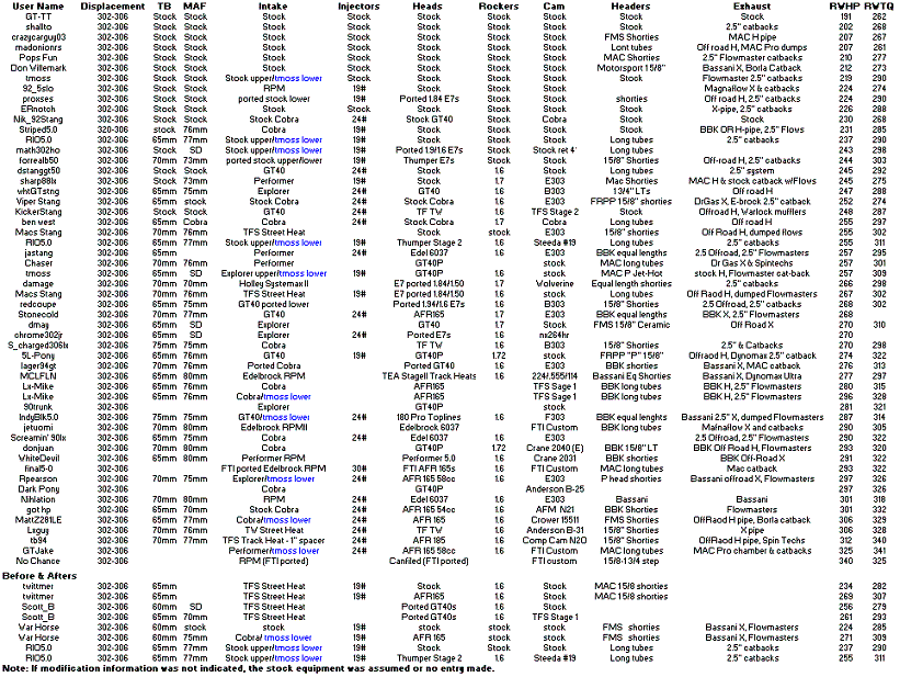

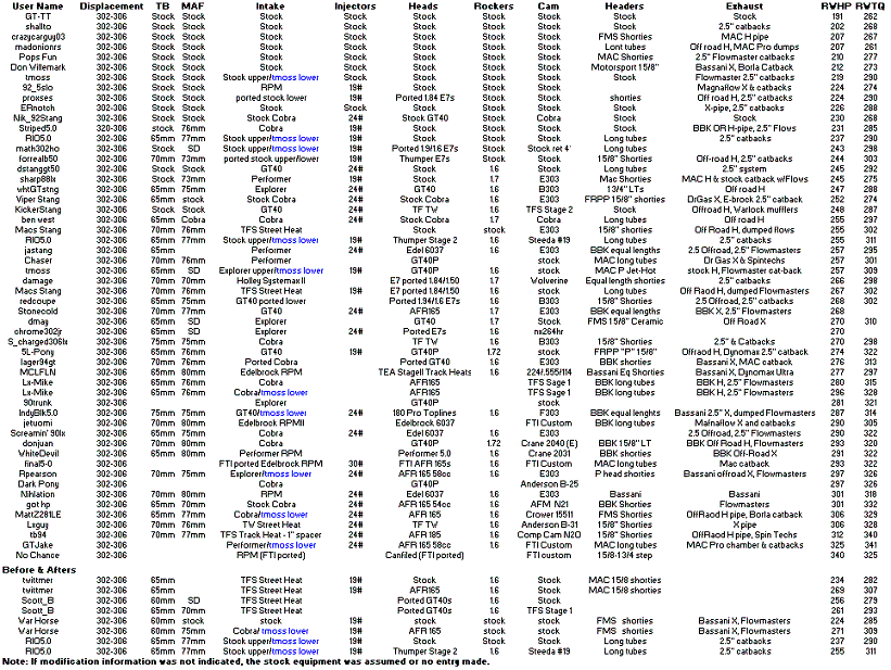

oh and 795.0pacecar, i'd posted this a couple days ago, t moss posted it again, incase you didn't see it, this chart may make you feel a little better about the numbers....there's a couple on here listed that are speed density too....

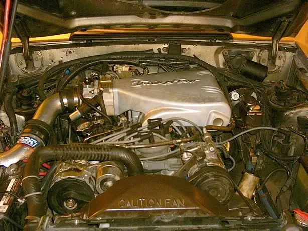

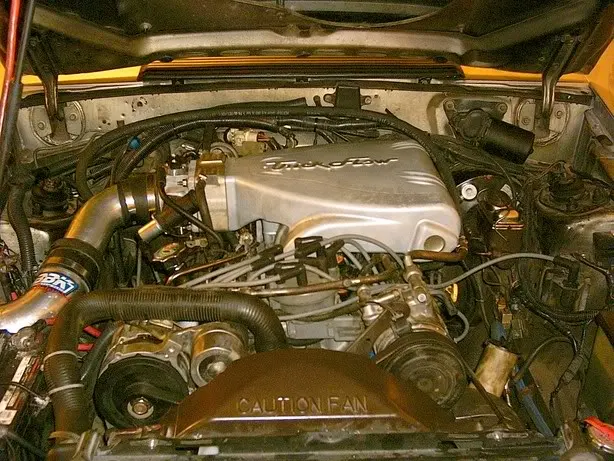

Do you guys think a tune would be a good idea. I plan on keeping it speed density because my car is a 79, so the battery is on the passengers side so the CAI is actually realy short and the filter is in the fender well right after the starter solenoid which is also on the passengers side. The drivers side has the coolant overflow/windshild wiper fluid bottle where the battery would be on an 86+. So swapping sides with the battery is kind of not an option and Im not sure I would have enough room to fit a MAF sensor.
Heres a pic of my dirty ass engine bay to give you guys an idea of what Im talking about.

your mods will work fine with SD. I ran thumpers heads with tmoss ported stock lower 24# injs comp cams nx264hr cam then swapped to a cobra intake and it ran great! I eventually swapped to maf just to see and it ran about the same. Maf brought more tuning issues with it. SD is easy to tune if you know what to do with it. You dont need a 500.00 tune. Just play with the timing and fuel press until you find a happy medium. I tweeked with my set up on my own and when I finally put it on the dyno We played with timing and fuel. Turned out I had it set exactly where it needed to be.

like i said if you look at those numbers in the chart your right on, plus or minus some....
