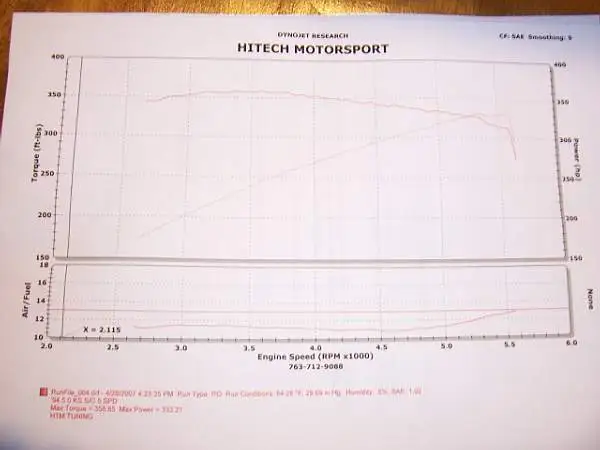

Today was the first day I had my car tuned on the dyno. What I found out, is my 255 lph pump is not keeping up with the fuel demands at full boost/rpm.. He thought it might be the filter, so he kept it a bit conservative on the dyno. He said once i fix the fuel issue, he thinks it will do 340-350..
Has anyone had problems with the 255 fuel pumps like this, or can you recommend a better solution?

Makes absoutely no sense to me... That fuel pump is MORE than enough...
Let's use the formula that says
horsepower (HP) = lb/hr (fuel) / BSFC
If we assume BSFC of .5, then HP = 2 * lb/hr. Then, if we round the weight of a pound of fuel to 6 pounds HP = 12 * gal/hr. So, if we assume .5 BSFC, then you can actually multiply the numbers in the flow charts by 12 to compute supported horsepower.
For example, If you look up the flow rate of the 190 ltr/hr pump in the Technical section, you will see that it will push 36 gal/hr at 50 psi with a 12 VDC power source. If your engine is pumping out 500 hp when the fuel pressure is 50 psi [@ 12VDC], you probably won't want to use the 190 ltr/hr pump [36 * 12 = 432].
Correct me if I am wrong but 255 puts out 58 gallons per hour at 40psi = 58*12= 696 HP. ?
His power is not that low. 340-350 should be pretty spot on for that combo.

I had that problem exactly. When I was getting my car tuned, I was running out of fuel at around 4500, and I was around 340hp at that point. I added a Vortech T-rex inline IN ADDITION TO my 255lph pump, and now have no problems even with a smaller pulley! (my car was tuned with a 9# pulley making about 6#, I swapped it out for an 11# pulley so I make more like 8).
It sounds like you have a very good and responsible tuner. I would rather have it a bit rich to compensate for a hot day with the blower pushing really hot air!
