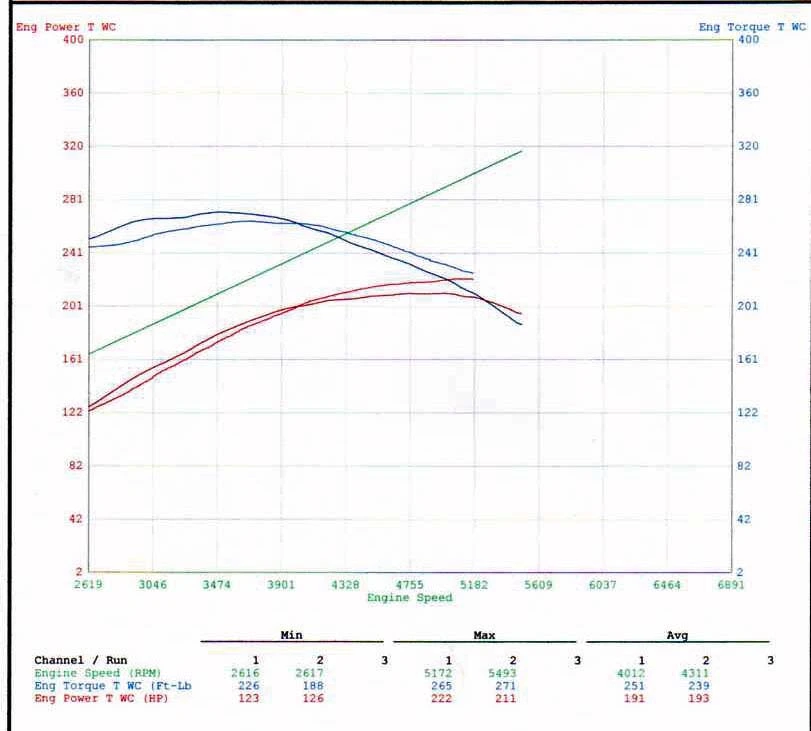

well, here are the results. It looks pretty clear that the cobra design was not optimized for my little e7 heads, but it didn't do too bad. I gained alot above 4000 but my average torque was down 12ft-lbs. I would definately have gone with a tmoss ported stock manifold if I wasn't planning on adding some afr 165s later. I think they shut my car down too early though. Not sure why they did that. This was run on a mustang dyno.
Peak rwHP: 222 at 5100rpm
Previous: 212 at 5000rpm
Peak rwft-lbs: 266 at 3600rpm
Previous: 271 at 3500rpm
