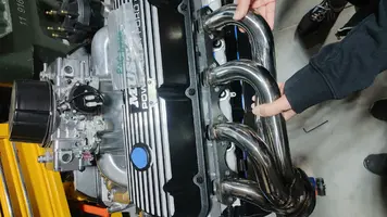

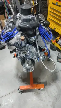

I thought I would try the cheap S/S Headers for SBF 302 for $95.00.
Contacted seller Undergarage and they assured me that these were the same as BBK S/S Headers just un branded.
Headers arrived. they look GREAT! Stainless Steel was nice and Quality looked good.

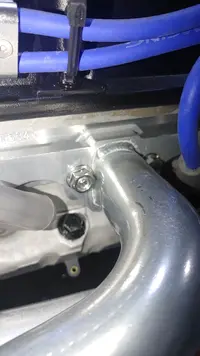

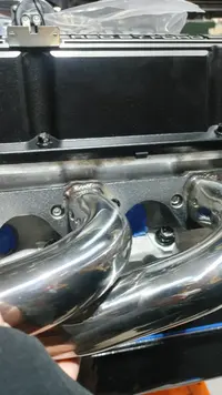

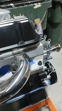

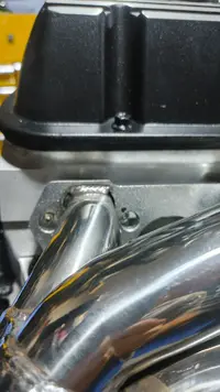

Tried installing Headers and cylinder 4&5 bolt holes don't line up.
Contacted seller About DEFECTIVE Headers. Seller wanted me to drill out holes and offered discount. NO WAY! I said.
Messaged seller I wanted Refund or Replacement. After Days of messaging seller finally offered a return and told me to select "DID NOT LIKE"
I messaged back Why not choose "ITEM DEFECTIVE" seller gave all kinds of B. S. So I chose "Did not like" and shipped back to seller.
Seller said Headers were used and deducted 50% and refunded 45.00.
I have filed Ebay complaint. Doubt I will win.
Bottom line is NEVER select "DID NOT LIKE" If 'Defective', Even if SELLER tells you to!!!! Select "DEFECTIVE"
Ended up Buying BBK 1 5/8 Headers which fit perfectly even When using Header mounting Studs. Stud Nuts are tight but I managed to get the nuts on the studs.

So, do you own these crap Chinese headers now? If so, take your time, measure 5 times and mark the header flange. Drop it off to a machine shop and get it drilled. Check the flange for [flatness] with a metal ruler before you install.
Use a quality aftermarket header gasket and quality 12 pt. bolts with Red Loc-tite.
Or... Scrap them and buy a quality set from say... Anderson Ford Motorsports

Fwiw-I have had a few sets of name brand headers(bbk,Mac,etc.) and I’ve had to persuade many of em with a Christmas tree bit in a drill press… lol
