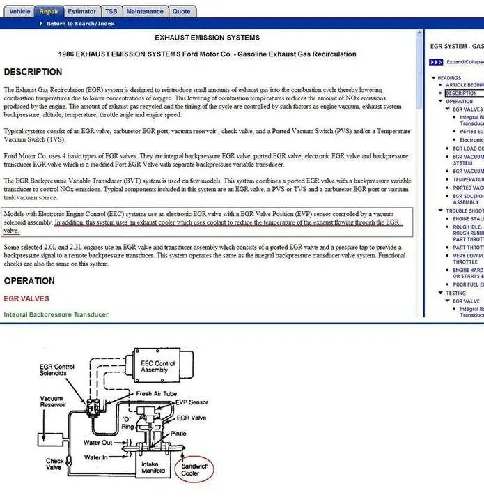

On the contrary, the coolant hoses are used to cool the EGR gases and the hot spot the EGR spacer becomes when exhaust gases are flowing through it. Different to the Cobra intakes, that creates the heat sink effect by not using a thin-walled spacer and using the upper thick casting....... if the coolant hoses were used for anti icing purposes, why doesn't the Cobra intake have provisions for them?
Not having the coolant hoses connected to the spacer, and a functional EGR system, will create a hot spot on the TB that could cause premature TPS failures due to temperature increases. I've worked 4 cases (1 Town Car, 2 Mustangs and a 1 F-150) that had recurring TPS failures in a 6-8 month time frame. The cause was the bypassed coolant hoses and having a functional EGR. This last item is key, since a non-functional EGR system will not cause the EGR spacer temperature to increase due to the absence of the exhaust gases flow.
Below is the description of the EGR system by FoMoCo and the reason for the coolant hoses in EEC controlled EGR systems.
My bad. I was just stating what it says in my Ford Factory Service Manual.
