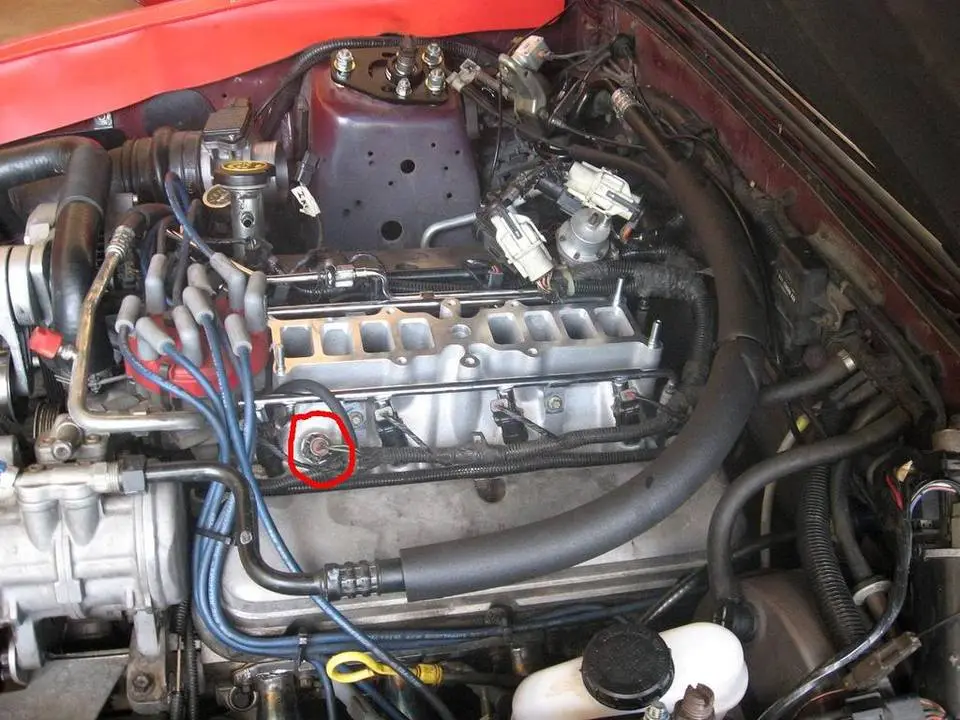

Is your car still speed density? Might want to look at the MAP sensor, too. Better yet, it's probably best if you pull the codes.
Heres a pic of the ACT location. Ignore my terrible paint skills.

yeah, i found it, and i just tried the new ECT and no improvements. next is the ACT and then MAP. my dad is saying to just take ti to a mechanic and let him run the codes.
