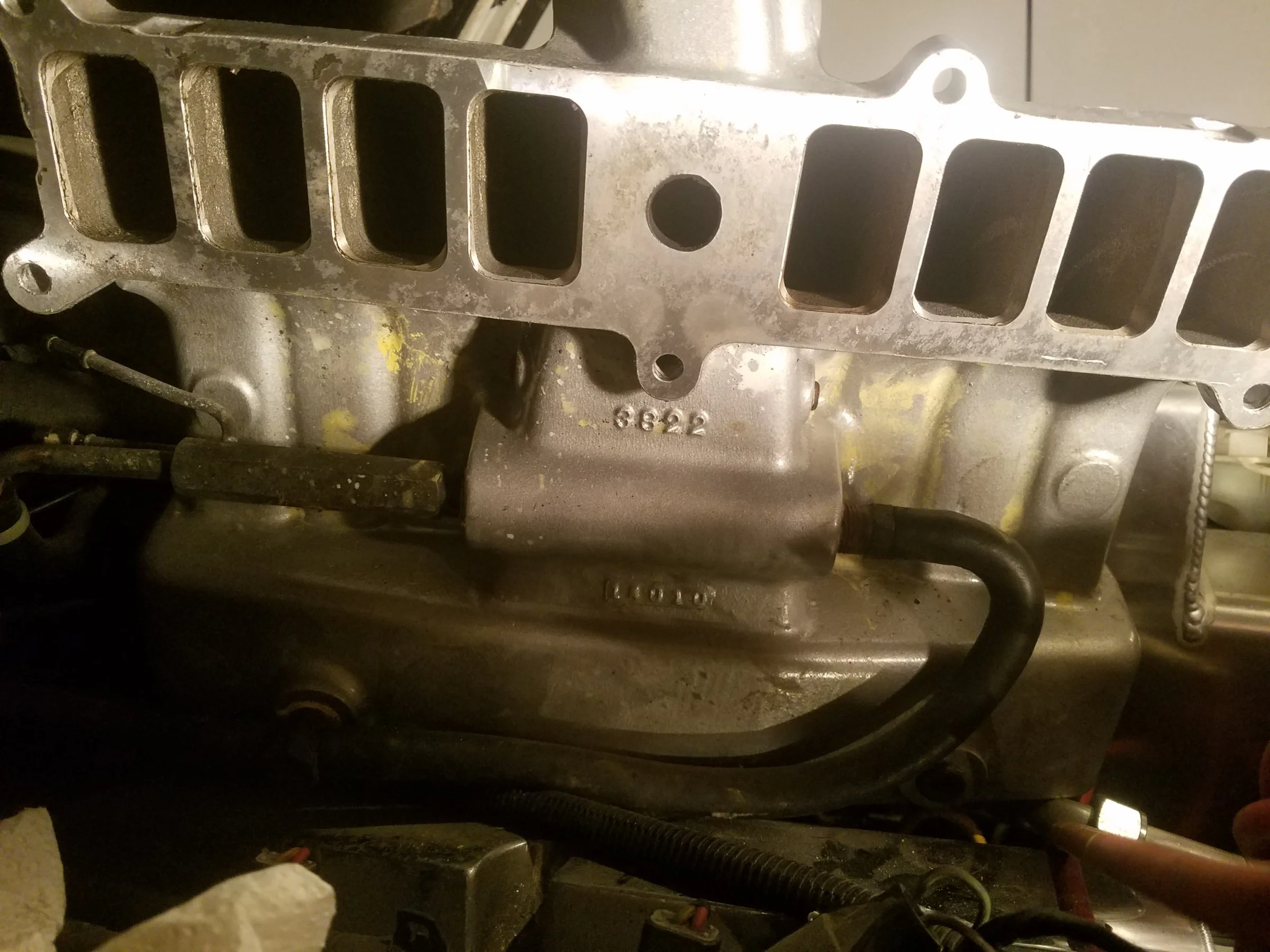

have a 90 lx aod transmission the previous owner installed a edelbrock performer 3822 he must have removed the canister purge valve and the hose from the intake to the valve. my car code is reading 85. does anyone know how to reinstall it. i took off the upper intake i just dont know what port it is for the 3/8 hose

The hose on a stock intake installs on a nipple in the front of the intake. Travels over to the passenger side and down to the frame rail to a purge valve then to the canister, a plasic line from the fuel tank is connected to a hose nipple on the canister
Looks like yours has a hose that turns to the back of the intake, can't tell where it goes from there. The purge valve connects to the injector harness by the couplings at the fuel rail.

i think it was capped off and removed the harnessss is missing also it has a 3/8 allen screw as a cap im going to remove one side and add a hose thread connect the hose from intake to a purge valve to charcoal canister. correct ?
