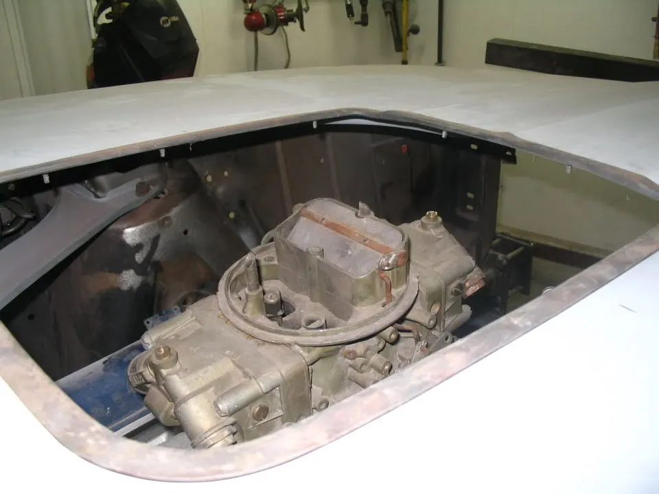

if anyone is really interested in knowing how to get a shaker setup with a vic jr then let me know.
here was a very early mock up picture when i had the stock motor mounts, block, heads, vic jr, and a holley.

in actual labor, i probably have around 40 hours into this one (not counting the time scratching my head).
it will require drop mounts.
when you get to the point you start buying parts, then let me know. i'll provide some lessons learned.
