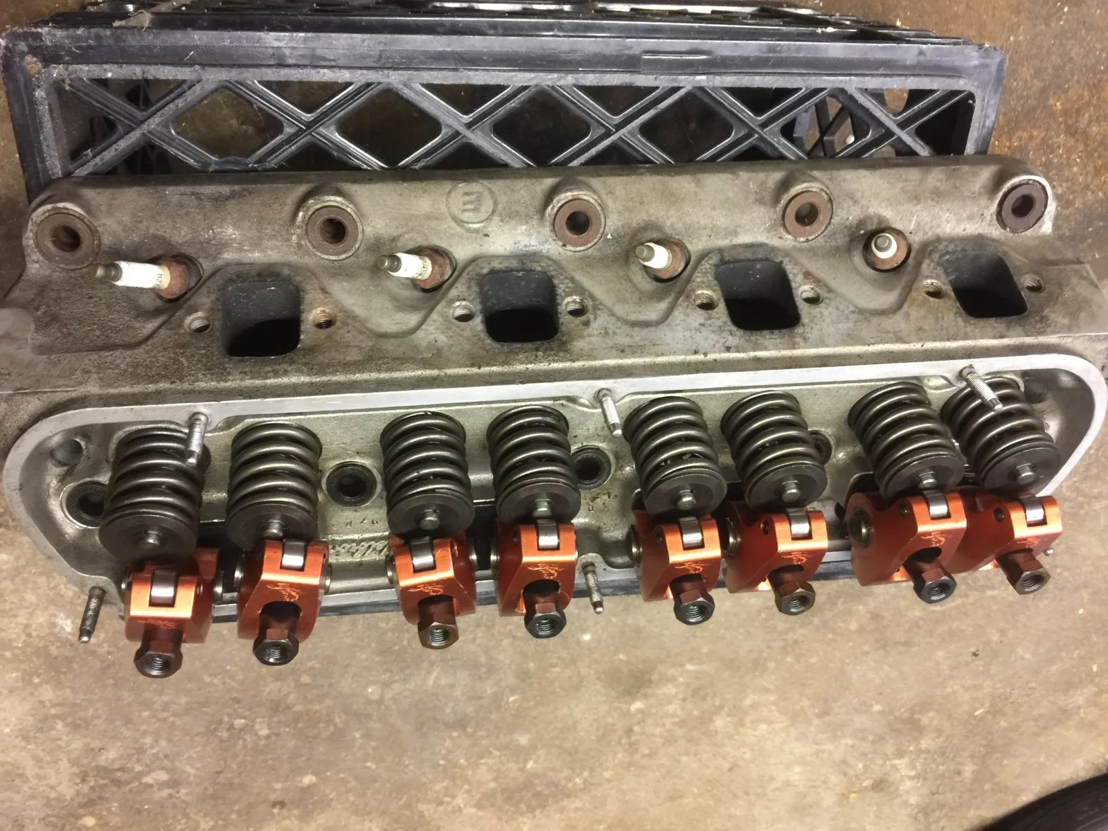

Ok so I called a couple of machine shops around in order to get my heads minimally milled and cleaned. I told them what my plans were, and I was asked if the car that the heads came from had hydraulic or solid lifters. They also wanted to know what kind of springs I had on the valves, is there any way to tell? What kind of a cam should I go with? Looking for something with a nice lumpy sound but not too much, and that has good low to mid range power. Thanks
You're gonna have to do some calling. Call edelbrock and ask them questions specific to the springs, i.e. installed height, spring diameter, single/double with or w/o dampener. Open and closed pressure.
Then the machine shop can tell you if the springs are stock, or add-on.

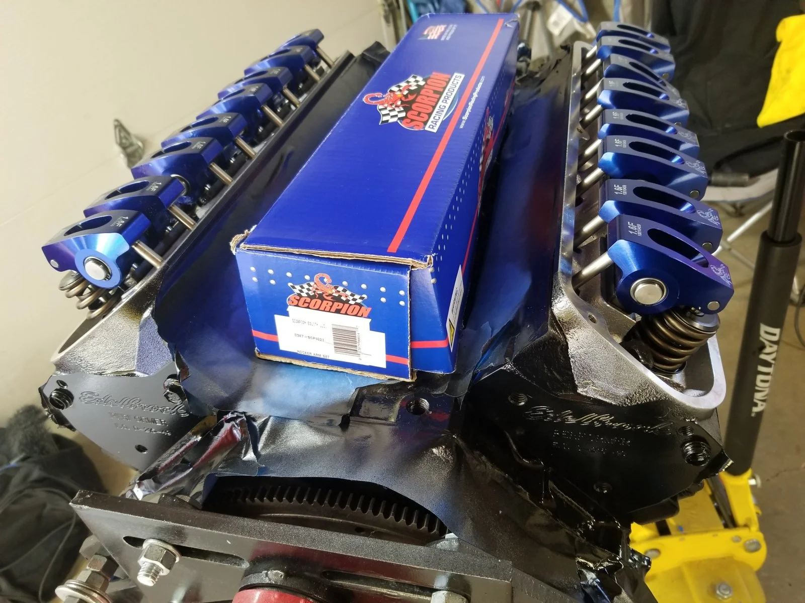

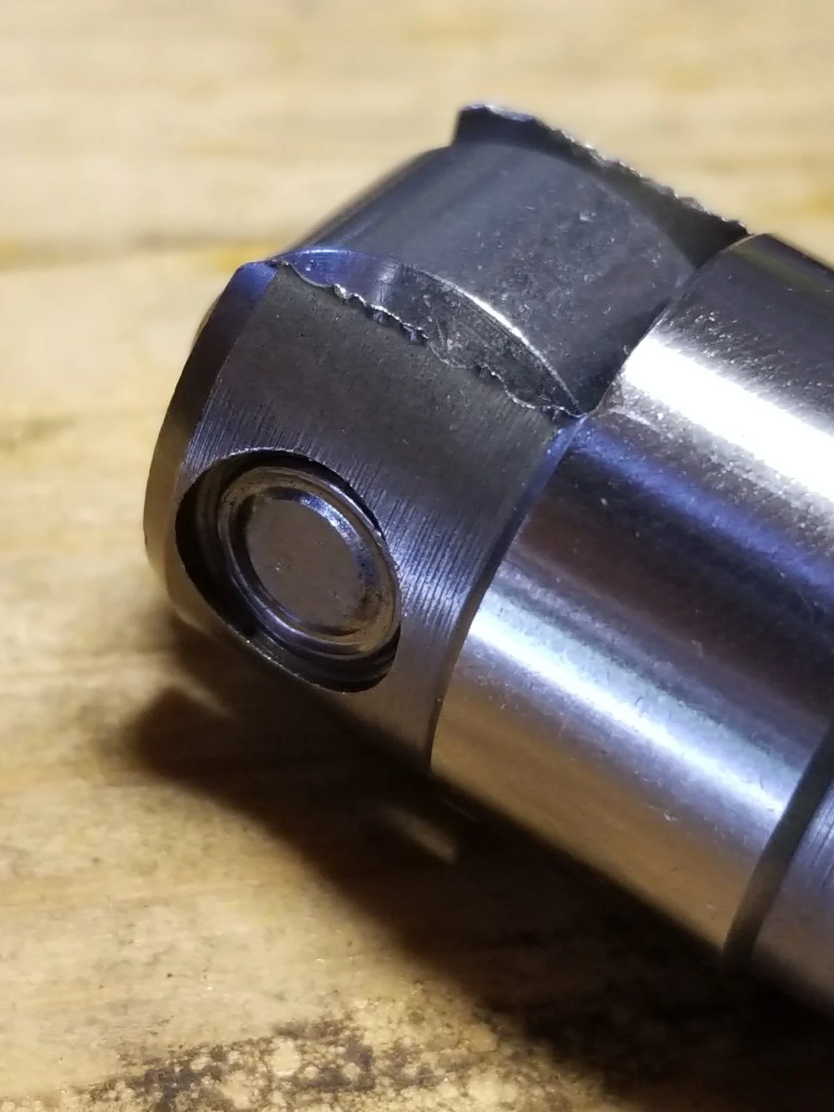

Hey buddy im doing the same build right now. I installed those heads with a e303 cam ,ford performance rods and lifters and scorpion 1.6 rockers. I would not ever go with ford racing high performance lifters ever again
See photo as i just needed to crack the motor open again and replace a bad brand new lifter. The picture is the new replacement and i will not installl it. Looking down a different ave. Also you could reuse all you stock parts but recommend replacing pushrods with new.

Very nice Eddie, thanks for the info. I haven’t pulled the engine out yet, but when I do I will post some pics. This forum is great, and the knowledge that some members have is great! Keep me posted as I will do the same bud! Thanks again
Nice buddy , clean those puppies up and will look nice. I would recommend all fel pro gaskets. Keep us updated. Im having a hard rime setting the idel on my e303 . What do you have for a cam? I used oven cleaner on an old set and it cleaned the hell out of them. Powerfull stuff . Dont breath it in ..
I haven’t picked a cam yet since I don’t know what springs I have. I have to test them then I will know if I can use roller, or flat tappet lifters. I will update when I take it to the machine shop. Good luck on setting the idle on the e-303.
