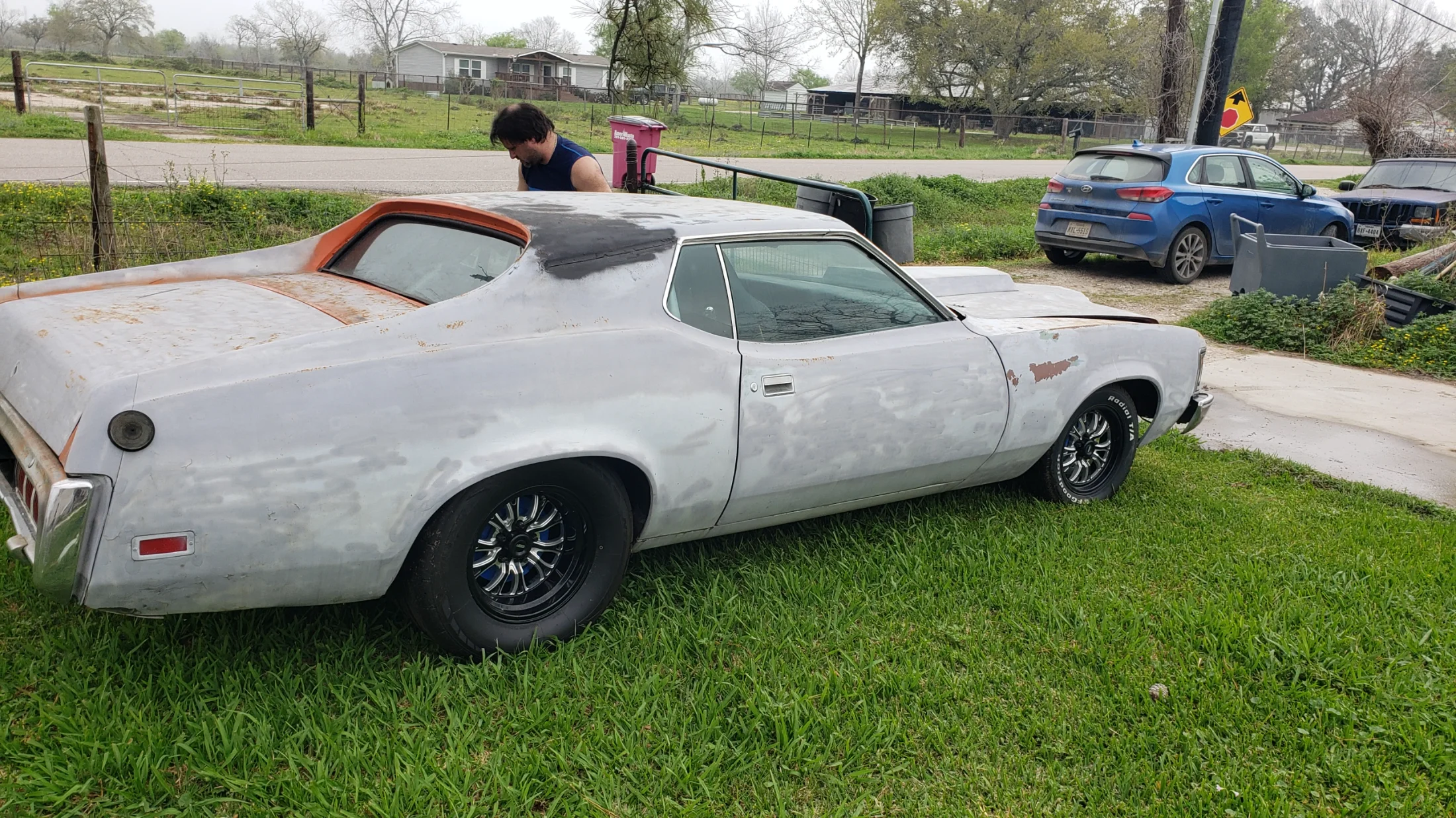

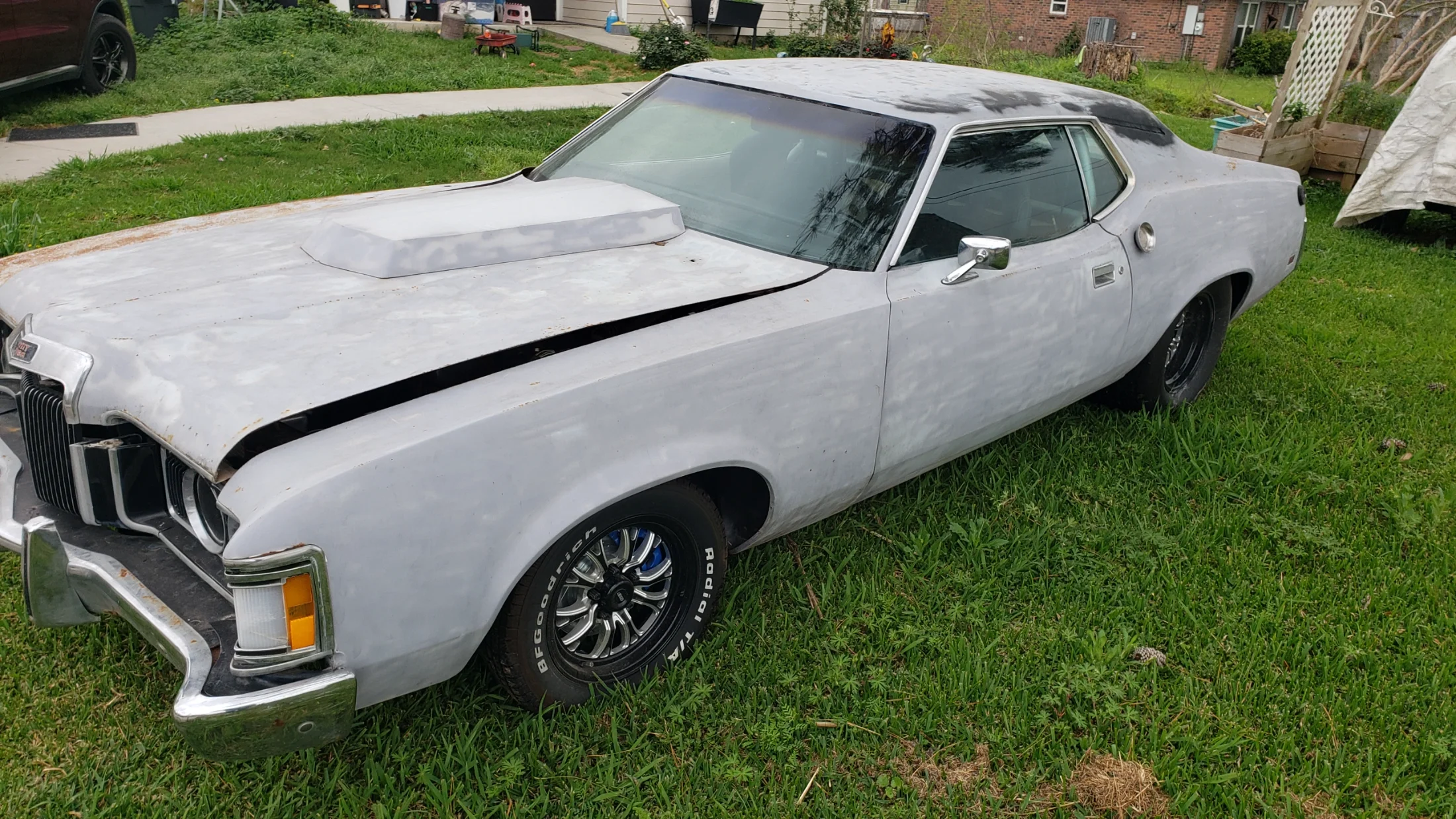

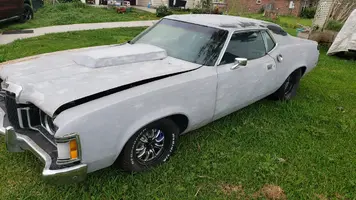

OK completely new to this old computer I acquired a 1973 cougar with a home made fuel injection system on it and I know nothing about it but this is running it or was . its got a built 351 C Weiand manifold with bungs welded in for injectors a plemin from a truck (Snorkel) 2 giant throttle bodies and a big mass air flow. I had it running and driving went to move now no fuel pump or ignition I can jump pump so its good but have no clue what happened . any help will be greatly appreciated or even what and how to up grade that's budget friendly as I am retired. even if I went back to a carb
this this was built as a drag car I am using as street rod forgot to mention its got a fogger on it but its not being used , narrowed 9 inch ,3 link hi flow fuel pump, roll bar and more !
thanks in advance

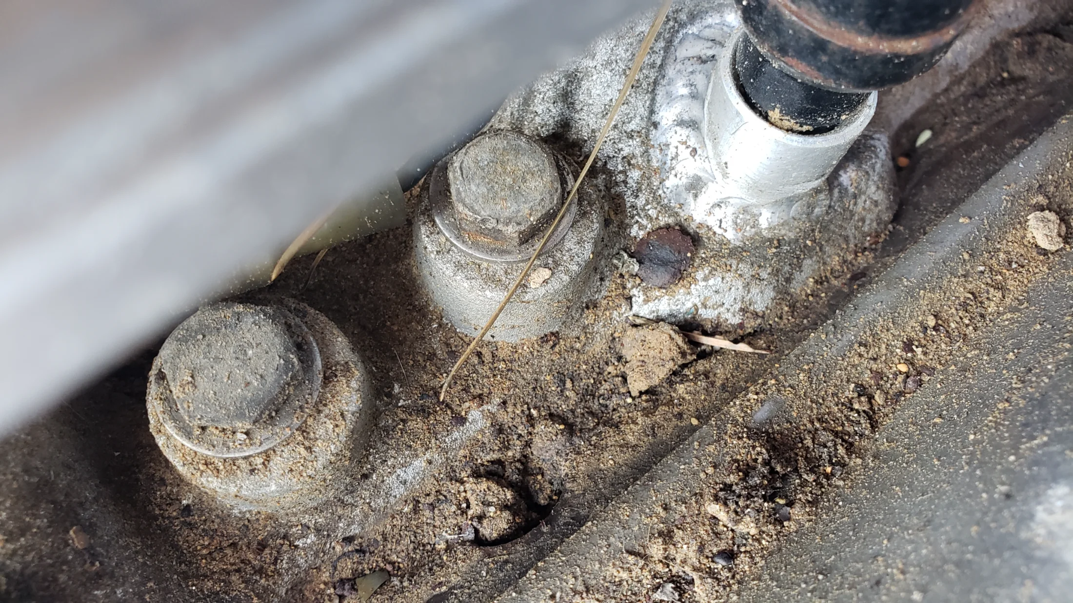

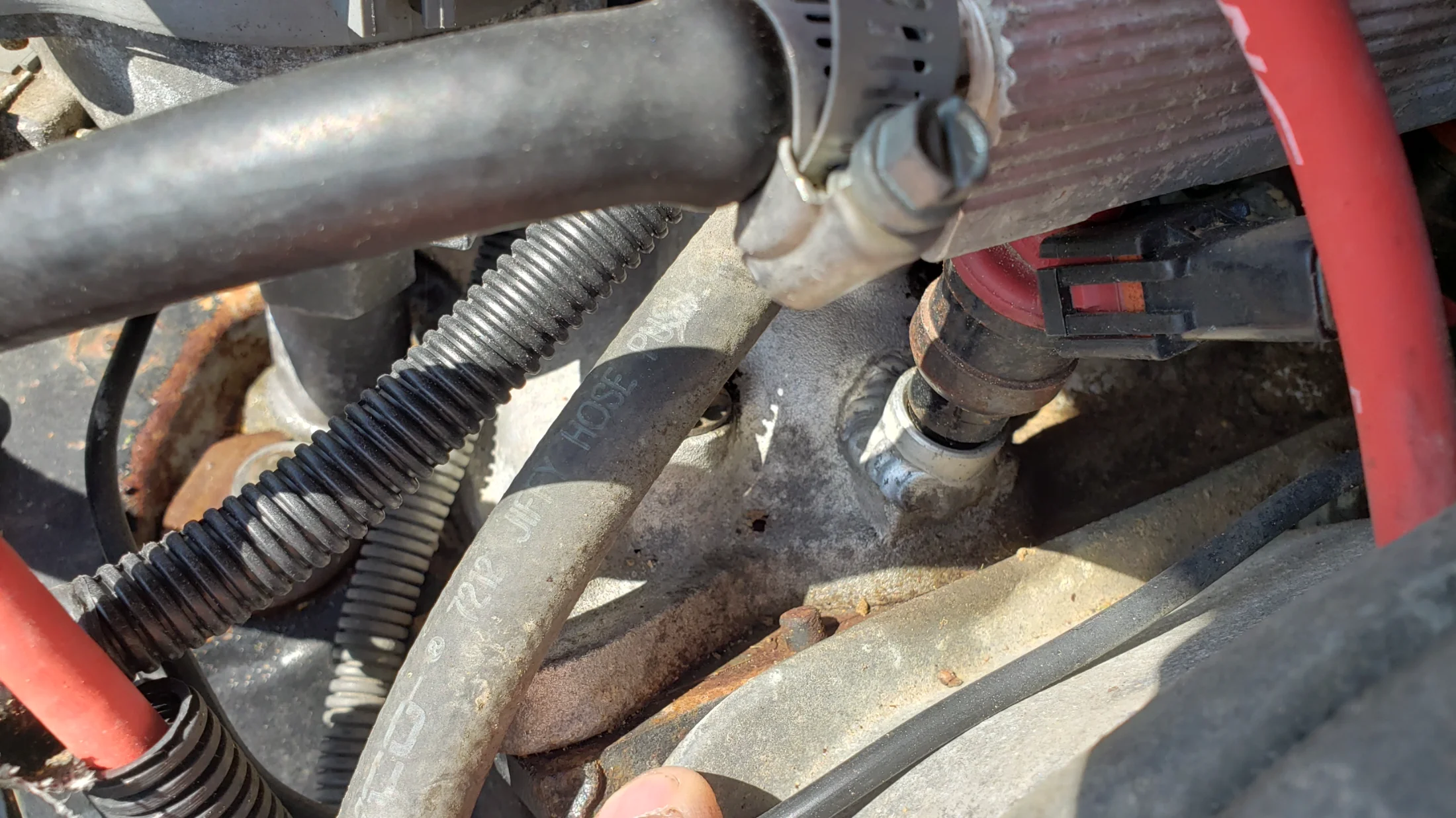

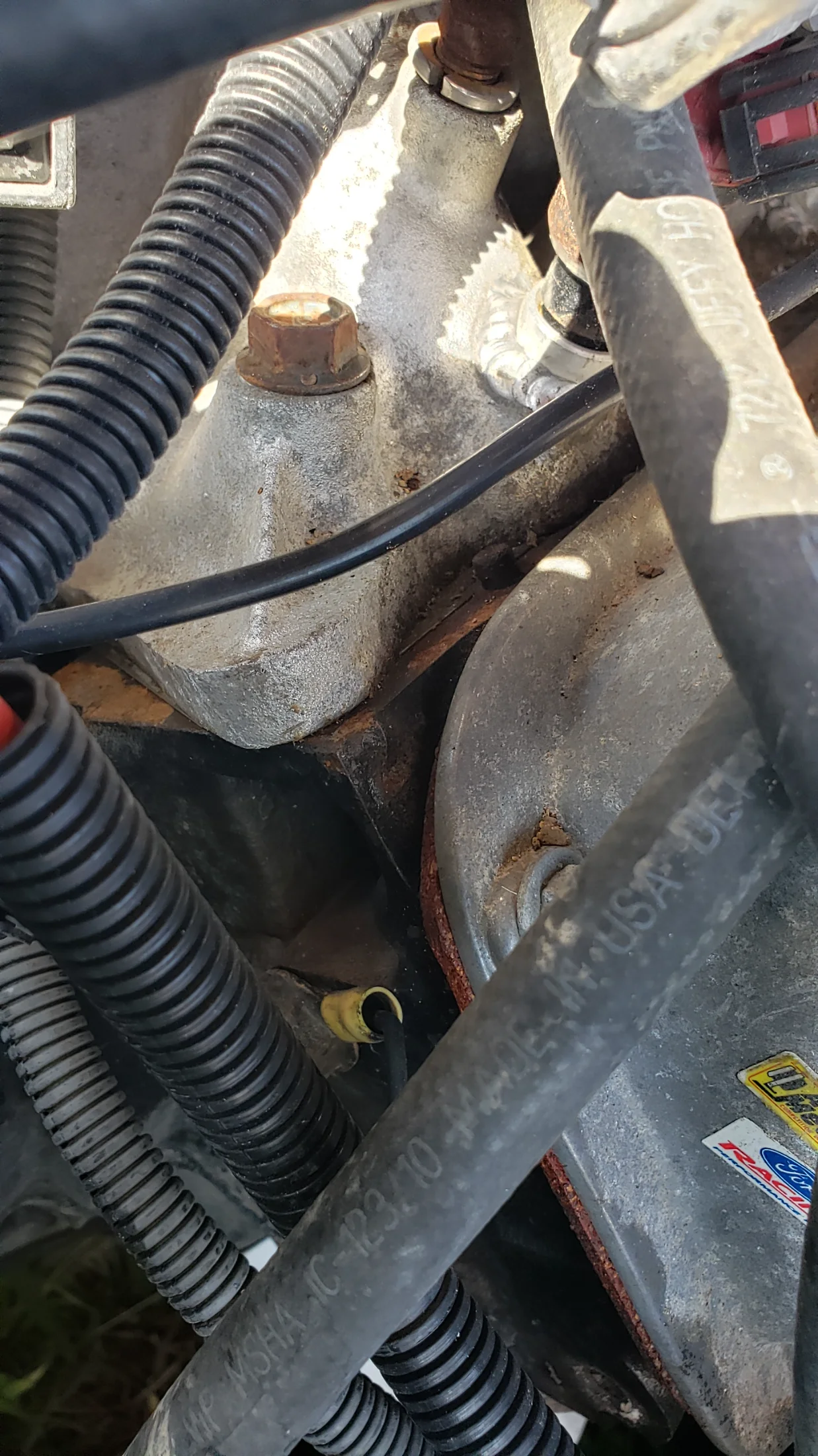

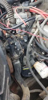

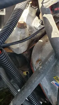

here is a start on pictures and yes its definitely a home made system as I can load them

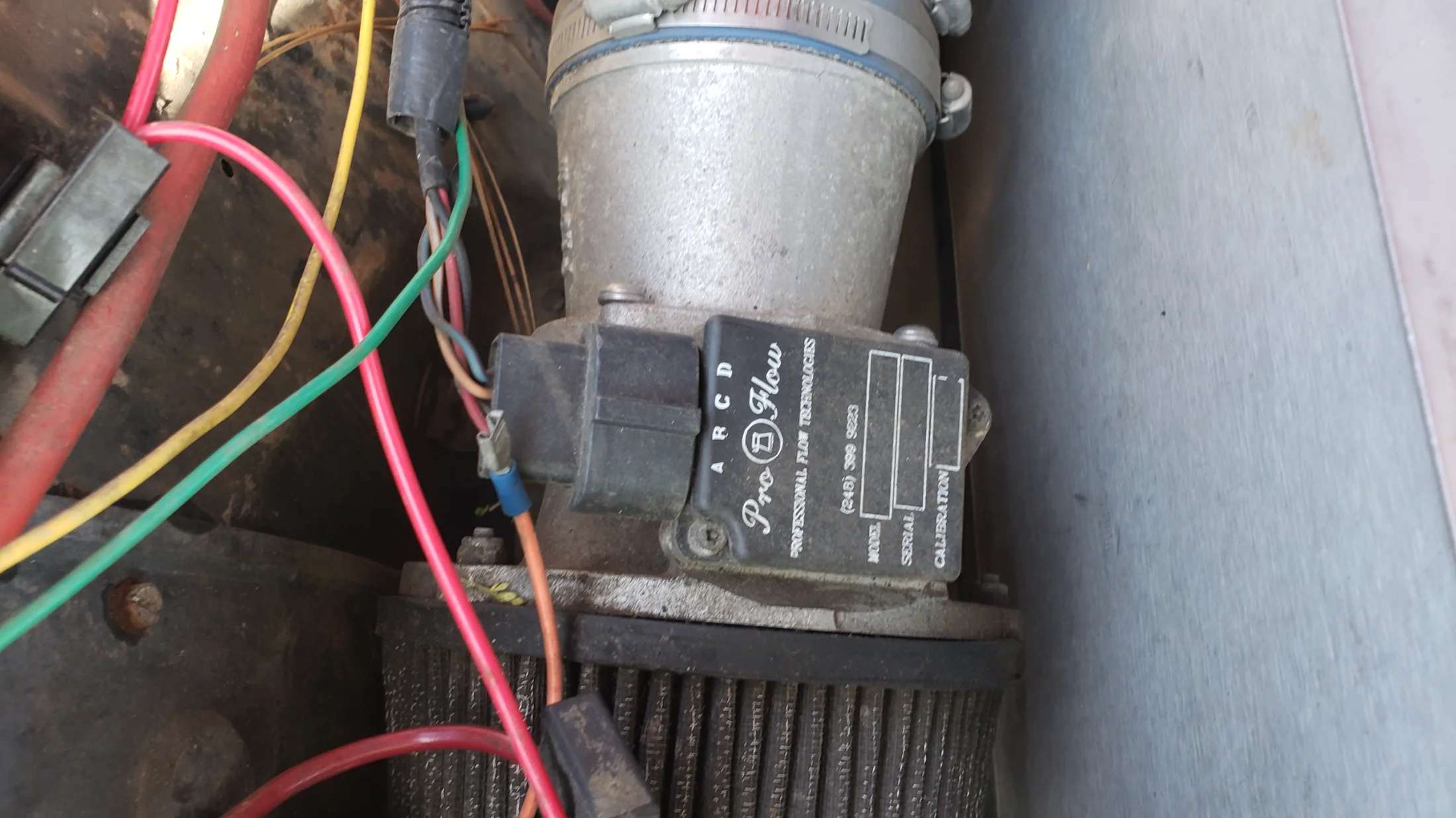

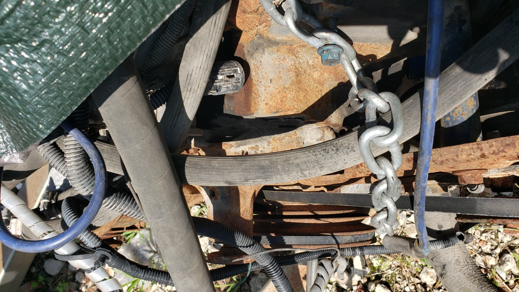

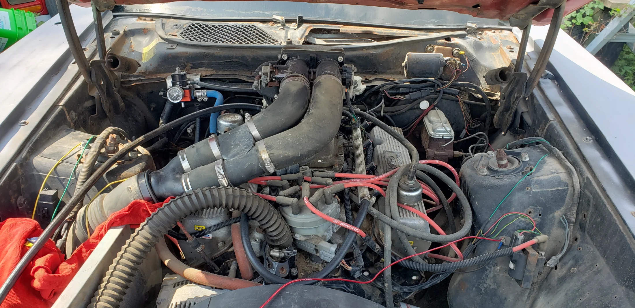

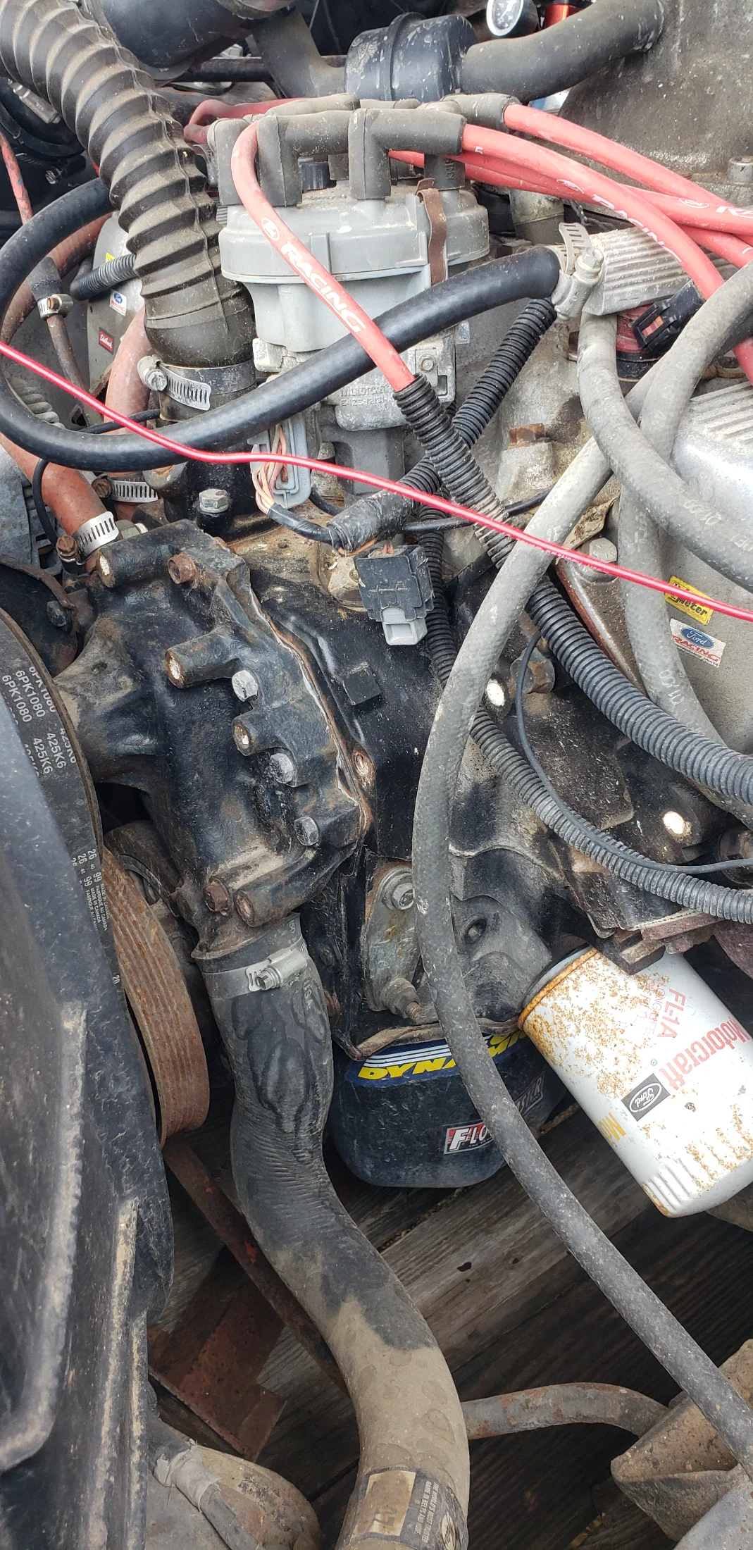

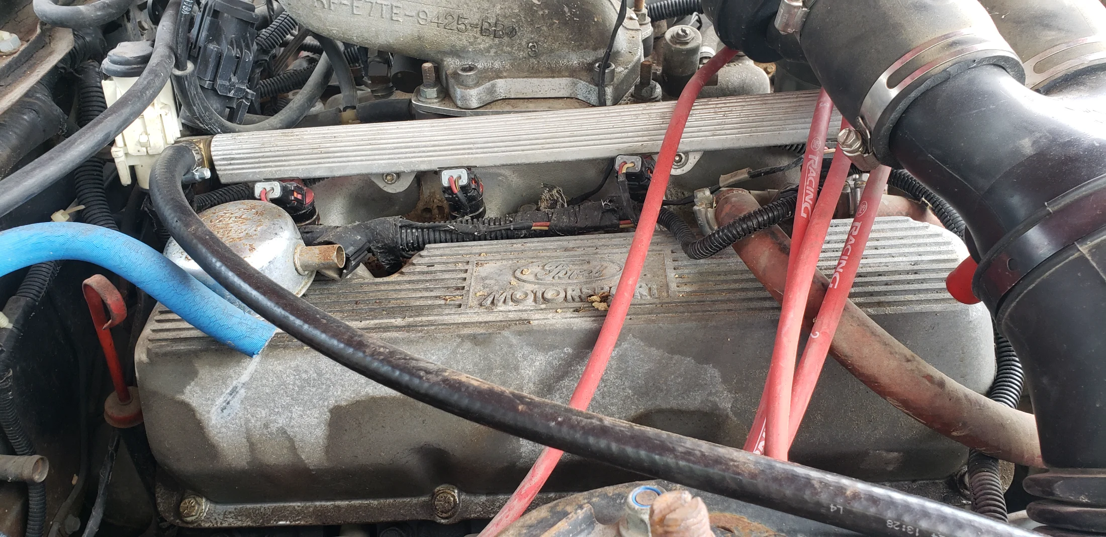

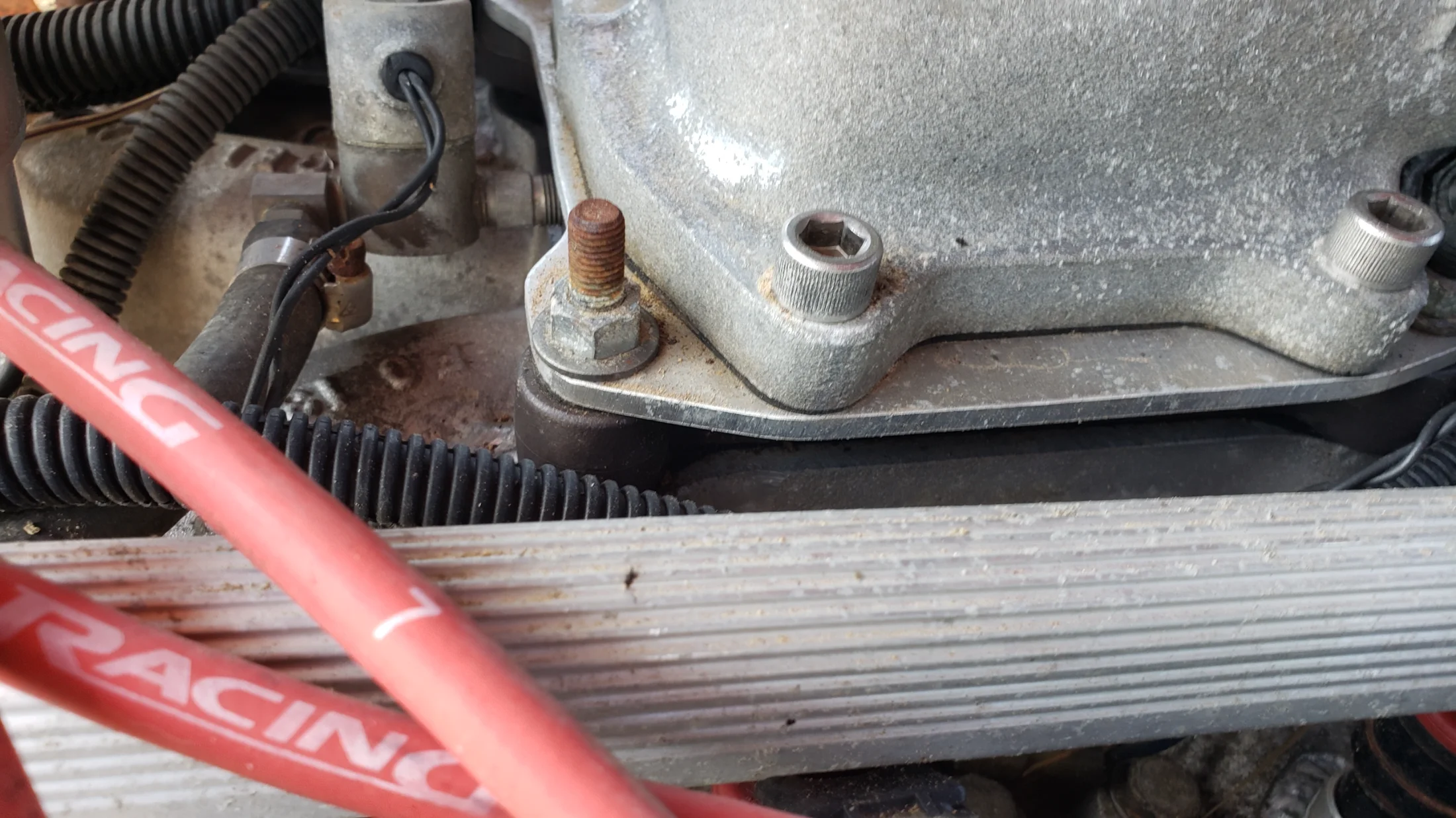

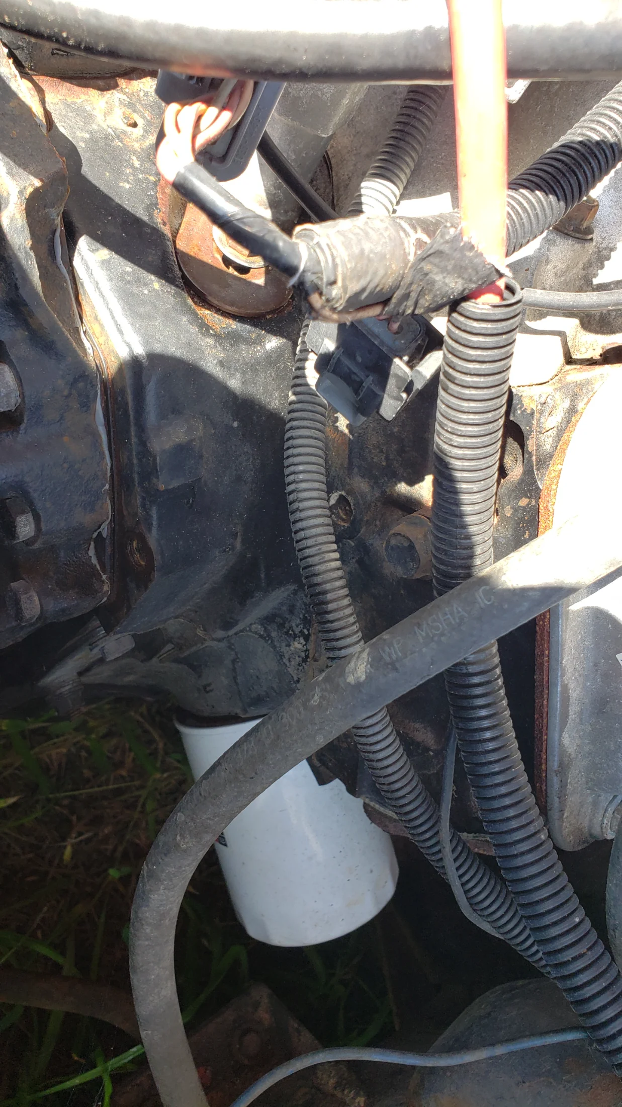

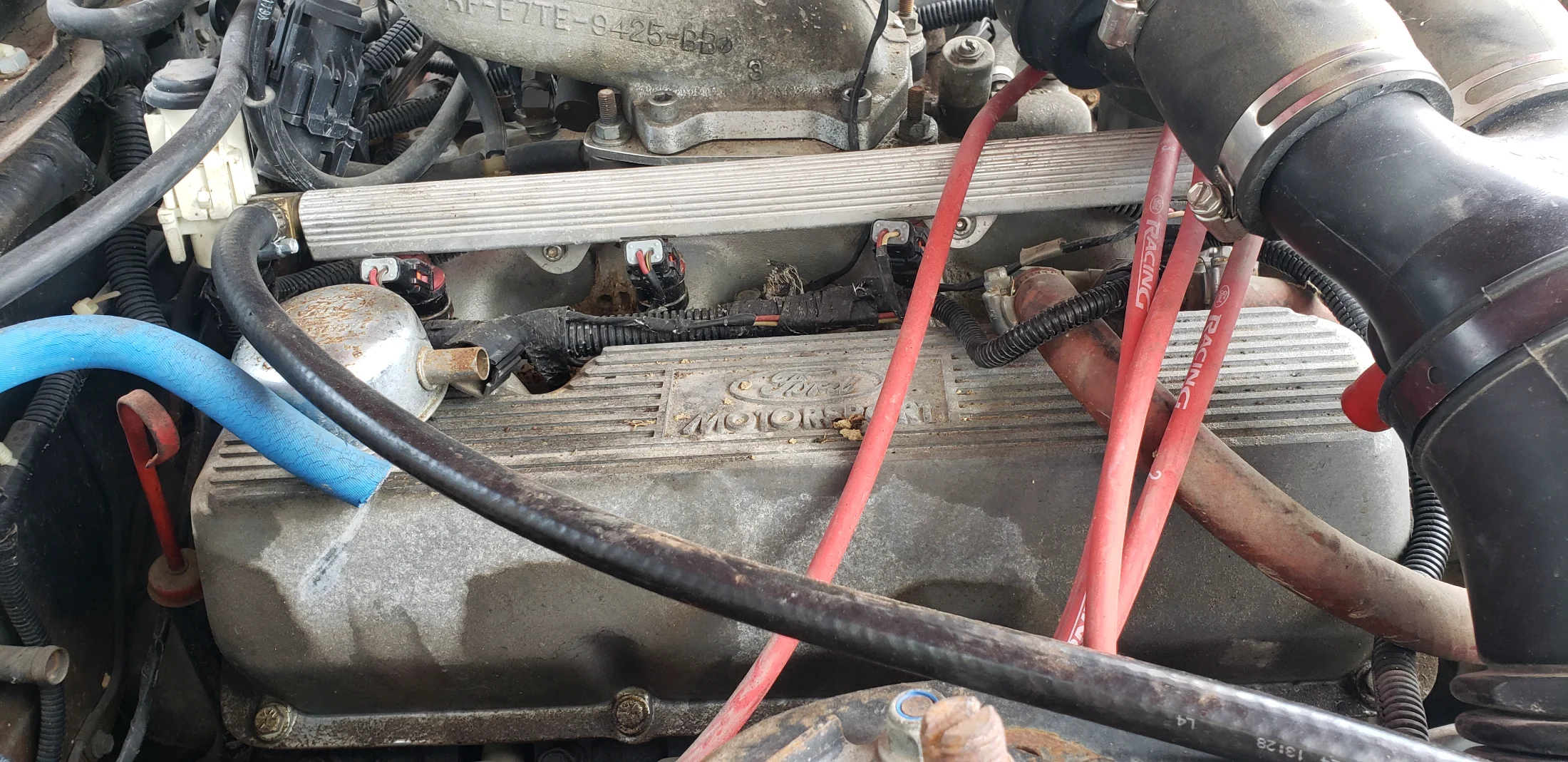

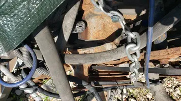

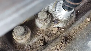

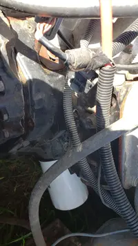

Here is some of motor if you need anything closer I can get them it's just outside

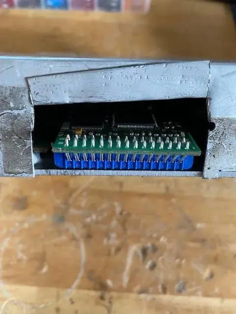

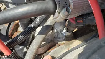

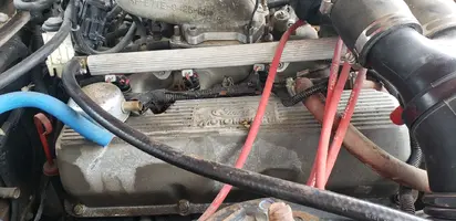

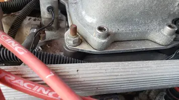

This is close up

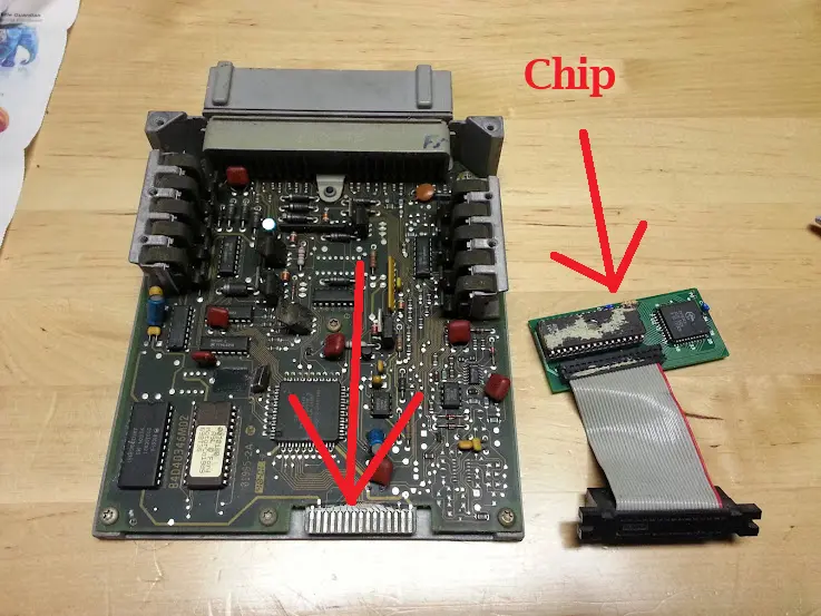

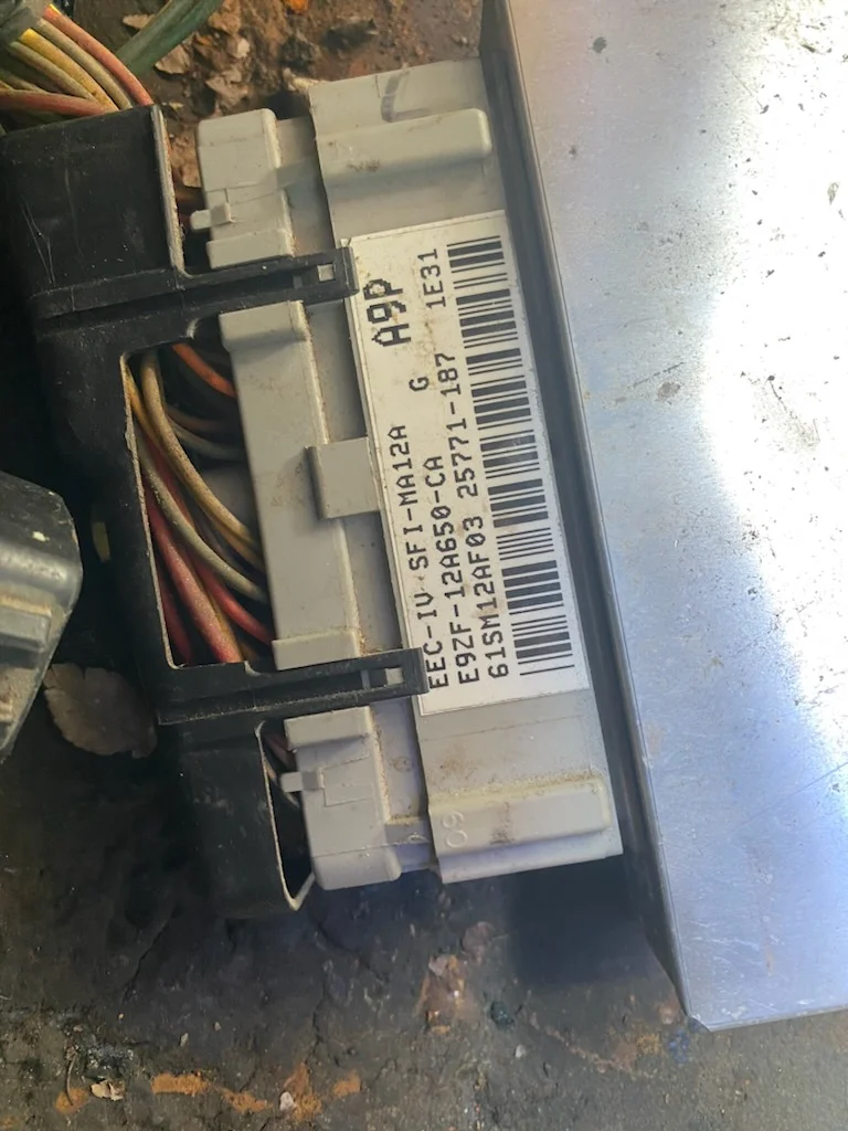

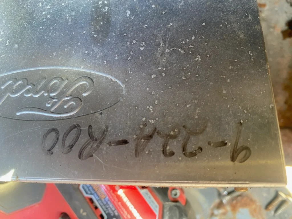

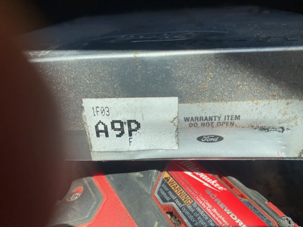

What you have in an A9P EEC-IV from an 89+ Mustang with a 302 and automatic.
This EEC is [not] going to work for your 351 without chip-tuning.
I am sure it was tuned it was running fine then we went to move it and now nothing no fuel or fire like a blown fuse or something not sure were the power comes from if I new what powered computer I can trace it back . it will turn over and I can make fuel pump run

I'll give you my 'old man' advice, if your gonna keep this junk then start with the wiring, bare wire stuck into a spade connector is not a dependable attempt at a repair, make sure all the grounds for the stock computer wiring is attached good and not stacked all in one spot, typical DYI mistake, don't add any extra grounds either.
