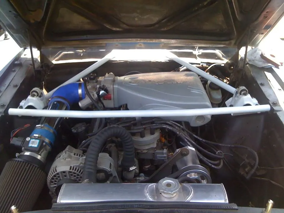

Long story short, i wanted a good shock tower support. After converting to EFI i ended up removing the original stamped-style bars (they didnt clear the intake). After much debate ...and some saving, i decided on the Maier bar as it advertised to be EFI friendly.
I'm sure it might be, for the stock efi intake, but not for mine! So, i ended up cutting up my brand new (very solidly built) toy and moving the driverside bar outwards.
Had to remove one of the hinge springs+ arm to make it clear(not pictured). Its a tight squeeze with powerbrakes+ booster + larger intake !
Anyways, just posting incase someone in the future comes accross this issue

Nice install, I had to do something very similar to make mine fit my GT40 intake.
Off topic, but what CAI did you use? I have not been able to find one from a 5.0 that would fit between the towers and have been using the stock rubber elbow.

Just in case you start having any of the same issues I had...you may want to build a box around your air filter. Prop wash from the fan on the alternator gave me terrible idle surge until I enclosed the air filter.
It also lowered my intake temperatures pretty drastically.
Thanks again
