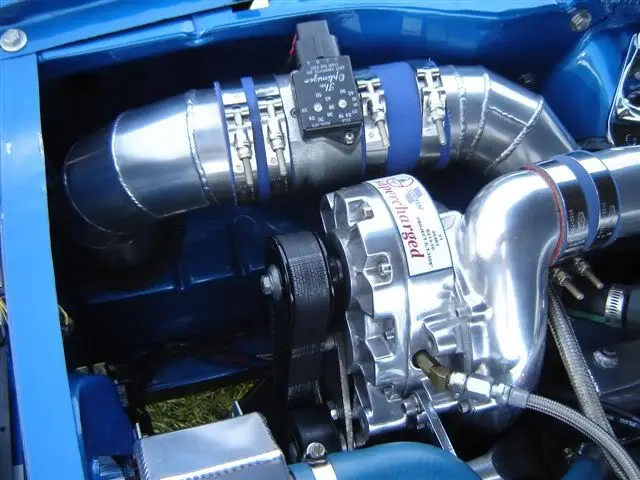

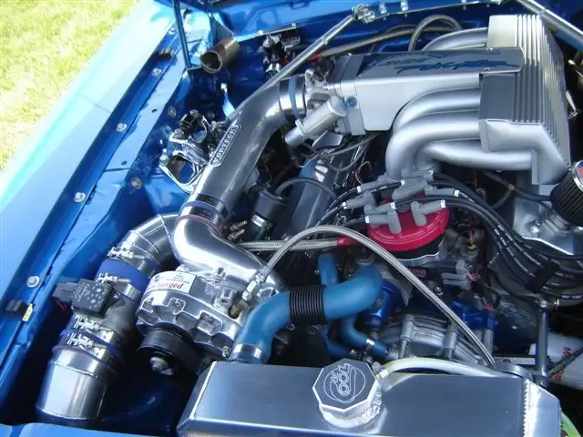

FYI - this option would have made the discharge to high to close the hood on my '65 with the Paxton. I hope it works out for you, but check carefully before you assume the problem is solved.
I moved the discharge tube closer to the top and it just barely touches the hood on the silicon connectors. I just asked my wife for 1/2" drop Ron Morris motor mounts for Christmas. I think it would be fine as it is but I also have my throttle body just barely touching the hood (under the hood scoop) and this would correct both problems.

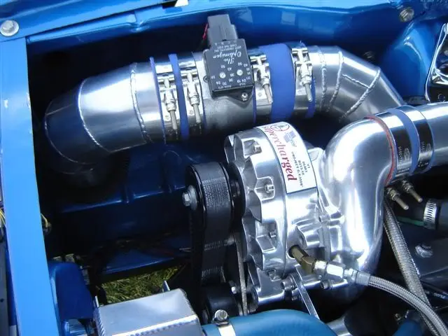

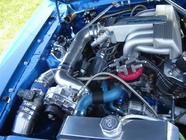

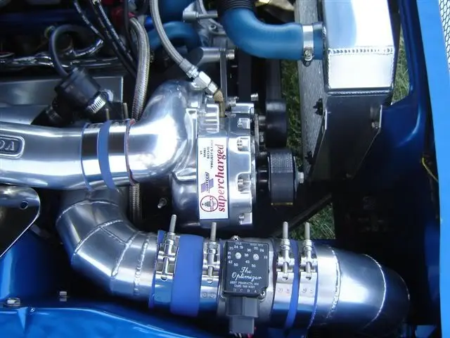

Here's a couple of shots that may help (note this is a first gen).
BTW, not my car, just one at a car show where a friend took pictures.
