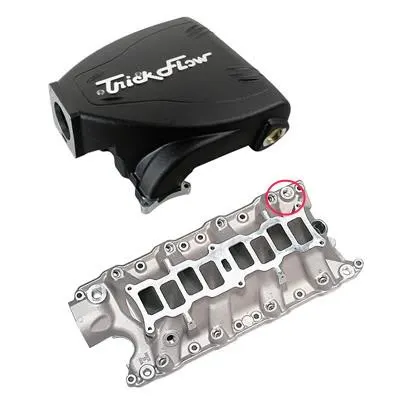

I know this has been covered a lot, but I am trying to figure out what parts I need to put back on my car.
I have an off road h pipe.
I have a BBK TB with EGR spacer.
I am not planning on reinstalling my smog pump and thermo lines that go to the back of the heads.
I don't mind reinstalling the EGR valve really as long as it still works, but I'm confused about the routing.
I have a heater hose nipple threaded into the npt hole in the lower intake manifold at the location circled in red in the image below. I believe that is the line that goes to the firewall side of the EGR spacer.
My question is where does the coolant line coming off of the front side of the EGR spacer go?

it comes off of the black hard line that bolts down on the passenger side of the intake, don't knowwhat its called, comes off water pump and runs back to heater core connections.
