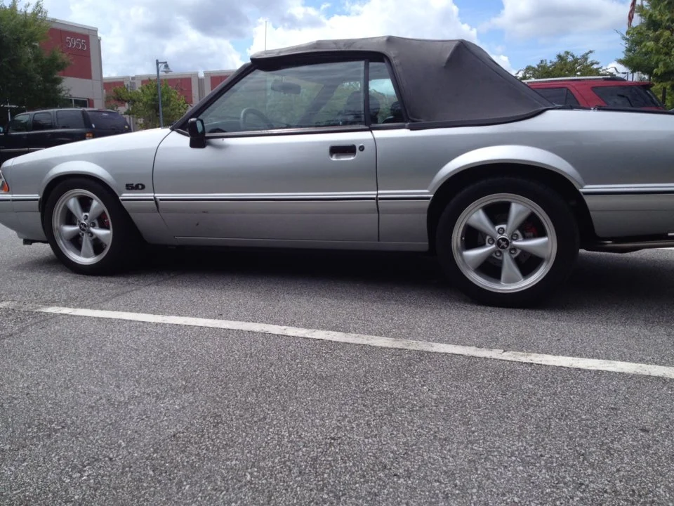

I just ran out and took this one in the parking lot real quick. Excuse the fact that the car is filthy. Weather has been crappy lately.
You can see how nice it dropped in the front but the rear didn't drop hardly at all. I'm pretty bummed after all that work.:(

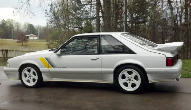

It does have a nice rake huh? Still looks good though. I once used the Pro kit on my '89 SSC. It sat very similar to yours and was also high in the rear. Not as high as yours so I left it.

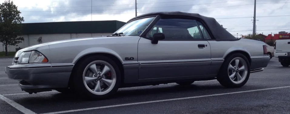

Well, I was able to get the stance a little more dialed in over the weekend. It looks much better. I think anyway. It should "settle" a bit more over time.
I ended up removing the upper and lower isolators and just wrapping the ends of the springs with a couple of layers of electrical tape. Just to keep it from being metal on metal. I also removed the quad shocks. I installed new ones but I really think they were "bottoming out" and not letting the rear end travel correctly. I also loosened the UCA and LCA, preloaded the rear end and then tightened everything back up.
