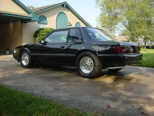

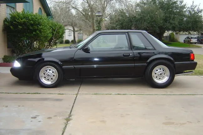

i dont why people say that the springs raise the car, i ran the drag springs in my old coupe and it sat nice and low,
here are some pics
Never was able to take to the track but it hooked pretty good on the street

I ran the Eibach kit at one time and it lowered my car on all 4 corners, the worst thing to do is cut them since they are made to be that height.
here are some pics
The stance on that car is nothing short of amazing.:nice:
