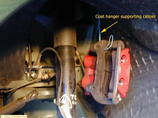

After you remove the calipers (2 bolts), hang them with some wire.
http://www.fnsweet.com/garage/lt_install/index.shtml
