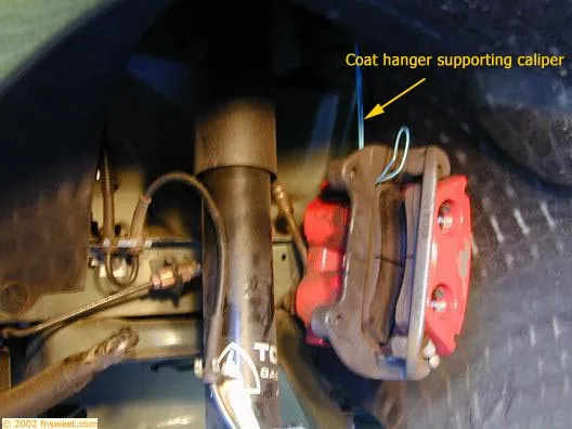

I hung my calipers like shown above. And took my original springs out without a compressor but was careful.

Use a jack to lift the control arm, and slowly lower it.
After you remove the calipers (2 bolts), hang them with some wire.
http://www.fnsweet.com/garage/lt_install/index.shtml
that looks like a Bullitt to me.
