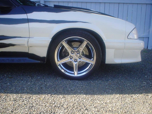

The front has NO clearance b/t the tire and the fenderwell, you can't stick your hand in there, the ride quality isn't the greatest, but it looks BADASS, and the handling is great, hopefully subframes will help with the bouncing/rattling (i'll get back to you on that)
It lowered my front an 1.5" but the back sits higher, even with the battery in the back. But mine is a 87 coupe though. I can fit 245/45/17s all around, but up front they rub at turn. I did get some bumpsteer so I had to change the outer rods to the Steeda bumpsteer kit. The 90's and up got the revisions to reduce bumpsteer so those years might not have a problem.The ride quality didnt change either. Its still scary on turns at high speeds, its probably because I still run the stock shocks. Just waiting to get some money to throw Konis on........
