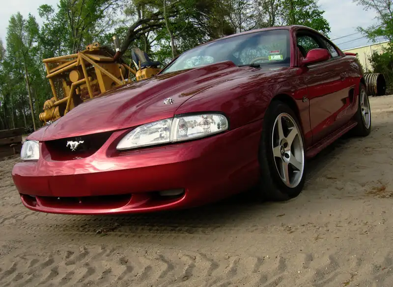

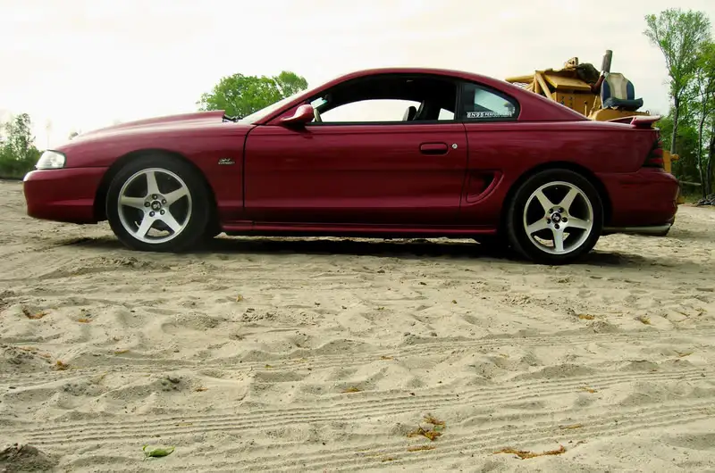

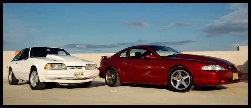

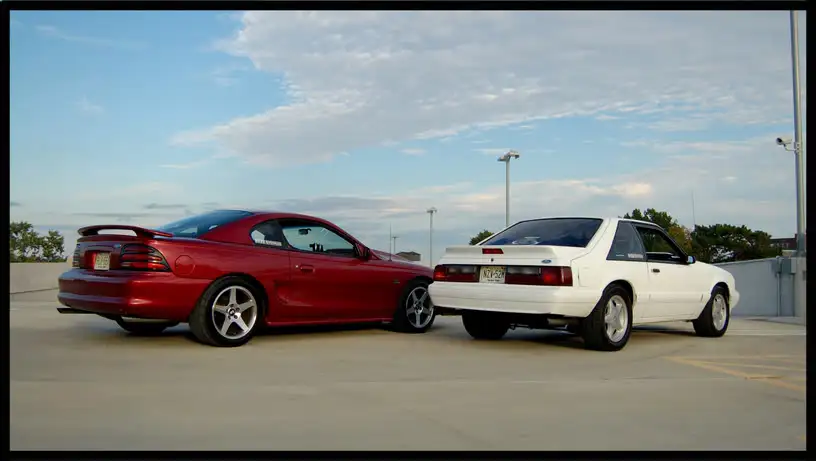

Mines lowered with Sportlines, KYB GR2's, and Maximum Motorsport c/c plates. You NEED the c/c plates with pretty much anything over an inch drop. I learned the hard way, and went thru a set of front tires before I got smart.
+1. so many people lower their cars w/o cc plates....and some get away with it. i think its definetly worth the extra money to get plates to prevent a potential problem. one set of cc plates is much cheaper than several sets of tires.
dont do what i did and buy cheap plates. go with maximum motorsports or something of the same caliber. i went with new steel 3 bolt upr "shark" plates. they get the job done and made for good alignment but they are very noisy.

So .. the sportlines look ALOT better but you will scrape everywhere...at least I would.
