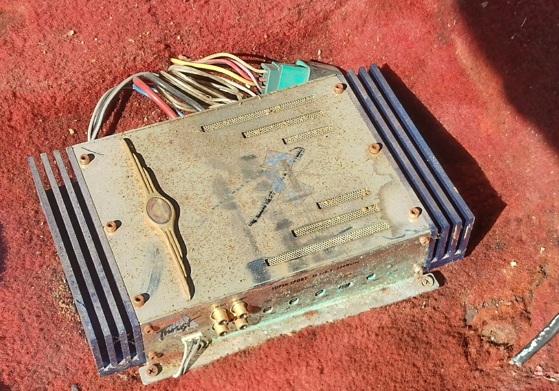

Found this, looks pretty corroded

3rdelke said:
I'll check them out.
That’s an aftermarket Audio amp. X
No that link just wouldn’t make it charge . Sounds like you have no power coming I to the fuse box which comes from the branch of yellow wires

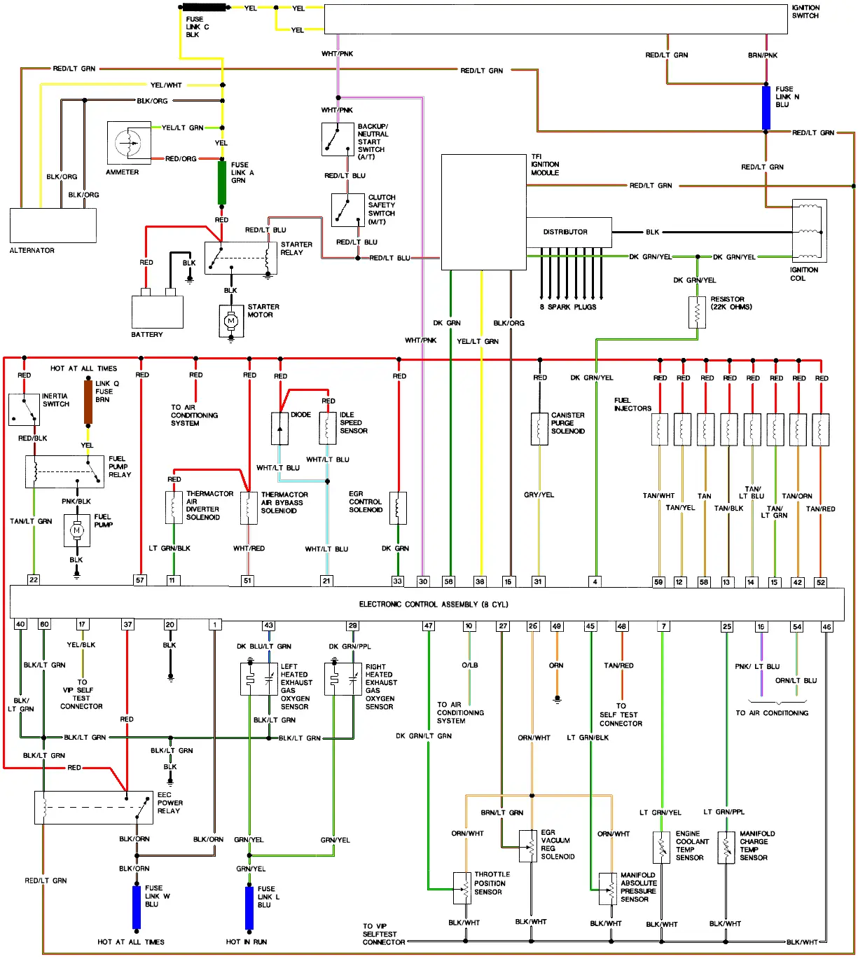

http://www.veryuseful.com/mustang/tech/engine/images/Mustang-86-Mustang-ECC-EFI.gif

If you look at the diagram . Fuse link “c” which is in the yellow wires I mentioned that you say you believe is blown is basically the power to everything toward making your starter relay work . I’d replace it if you tested it and it’s no good .

I worked on it today. I tested all the fusible links, they all tested good but there might be a possibility the wire to alternator may be faulty. The two yellow wires that provide power at the ignition switch show no current at the ignition switch, but test hot below solenoid. Thx for any insight.
I hear what you’re saying but The only thing between that ignition switch that would stop power unless those wires were cut is the fusible link there .
