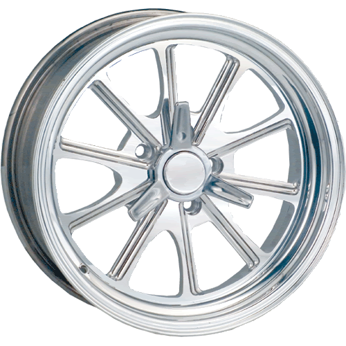

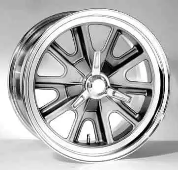

In the same class as the Ultra 454 there's also the Coys C67:
the Vintage Wheel Works 60:
and the American Racing Cobra 427 (painted) and 427P (polished):
There are also the high dollar Cobra kit car Hallibrand style rims, from PS Engineering, Team III, Compomotive, and others.
So there are lots of options with that same look.

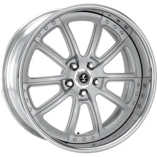

If had a choice to do it over I'd go with these from the UK Image.
(Any 454 buyers/takers.......)

thoes are awesome where are they i could not find any uk image.. let me knwo may be a link

Its better than $1600ea for these American Racing or over $700ea for the Foose or Billet Vintiques. Of the various Eleanor wheels PSE Wheel vintiques Halibrand Team III ETC ETC they are a fair price.
