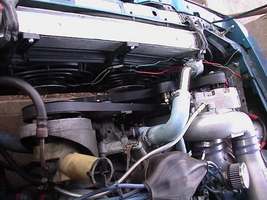

I have the 210 dual flex fan in my cAr. I paid $225 for it. I installed the fan in about two hours. No leaks, no vibrations, complete kit with an adjustable t-stat. So far so good. No complaints.
