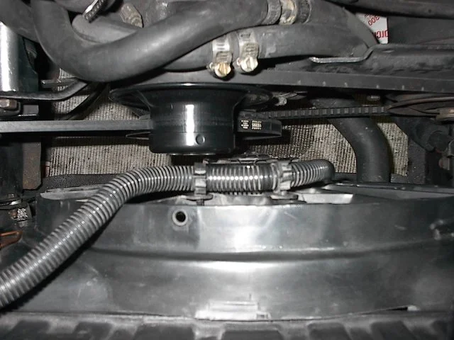

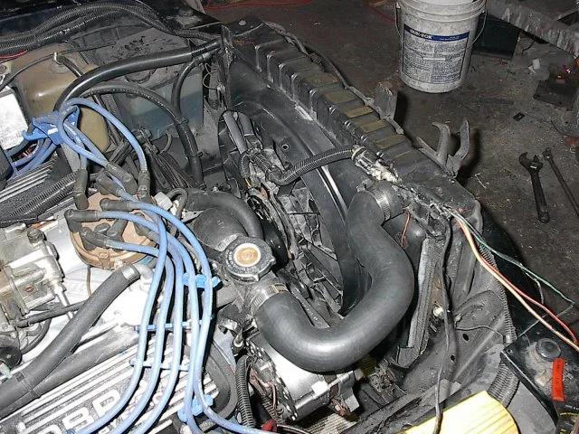

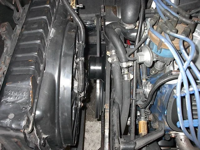

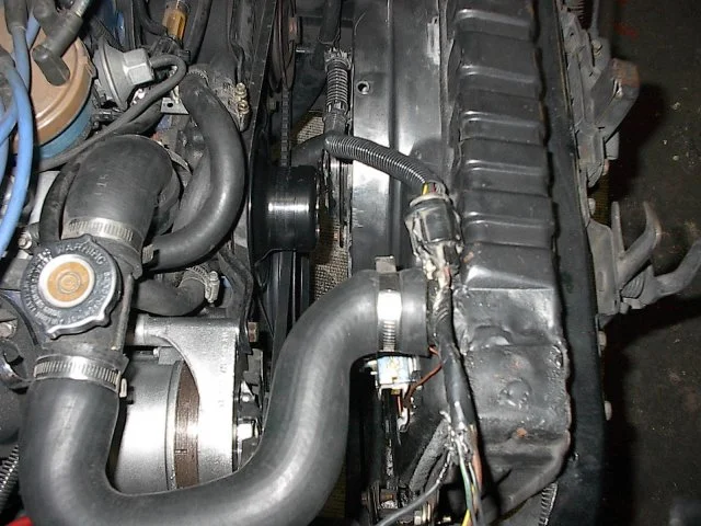

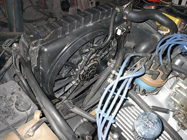

Take in mind I had to cut a half inch of the built-in shroud's depth off of the one side, and cut the "nub" off the water pump. This is also the 75-76 short pump....
You will need a temp control and a HEAVY DUTY relay to work this fan. Make no 2 ways about it. And the cheap 20-30 amp relay is not what I am talking about! The fan has some serious current draw! It is a two speed fan low and holy $hit! I just about got messed up the first time I tried the high speed setting on the bench. It about pulled my loose fitting shirt into the fan.
Here is an article that shows some of the parts # of the exrta parts they used. I went a slightly different way but I did spend the bucks on the Bosch relay.
Here you go. Good luck.
