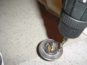

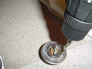

That is exactly what I was planning on doing but I've received some negative feedback with the idea regarding the pump. I am using a 160 degree thermostat. I wanted both the electric fan and pump to be connected to an "always on" relay. The pump would be activated by a thermostat switch in the intake's water jacket to come on at about 180 degrees. The fan would come on shortly after than at around 190. Both would run once the engine was oss and the key was removed until the engine cooled to the point where the automagic switches would shut them off, no heat-sink for me. This is what I had been planning on doing. But I've been told that you must have "some" water circulation at all times to avoid steam pockets in the heads. This can happen long before the 160 degree thermostat opens too.
There are a few tech articles on Meziere's website that describe this phenomenon and I found one article that indicates that the best thing to do is drill two to four small holes into the thermostat flange to allow "some" water to bypass. See this photo found on an AHEM COUGH LS1 info forum:
