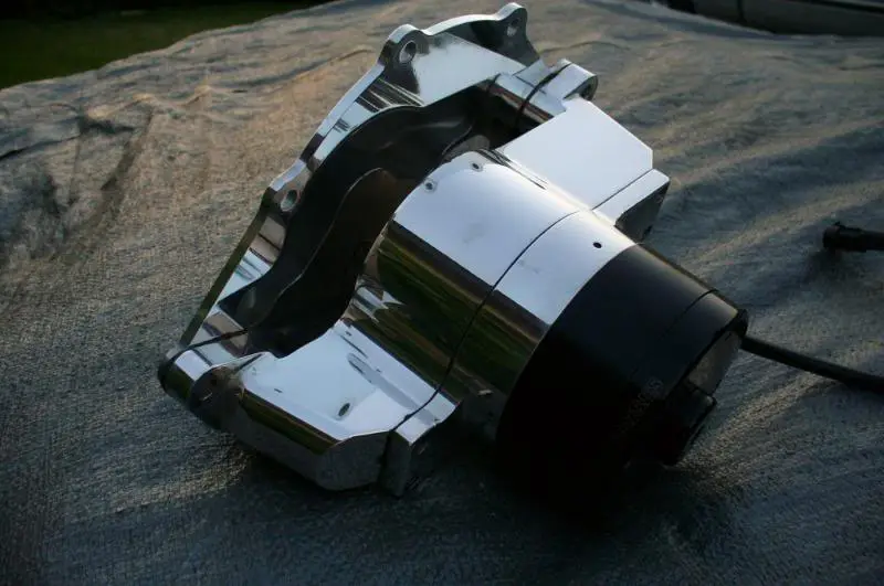

The Meizere 55 gpm pump has provisions for the heater hoses,the 35 gpm pump does not.
35 gpm pump

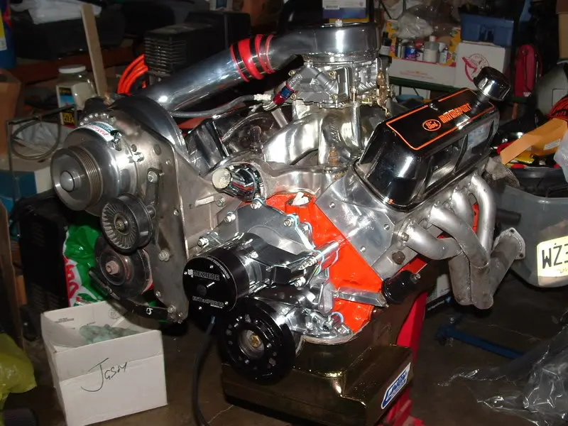

I have the 55 gpm pump but dont have a pic right now. I will get one
That's the street pump, 55gpm. Ive had it for quite a few yrs now and works great. Love it at the drags with an electric fan, cool down between rounds not an issue. :) Hit the burnout box at 120 degrees every time. You can see the heater outlet on it but its plugged.
