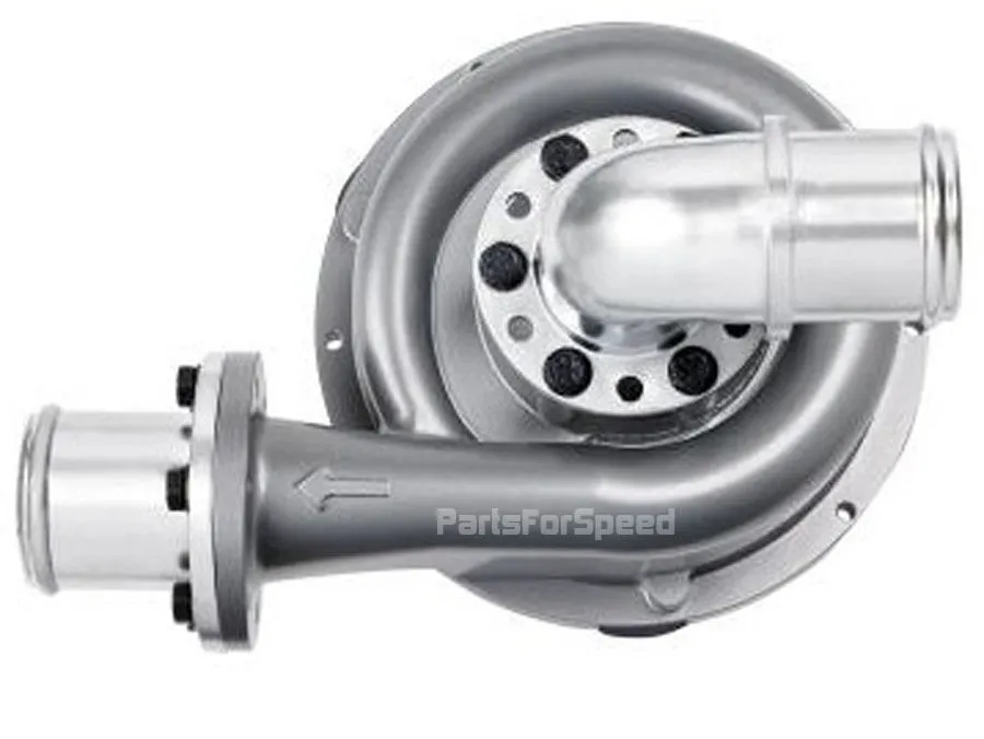

still not shure about that Electric WP stuff ..found this... does anyone run this pump or can I run the mechanical and this electric additional, to cool down engine after race ..this pump can be mounted in the lower hose .. ??maybe affects flow when just running mechanical pump..?
Davies Craig 8005 Electric Water Pump 80l/minute

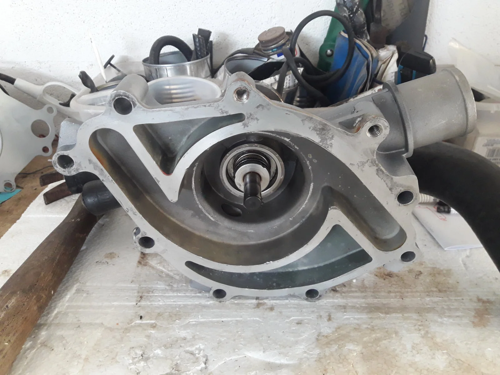

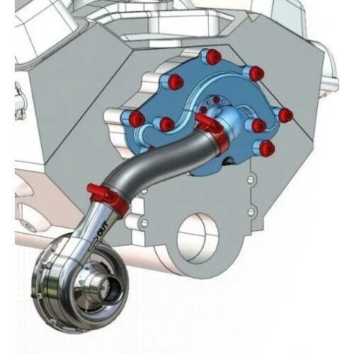

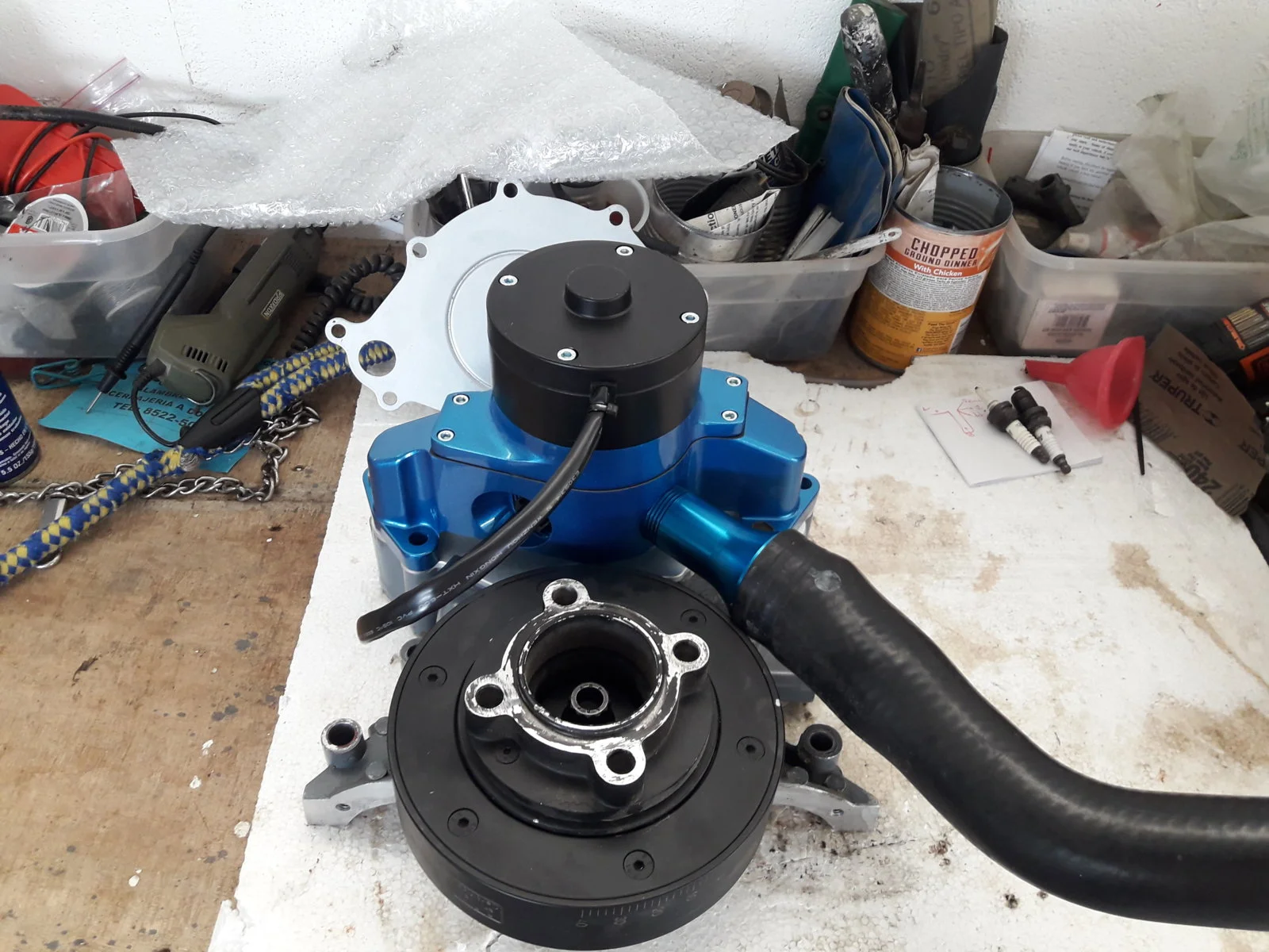

I think I know wich way Ill try to go with the new cooling system... I will install a Davies Craig Remote Water Pump (130 Lt/min) into the lower Hose from Radiator with a old WP I had, but "empty" so I can use reuse the Belt and I dont have to buy the DC Block Plate (100$). keeps the original look but without Power loss from mecanical Pump .. should be good for my 331..??!! I also have the Proform Pump here ..looks nice and clean... and comes with all you need to install ..

Still thinking on this I see.. Removing the W.P. impeller would likely work. The article posted above advertises 80l/Min, or about 21 GPM(?)). 120l/min is about 31GPM.

Keep in mind the coolant flow direction varies in different engines. Not sure of your specifics, & you may already realize this, but If your Foxbody motor has a serpentine belt, then your water pump is a reverse rotation type (same direction as the Crank pulley). The V-belt equipped Mustangs have standard rotation water pumps. Just be certain the electric pump circulates coolant as it did, to avoid any potential issues. Good luck!
Yes, that’s correct. The direction the mech.pump’s pulley rotates with no impeller installed makes absolutely no difference, whatsoever. It’s now a belt routing idler. As worded, i’d left the comment open for accidental misinterpretation. My bad. So, simplified, verify the Coolant flow is going in the same direction with the electric pump, as it was with the previous mechanically driven pump. Inline Electric pumps are mass produced for multiple app’s, and many capable of running equally effective in either direction.
I’ve installed both bolt on, and remote electric pumps, in-line pumps, some w/arrows cast-in indicating flow being a certain direction, I’d encountered a couple electrically driven pumps that were actually rotating the opposite direction than the arrows indicated. Just wanted to convey that. Unlikely, but worth mentioning. Since they are basic DC motors, isolated from direct ground, reversing rotation is simply inverting the (2) input wires at the plug.
In addition, by using the Mechanical pump housing as an idler, the coolant crossover path will allow flow across each side, as original. The original smaller coolant flow inlets, i.e. heater core, etc..if used -can be connected, running the inline pump.
