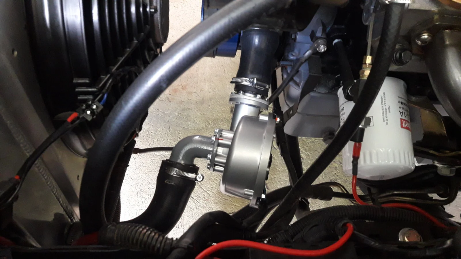

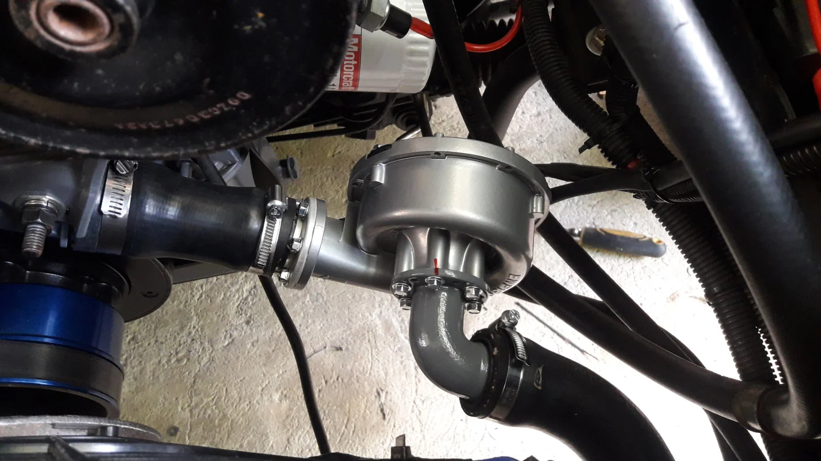

hello ..finally DC 130lt Pump arrived today and is installed.. made all the wireing days befor so i just had to install and connect the pump ..very easy and pump fits just great! no need for extra bracket because its all tight.. just cut the Water hose and get the Pump in ..done.. all runs just fine. pump makes no noise and what you can hear is the water running in the Radiator.. not cheap but very cool !!!

also went for a test drive here in Hot Costa Rica Weather conditions .. first i had a problem with the fan relais and Fan didnt run..so temp was rising.. up to 94 C not much but I had the controller to 85 and warning light went on .. ok..after fixing it and fan starts to run ..it took 60 seconds to cool down from 94 to 82 deg..not bad and during driving temp difference was only 3 deg from hottest to coolest ..always 81 to 84 deg C .. cruising and some standing launches from 0 to 80mph...always very stable temp ... data log line is almost one straight.. maybe today Ill gona try with Nitrous to see what happens...all over.. very happy with that now cooling stuff...
