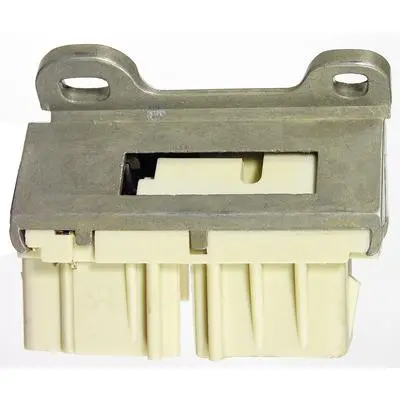

When the radio cut off and the engine quit running was a clue that the ignition switch is going bad.

Some of the symptoms of ignition switch problems are things that don’t work or are intermittent like radio, turn signals, wipers or heater.
There was a FREE recall on Ford ignition switches. They overheat and sometimes catch fire. That burns up the steering column and sometimes the car interior. Since this is very old information, you may not be able to get the switch replaced for free anymore. The auto parts stores sell the switches for $13-$15.
While you are working on the switch, check the wiring and connector closely. A replacement connector with new wiring pigtails is available from most auto parts stores
AutoZone and Advanced Auto Parts have the same Part Number: 434 - may have to order, not always in stock
Advanced Auto Parts alternate part number: PT5534
Saleen0679 was nice enough to dig this up for us awhile back: Replace a 1979-1993 Ignition Switch Assembly
Torx bit set from Advance Auto Parts
Autocraft torx bit set – have small hole in tip for tamper proof screws.
Part No. AC571/W1386 Cost approx. $12 +tax

I agree on looking at the ignition switch and its connector/harness. The radio going out is the thing that makes me think not hecessa it the TFI. When the TFI issue happens, you usually won't be able to start your car back up until it cools down. Feel the TFI after a normal drive? Is it scorching hot to the touch? You can remove it and have it tested at the parts store for free. But the ignition switch is cheap, available online, and installs in about 15 minutes. You can at least take a look at your switch to see if there is any cracking or loose wires.
