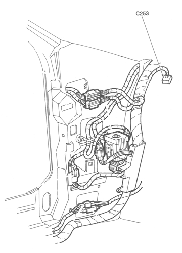

I believe that the door harness plugs in just inside the chassis. No need to splice IF you can get your hands in there to swap the plugs. Here's an image from the Ford manual I have, the two connectors at the top are for the door:

Chythar, thanks a lot for that diagram! That definitely helps! Haha, yes, it may be a little tricky getting in there, but I'll give that a shot tomorrow and we'll see what happens.

It looks like it may take a bit of finagling to get at those harness plugs, but I will update when I do! Thanks a lot for the help so far!

Ok, so I was able to get a finger on those plugs, but that's about it. I was laying on my back, looking up underneath the dash area near the door to see if there was a way to access the plugs from there. What I found was a piece of insulation covering some small access holes, with both plugs right behind that. However, I cannot get more than a finger in there because the interior fuse block is in the way. I tried loosening the two bolts on the bottom side that appeared to be holding it on, but either those weren't it or there are a couple more that I cannot see. Any ideas on removing the fuse block assembly?
