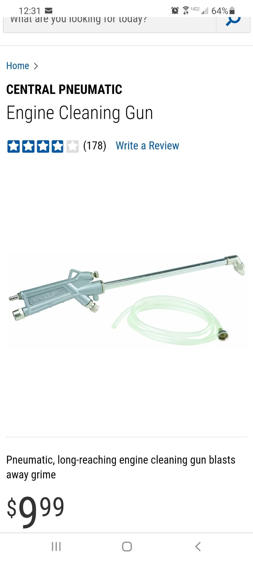

Thanks to you and others for the feedback. The ideas with the paint brushes make sense. Another member suggested getting paint stirring sticks and wrap them with throw-away towels/microfibers for tight spaces. The one thing that I hadn't seen before is the engine cleaning gun.

That nozzle thing is like a little light pressure washer. It'll get stuff out of the crevices and won't harm paint. It will knock off chips of paint on badly spray painted stuff that's already lifting.

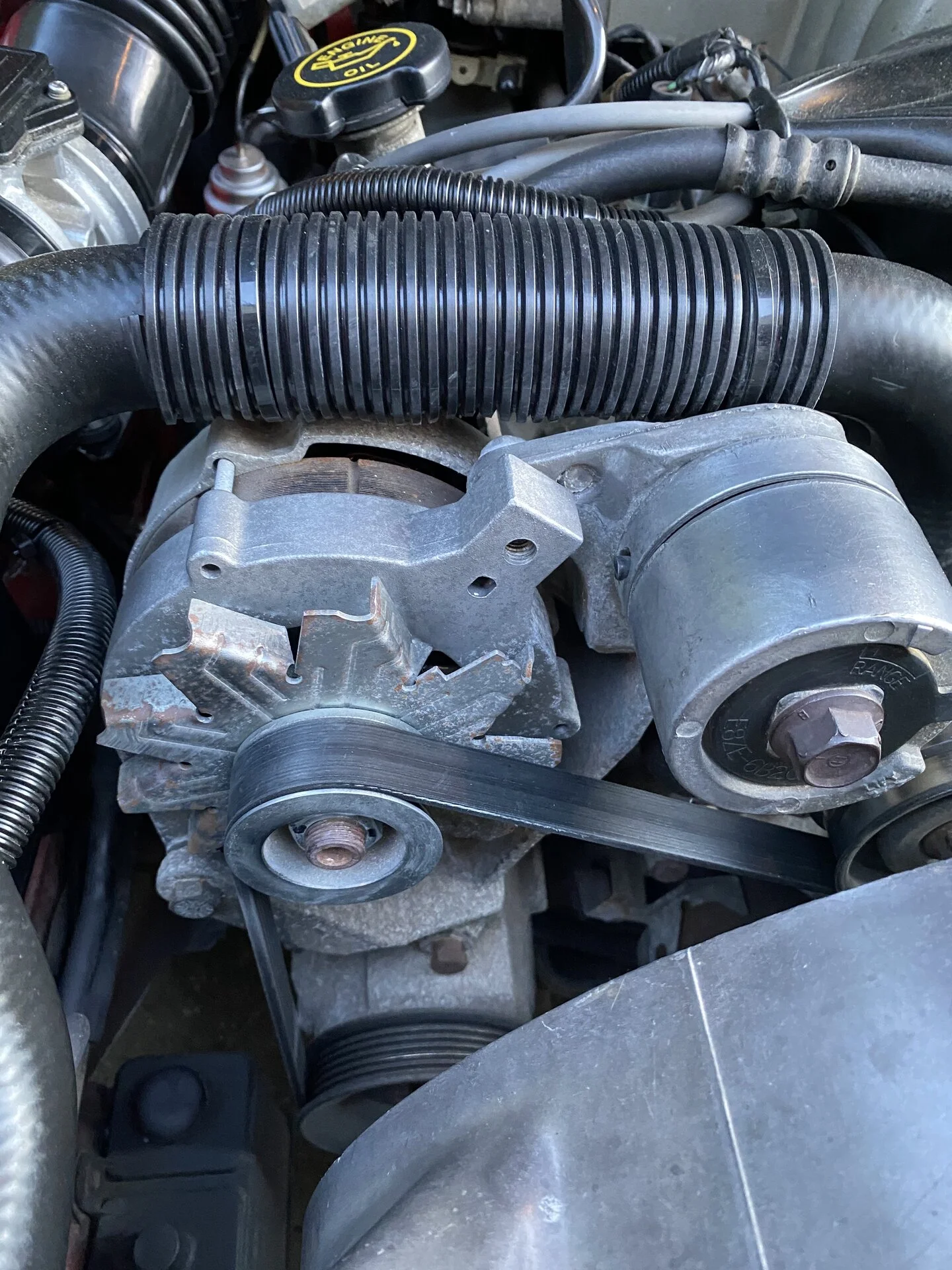

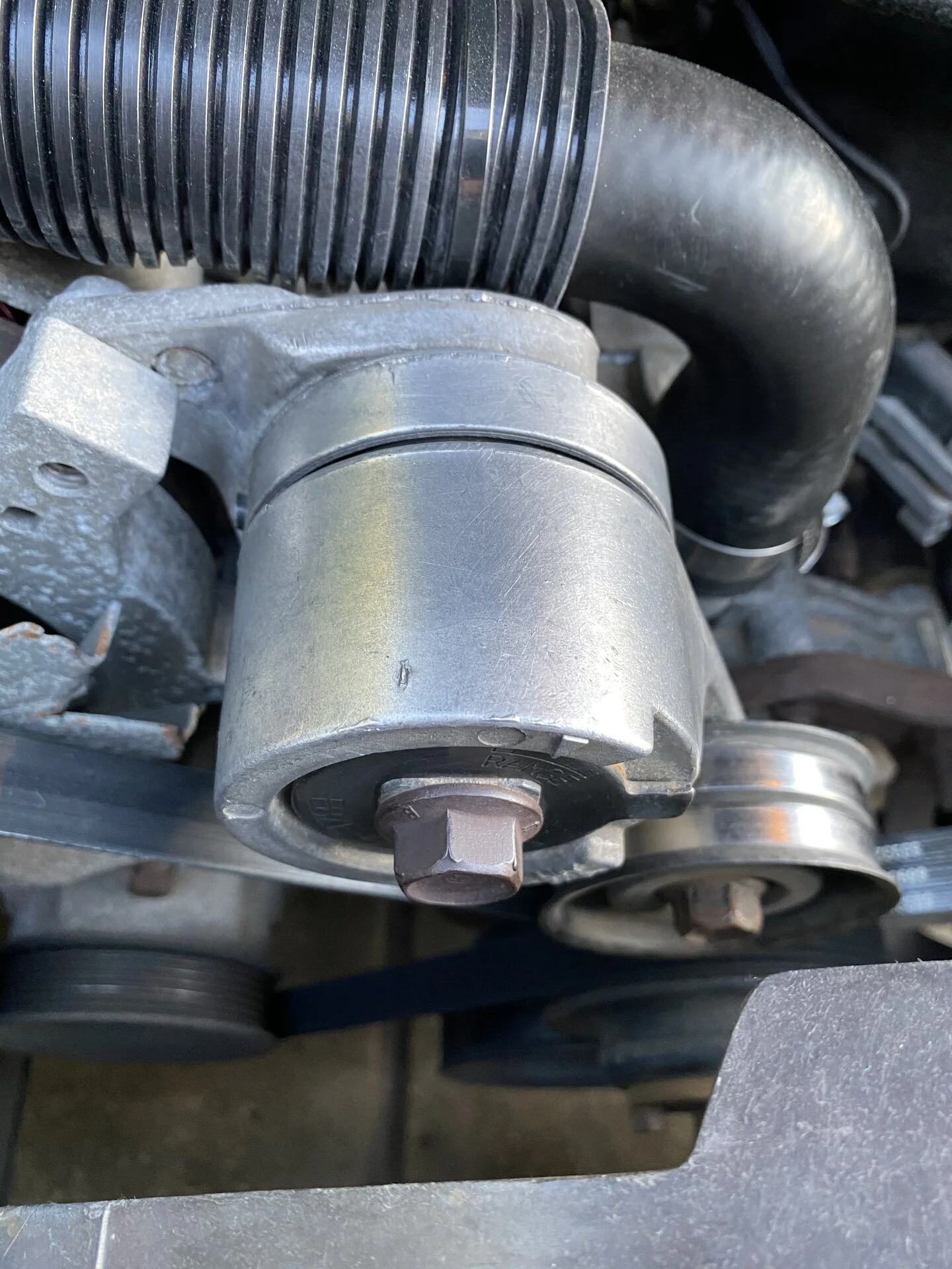

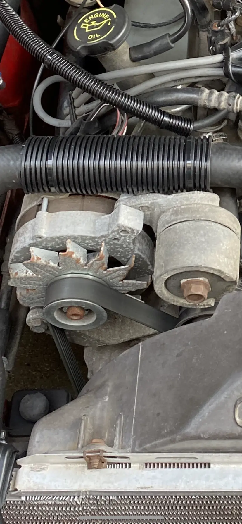

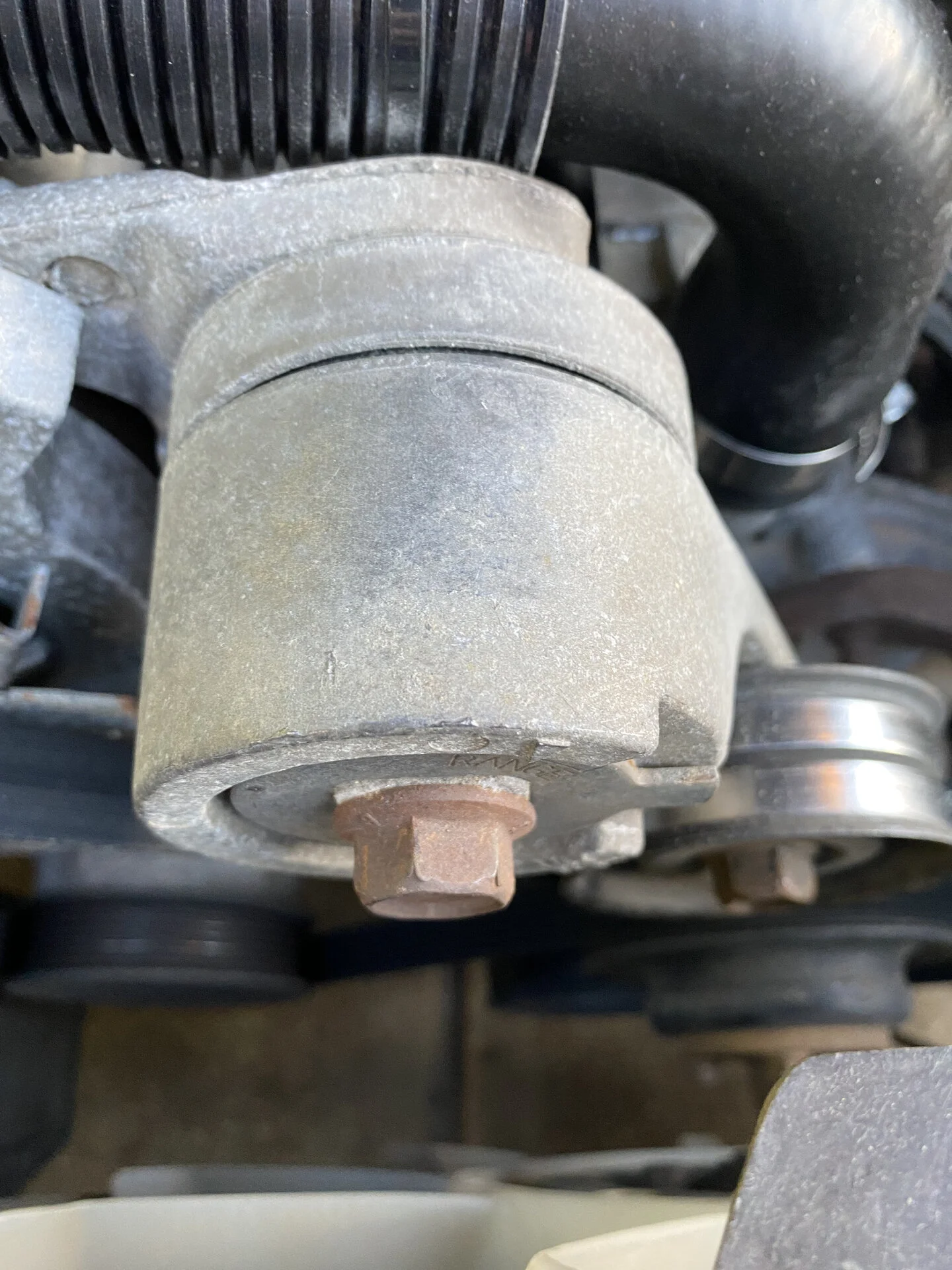

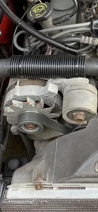

Before and after pics and not even going “all-out”

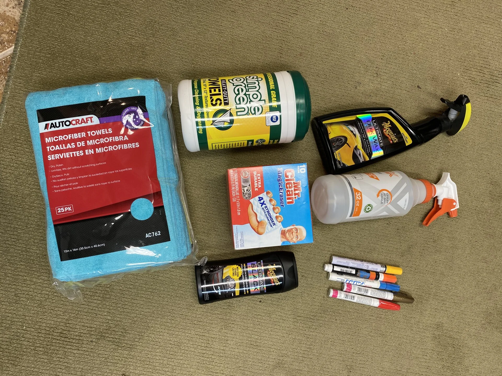

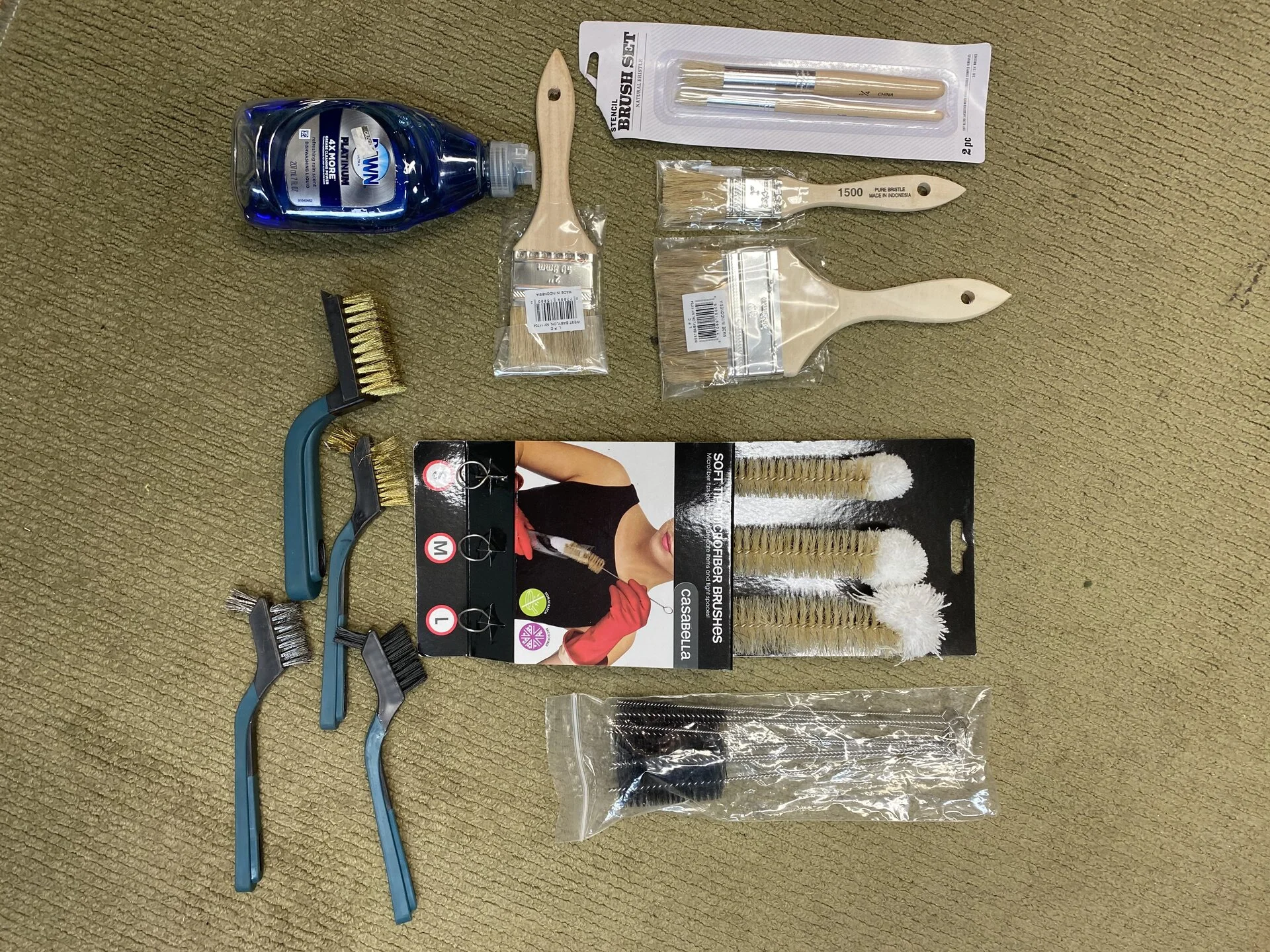

My engine bay cleaning kit consists of spray wax, spray bottle for Dawn solution, color paint pens for detailing, ultimate black rubber hose restorer, micro fiber rags, mr clean pads (awesome), simple green towels, paint brushes of different sizes including artist brushes, pipe cleaners of different sizes with micro fiber on the tips and straight up wire ones, and wire hand scrubbers. Engine paint and others for the wire looms, etc. lots of time and elbow grease but eventually everything comes looking 90% new.

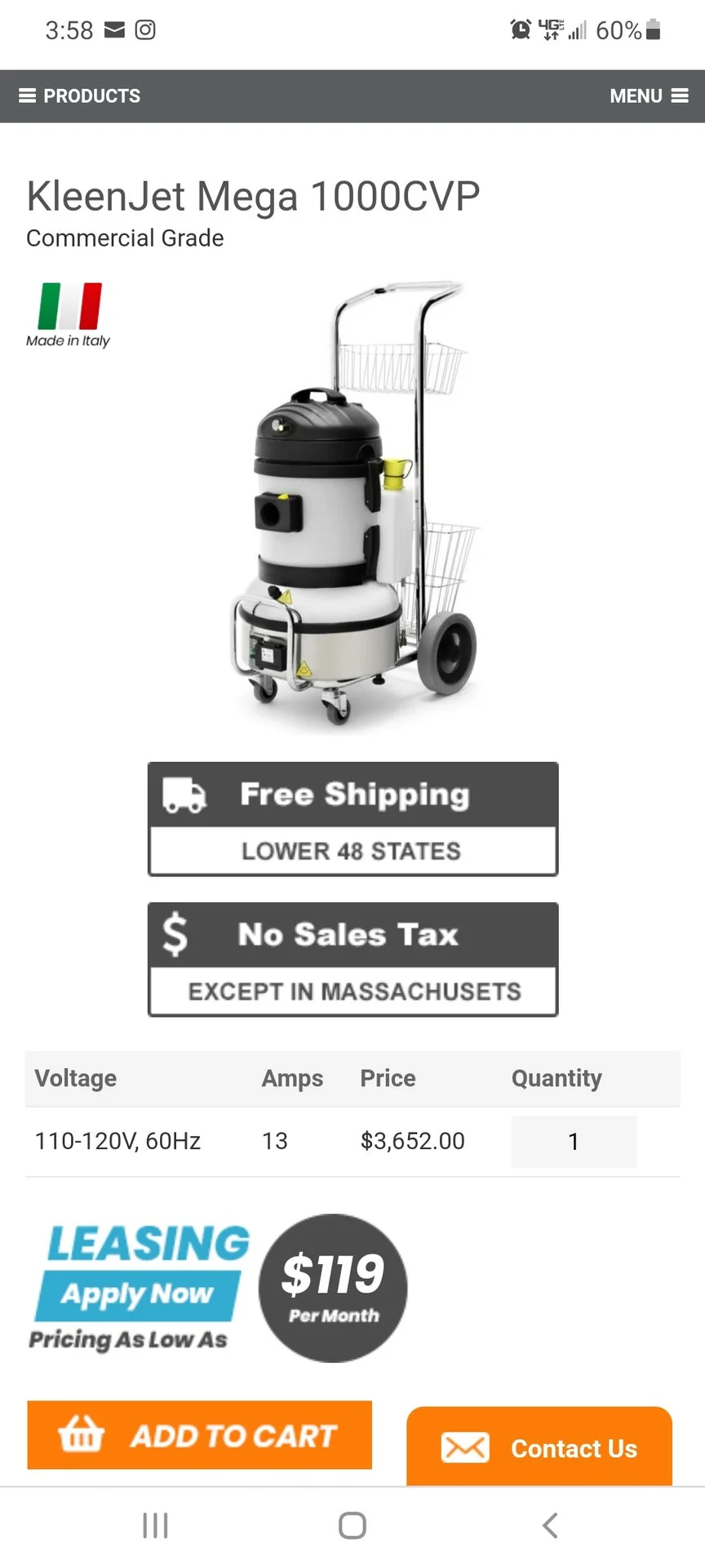

So what model and make of steamer do the OCD and detailers use?
mare they run by a gas engine (like a power washer) or 110v powered?
