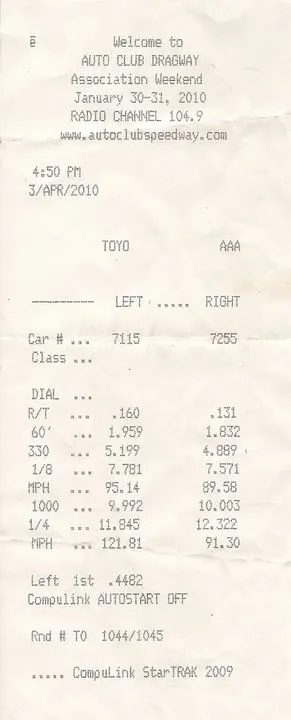

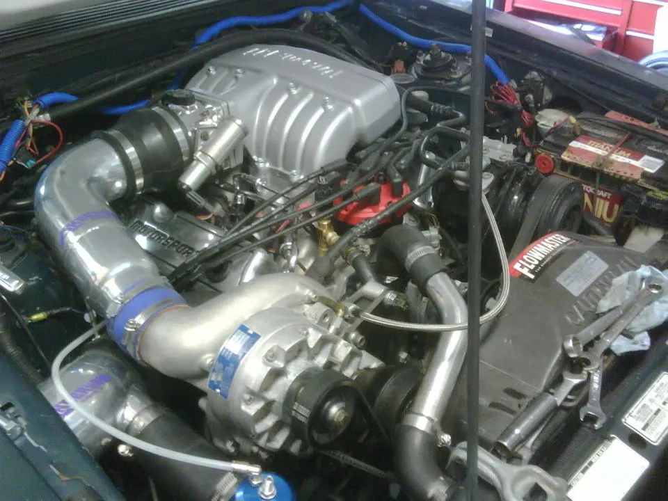

the first time i took my car to the track with an a-trim vortech at only 4psi i ran a 11.84 at 121.81 mph and i have very little suspension work done. this is also with no tune, only me screwing around aimlessly with my pms. as u can see my et and my mph do not match at all. that pass was only a 1.9 60 foot. with some suspension work and nothing else done at that mph id be dipping into the 10's.
now since ive tossed the a-trim and now have a sq-si trim and run it at 6-7psi if i got a good tune id probably be mid 10's with the suspension work as well.
