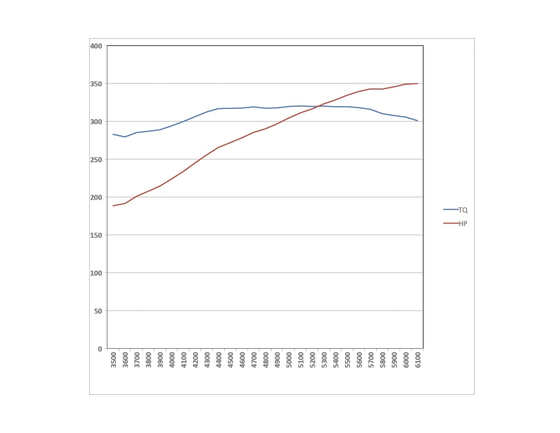

I hate to say it again but you're way to vague. I can tell you what I've got and what it made on the dyno.
289 block bored 30 over
Stock Crank (blanced with the fly wheel and balancer and weights for pistons and rods)
Forged Eagle Rods
HYPEREUTECTICS Pistons
CompCams Extreme Energy 274
Heads are World Windsor Heads (Lots of work done by my bother's friend Joe)
Weiand dual plane intake
Holley 600
Dyno'd at 349.7 (350) HP
Here's a pic of the dyno run, btw this was on a engine dyno.
Edit* sp correction :)
