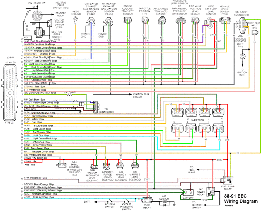

Ok first I know everyone posts these but I'm stumped....
I just installed a completely new engine harnes in my MAF converted 1988. I'm getting the same codes as with the old harness. These codes are with a key on engine off test. The car won't test with the engine on, sputters out and dies with the tester connected.
51
22
53
54
35
67
85
Car runs great, no problems. 92 ECU, with a Ford mass air conversion harness. Thanks for you help.

See the following website for some help from Tmoss
(diagram designer) & Stang&2Birds (website host)
http://www.veryuseful.com/mustang/tech/engine/images/88-91eecPinout.gif

Since you have several codes that involve signals out of
range or too high, I would suspect a defective signal
ground wire. The black/white signal ground wire runs from
pin 46 on the computer to all the sensors listed in the
above code descriptions.
Go back and read the code 35 tech note. It tells you where & how to use an ohmeter to measure the resistance.
The computer wires pin 46 to pins 40 & 60 internally. Sometimes it fries the connection inside the computer. Remove the wiring connector from the computer by loosening the 10 MM bolt until you can pull the connector out of the computer. Use the ohmmeter to measure the resistance between pins 46 and 40 & 60 on the computer. It should be less than 1.5 ohms. If it is a lot more than 1.5 ohms, the copper trace on the computer circuit board has burned up.
