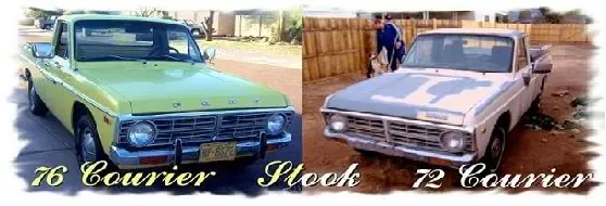

hey all im new here, looking to get a mid 80's carbureted 5.0 mustang to swap the engine and drivetrain into my 72 ford courier... some questions i have on the this is the tranny, are the automatic trannys computer operated or are they jusst a bolt up and go type deal..... and wut about the stanard tranny... does it have a hydraulic clutch or is it just straight linkage???? trying to keep this as simple as possible.. i plan on swapping over the engine, tranny, drive shaft (shortened if i have to), differential, and cooling system.... are these carbureted mustangs complicated or... simple??? my real concern is the tranny. i have access to a 1985 5.0 mustang with a 5 speed that i can get for 1200 bucks... so im considering it for the swap
thx brandon
