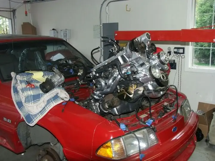

I would suggest doing it with the front accessories off the engine - these are relatively easy to put on with the engine in the car, but can get in the way of the hoist depending on your setup.

Great picture. I have a overhead hoist, so the I don't think it will be an issue.
